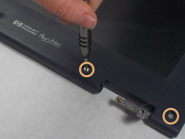

  3. HP Pavilion N3350 Screen Assembly Replacement: crwdns2935265:03crwdnd2935265:01crwdnd2935265:03crwdne2935265:0 HP Pavilion N3350 Screen Assembly Replacement: crwdns2935265:03crwdnd2935265:02crwdnd2935265:03crwdne2935265:0 HP Pavilion N3350 Screen Assembly Replacement: crwdns2935265:03crwdnd2935265:03crwdnd2935265:03crwdne2935265:0
    • Remove the 1 cm screw with a Phillips #1 screwdriver to allow the screen and top of the laptop to be separated from the keyboard and bottom.
    • Lift the entire top away from the bottom, and set bottom half of the laptop aside.

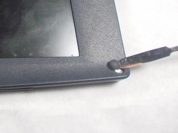

  4. HP Pavilion N3350 Screen Assembly Replacement: crwdns2935265:04crwdnd2935265:01crwdnd2935265:03crwdne2935265:0 HP Pavilion N3350 Screen Assembly Replacement: crwdns2935265:04crwdnd2935265:02crwdnd2935265:03crwdne2935265:0 HP Pavilion N3350 Screen Assembly Replacement: crwdns2935265:04crwdnd2935265:03crwdnd2935265:03crwdne2935265:0
    • Remove the 6 rubber screw caps with a metal spudger.
    • After removing the 6 rubber screw caps, use a Phillips #1 screwdriver to unscrew the six 6mm screws.

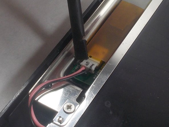

  5. HP Pavilion N3350 Screen Assembly Replacement: crwdns2935265:05crwdnd2935265:01crwdnd2935265:02crwdne2935265:0 HP Pavilion N3350 Screen Assembly Replacement: crwdns2935265:05crwdnd2935265:02crwdnd2935265:02crwdne2935265:0
    • To separate the plastic cover, use a plastic opening tool to undo each plastic connecting clip between the two.
    • You can find the plastic connecting clips by sliding the plastic opening tool along the seam between the two plastic covers.
    • Remove the top plastic cover once all connections have been released.

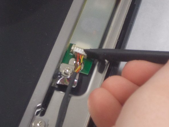

  6. HP Pavilion N3350 Screen Assembly Replacement: crwdns2935265:06crwdnd2935265:01crwdnd2935265:03crwdne2935265:0 HP Pavilion N3350 Screen Assembly Replacement: crwdns2935265:06crwdnd2935265:02crwdnd2935265:03crwdne2935265:0 HP Pavilion N3350 Screen Assembly Replacement: crwdns2935265:06crwdnd2935265:03crwdnd2935265:03crwdne2935265:0
    • Disconnect the connectors using a plastic opening tool.
    • Once these two connectors are released, the screen should be electronically freed from the rest of the laptop.

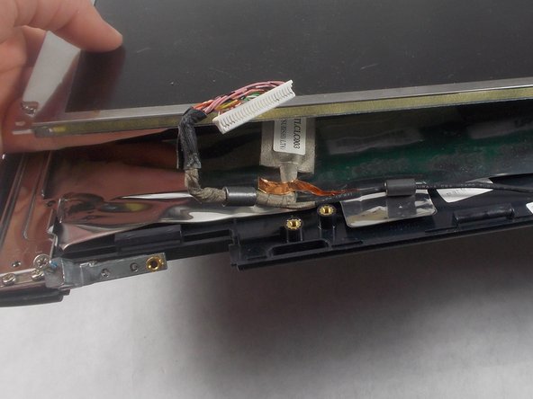

  7. HP Pavilion N3350 Screen Assembly Replacement: crwdns2935265:07crwdnd2935265:01crwdnd2935265:01crwdne2935265:0
    • At each corner, there is a 1 centimeter silver screw connecting the screen frame to the laptop. Remove these using a Phillips #1 Screwdriver.

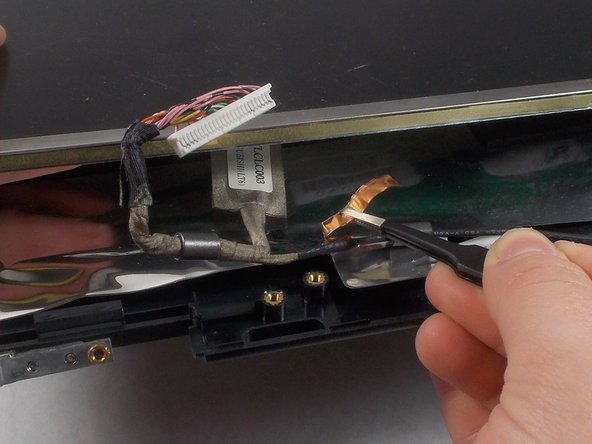

  8. HP Pavilion N3350 Screen Assembly Replacement: crwdns2935265:08crwdnd2935265:01crwdnd2935265:03crwdne2935265:0 HP Pavilion N3350 Screen Assembly Replacement: crwdns2935265:08crwdnd2935265:02crwdnd2935265:03crwdne2935265:0 HP Pavilion N3350 Screen Assembly Replacement: crwdns2935265:08crwdnd2935265:03crwdnd2935265:03crwdne2935265:0
    • There should be thin piece of copper 'tape' holding the LCD cable down. Remove this gently with tweezers.
    • Remove the screen from the device.
