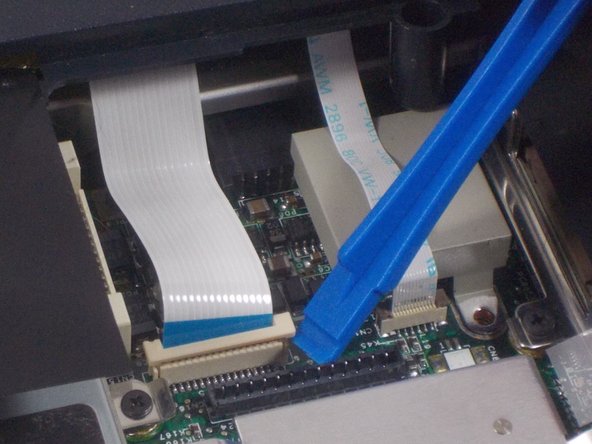

    • Disconnect the green ribbon cable using a plastic opening tool.

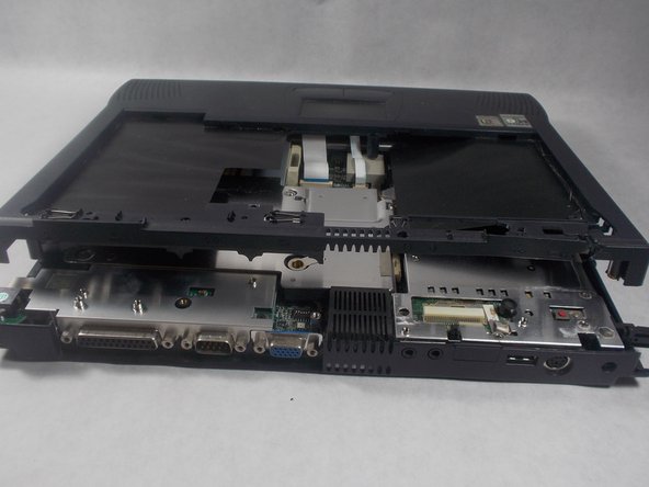

    • Remove the 6 millimeter screws indicated with a Phillips #1 screwdriver.
    • Remove the top plastic covering from the base of the device.

    • Use a plastic opening tool to disconnect both cable connectors gently.

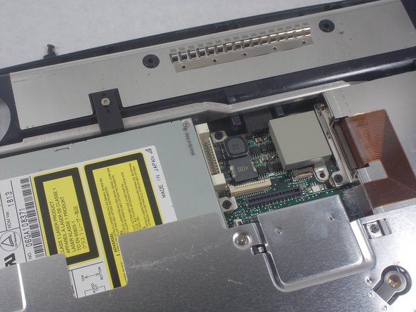

    • Once these cables are disconnected, the optical drives can be found inside.
    • This particular laptop has a CD/DVD combo drive on the left, and a floppy disc drive on the right.
  7. HP Pavilion N3350 Optical Drive Replacement: crwdns2935265:07crwdnd2935265:01crwdnd2935265:02crwdne2935265:0 HP Pavilion N3350 Optical Drive Replacement: crwdns2935265:07crwdnd2935265:02crwdnd2935265:02crwdne2935265:0

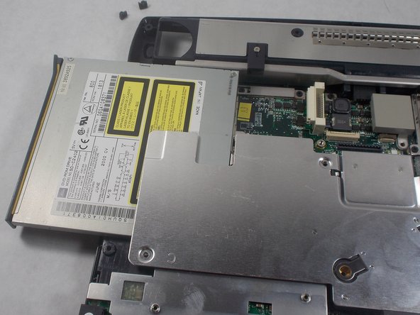

    • The 1 centimeter screws indicated need to be removed using a Phillips #1 screwdriver to free the CD/DVD combo drive.
    • Once freed, the CD/DVD combo drive should slide out and remove easily.

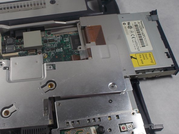

    • The 1 centimeter screws indicated must be removed with a Phillips #1 screwdriver to free the floppy disc drive.
    • Remove the floppy disc drive from the device.
