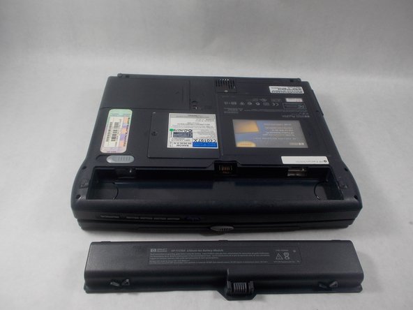

    • Flip the laptop over and locate the grey finger latch.
  2. HP Pavilion N3350 Hard Drive Replacement: crwdns2935265:02crwdnd2935265:01crwdnd2935265:01crwdne2935265:0
    • Slide the finger latch to the left to release the clip holding the battery into the laptop.
  3. HP Pavilion N3350 Hard Drive Replacement: crwdns2935265:03crwdnd2935265:01crwdnd2935265:02crwdne2935265:0 HP Pavilion N3350 Hard Drive Replacement: crwdns2935265:03crwdnd2935265:02crwdnd2935265:02crwdne2935265:0
    • While continuing to hold the finger latch, slowly lift up on the tab to remove the battery from the device.
  4. HP Pavilion N3350 Hard Drive Replacement, Hard Drive: crwdns2935265:04crwdnd2935265:01crwdnd2935265:01crwdne2935265:0
    • To unlock the hard drive, use a spudger to slide the button aside.
  5. HP Pavilion N3350 Hard Drive Replacement: crwdns2935265:05crwdnd2935265:01crwdnd2935265:01crwdne2935265:0
    • Once the button is unlocked to the side, slide the hard drive enclosure away from the device.
  6. HP Pavilion N3350 Hard Drive Replacement: crwdns2935265:06crwdnd2935265:01crwdnd2935265:01crwdne2935265:0
    • The hard drive will be clipped into the underside of the hard drive enclosure and can be removed for replacement.
