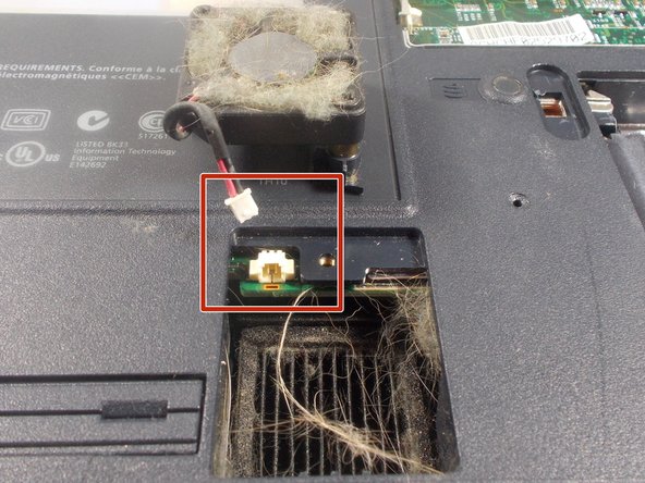

    • Locate the fan on the underside of the laptop.
  2. HP Pavilion N3350 Fan Replacement: crwdns2935265:02crwdnd2935265:01crwdnd2935265:01crwdne2935265:0
    • Using a Phillips #1 screwdriver, remove the 4.5 mm screw securing the fan cover to the device.
  3. HP Pavilion N3350 Fan Replacement: crwdns2935265:03crwdnd2935265:01crwdnd2935265:01crwdne2935265:0
    • Use a plastic spudger tool to free the cover.
    • The fan cover is extremely fragile and easy to break. Use caution during this step.
  4. HP Pavilion N3350 Fan Replacement: crwdns2935265:04crwdnd2935265:01crwdnd2935265:03crwdne2935265:0 HP Pavilion N3350 Fan Replacement: crwdns2935265:04crwdnd2935265:02crwdnd2935265:03crwdne2935265:0 HP Pavilion N3350 Fan Replacement: crwdns2935265:04crwdnd2935265:03crwdnd2935265:03crwdne2935265:0

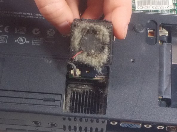

    • Lift the fan up from the device.
    • If you're cleaning the fan, stop at this step, and remove any build up. This can be done with tweezers and canned air.
    • Disconnect the fan cable to fully remove the fan from the device.
