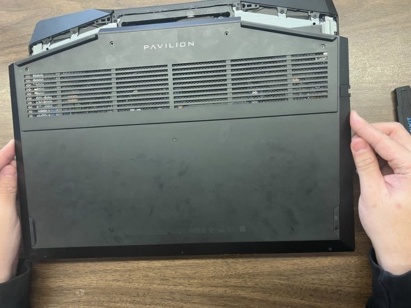

  3. HP Pavilion Gaming Laptop 15-dk2xxx RAM Replacement: crwdns2935265:03crwdnd2935265:01crwdnd2935265:03crwdne2935265:0 HP Pavilion Gaming Laptop 15-dk2xxx RAM Replacement: crwdns2935265:03crwdnd2935265:02crwdnd2935265:03crwdne2935265:0 HP Pavilion Gaming Laptop 15-dk2xxx RAM Replacement: crwdns2935265:03crwdnd2935265:03crwdnd2935265:03crwdne2935265:0
    • Insert the metal opening tool into the space between the lower case and the chassis.
    • Slide the opening tool around the perimeter of the case to release the clips holding the case.
    • Remove the back case.
    • When removing the back plate, use caution, removing slowly in order to not break the clips.

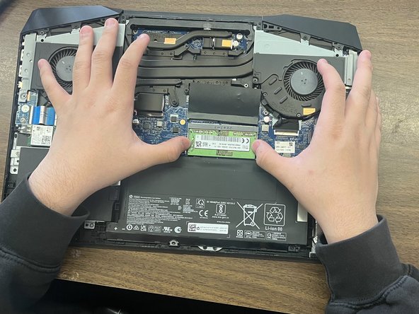

  4. HP Pavilion Gaming Laptop 15-dk2xxx RAM Replacement: crwdns2935265:04crwdnd2935265:01crwdnd2935265:03crwdne2935265:0 HP Pavilion Gaming Laptop 15-dk2xxx RAM Replacement: crwdns2935265:04crwdnd2935265:02crwdnd2935265:03crwdne2935265:0 HP Pavilion Gaming Laptop 15-dk2xxx RAM Replacement: crwdns2935265:04crwdnd2935265:03crwdnd2935265:03crwdne2935265:0
    • Using your fingers, pull the metal arms (located on both sides of the RAM stick) slightly away from it.
    • With your fingers, push on the Ram stick until the metal arms are not holding the stick.
    • The RAM will pop up by a few millimeters up.
    • Remove it by pulling straight towards you and not a angle so you don't damage the socket.

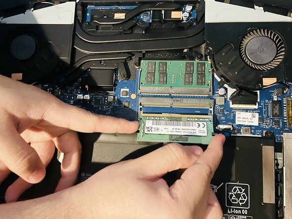

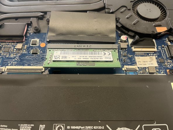

  5. HP Pavilion Gaming Laptop 15-dk2xxx RAM Replacement: crwdns2935265:05crwdnd2935265:01crwdnd2935265:02crwdne2935265:0 HP Pavilion Gaming Laptop 15-dk2xxx RAM Replacement: crwdns2935265:05crwdnd2935265:02crwdnd2935265:02crwdne2935265:0
    • Slide the RAM stick out from the memory module slot.
    • Repeat for the RAM stick located below. This computer had RAM in the slot below.
