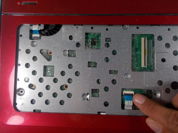

  9. HP Pavilion G7-2289wm Fan and Heat Sink Replacement, Fan and Heat Sink: crwdns2935265:09crwdnd2935265:01crwdnd2935265:01crwdne2935265:0
    • Remove the three screws that hold the keyboard palm rest in place using a Phillips #0 screwdriver.
    • Lift the palm rest up and out.
  10. HP Pavilion G7-2289wm Fan and Heat Sink Replacement: crwdns2935265:010crwdnd2935265:01crwdnd2935265:03crwdne2935265:0 HP Pavilion G7-2289wm Fan and Heat Sink Replacement: crwdns2935265:010crwdnd2935265:02crwdnd2935265:03crwdne2935265:0 HP Pavilion G7-2289wm Fan and Heat Sink Replacement: crwdns2935265:010crwdnd2935265:03crwdnd2935265:03crwdne2935265:0

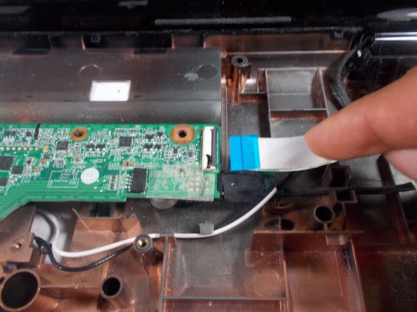

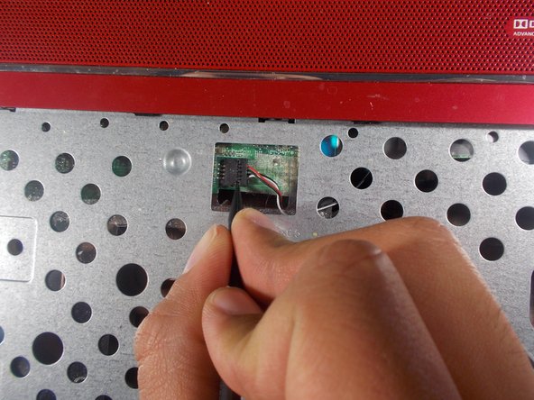

    • Remove the wires attached under the keyboard.
  11. HP Pavilion G7-2289wm Fan and Heat Sink Replacement: crwdns2935265:011crwdnd2935265:01crwdnd2935265:01crwdne2935265:0
    • Pry open the bottom of the laptop by using the opening tool to open it up. Do this around the entire outer edge of the laptop.

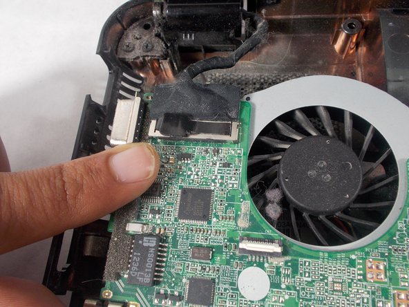

    • Remove the screw that holds the motherboard in place.
    • Remove the wires attached to the motherboard.
    • Unplug the laptop fan.
  13. HP Pavilion G7-2289wm Fan and Heat Sink Replacement: crwdns2935265:013crwdnd2935265:01crwdnd2935265:01crwdne2935265:0
    • Remove the four screws that hold the fan and heat sink in place.
    • Remove the entire heat sink from the laptop.
