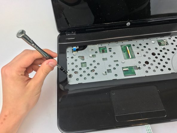

  3. HP Pavilion G7-2235DX Screen Replacement: crwdns2935265:03crwdnd2935265:01crwdnd2935265:02crwdne2935265:0 HP Pavilion G7-2235DX Screen Replacement: crwdns2935265:03crwdnd2935265:02crwdnd2935265:02crwdne2935265:0
    • Remove the four 7.25mm screws located by the red markers.

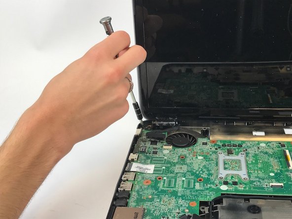

  6. HP Pavilion G7-2235DX Screen Replacement, Screen: crwdns2935265:06crwdnd2935265:01crwdnd2935265:01crwdne2935265:0
    • To remove the laptop's screen, you will have to remove a total of four 7.25mm screws.
    • First, remove the two 7.25mm screws found in the upper right corner as shown.

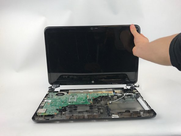

  8. HP Pavilion G7-2235DX Screen Replacement: crwdns2935265:08crwdnd2935265:01crwdnd2935265:02crwdne2935265:0 HP Pavilion G7-2235DX Screen Replacement: crwdns2935265:08crwdnd2935265:02crwdnd2935265:02crwdne2935265:0
    • Once all of the screws have been removed, gently lift the laptop's screen from the base of the computer.
