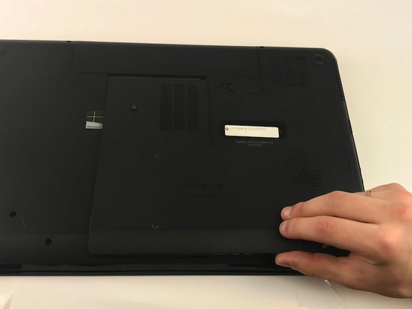

    • Loosen the 7.25mm screw on the bottom of the laptop holding the "L" shaped cover down.
  4. HP Pavilion G7-2235DX RAM Replacement: crwdns2935265:04crwdnd2935265:01crwdnd2935265:02crwdne2935265:0 HP Pavilion G7-2235DX RAM Replacement: crwdns2935265:04crwdnd2935265:02crwdnd2935265:02crwdne2935265:0
    • Slide the cover towards you, then pull up to remove it.
