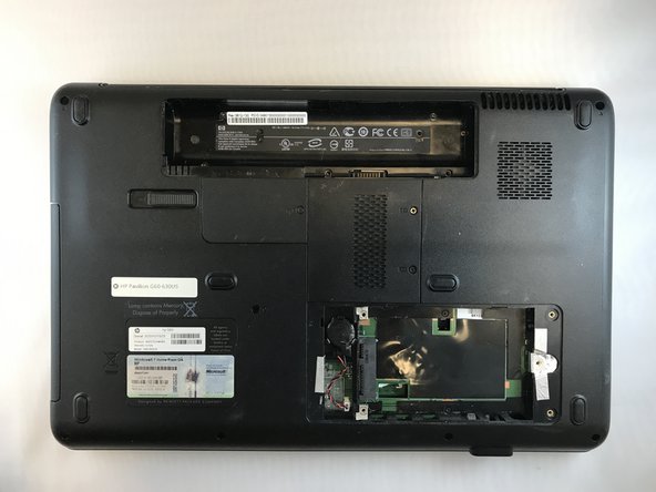

    • Make sure the laptop is powered off and unplugged first.
    • Turn your laptop over so the bottom is facing up.
    • Locate the battery latch and slide the latch switch all the way to the left.
    • The latch will lock and stay in place.
  2. HP Pavilion G60-630US Hard Drive Replacement: crwdns2935265:02crwdnd2935265:01crwdnd2935265:03crwdne2935265:0 HP Pavilion G60-630US Hard Drive Replacement: crwdns2935265:02crwdnd2935265:02crwdnd2935265:03crwdne2935265:0 HP Pavilion G60-630US Hard Drive Replacement: crwdns2935265:02crwdnd2935265:03crwdnd2935265:03crwdne2935265:0
    • Carefully lift the battery out and away from the laptop.
  3. HP Pavilion G60-630US Hard Drive Replacement, Hard Drive: crwdns2935265:03crwdnd2935265:01crwdnd2935265:01crwdne2935265:0
    • Remove the two 5.5 mm JIS#0 screws from the hard drive cover.
    • Remove cover from the back of the laptop.
  4. HP Pavilion G60-630US Hard Drive Replacement: crwdns2935265:04crwdnd2935265:01crwdnd2935265:01crwdne2935265:0
    • Remove three 5.5 mm JIS#0 screws.
  5. HP Pavilion G60-630US Hard Drive Replacement: crwdns2935265:05crwdnd2935265:01crwdnd2935265:01crwdne2935265:0

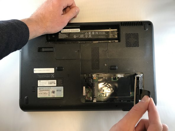

    • Gently, slide the whole hard drive to the right with your fingers.
  6. HP Pavilion G60-630US Hard Drive Replacement: crwdns2935265:06crwdnd2935265:01crwdnd2935265:03crwdne2935265:0 HP Pavilion G60-630US Hard Drive Replacement: crwdns2935265:06crwdnd2935265:02crwdnd2935265:03crwdne2935265:0 HP Pavilion G60-630US Hard Drive Replacement: crwdns2935265:06crwdnd2935265:03crwdnd2935265:03crwdne2935265:0
    • Lift up on black tap attached to the hard drive to remove the hard drive.
