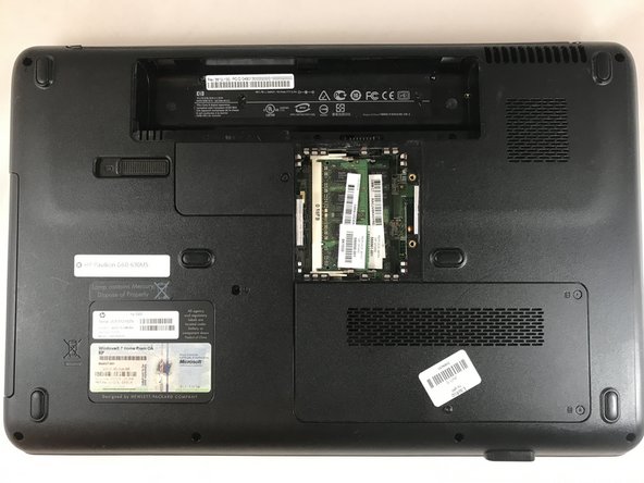

    • Make sure the laptop is powered off and unplugged first.
    • Turn your laptop over so the bottom is facing up.
    • Locate the battery latch and slide the latch switch all the way to the left.
    • The latch will lock and stay in place.
  2. HP Pavilion G60-630US  RAM Replacement: crwdns2935265:02crwdnd2935265:01crwdnd2935265:03crwdne2935265:0 HP Pavilion G60-630US  RAM Replacement: crwdns2935265:02crwdnd2935265:02crwdnd2935265:03crwdne2935265:0 HP Pavilion G60-630US  RAM Replacement: crwdns2935265:02crwdnd2935265:03crwdnd2935265:03crwdne2935265:0
    • Carefully lift the battery out and away from the laptop.

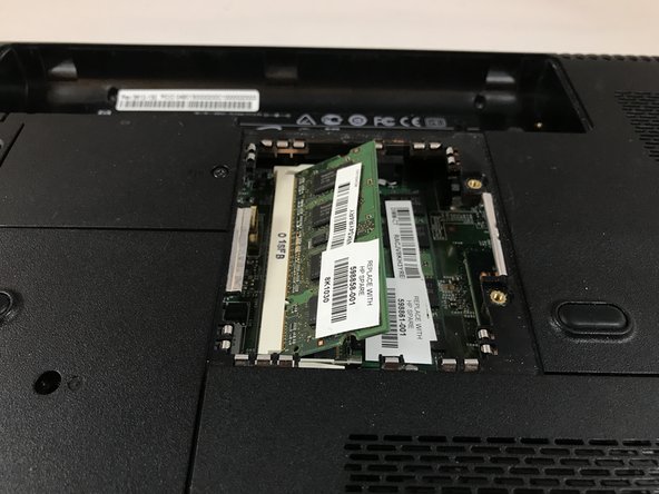

  3. HP Pavilion G60-630US  RAM Replacement, RAM: crwdns2935265:03crwdnd2935265:01crwdnd2935265:02crwdne2935265:0 HP Pavilion G60-630US  RAM Replacement, RAM: crwdns2935265:03crwdnd2935265:02crwdnd2935265:02crwdne2935265:0
    • Remove the two 5.5 mm JIS#0 screws.
    • Lift the panel up and off the computer.
  4. HP Pavilion G60-630US  RAM Replacement: crwdns2935265:04crwdnd2935265:01crwdnd2935265:03crwdne2935265:0 HP Pavilion G60-630US  RAM Replacement: crwdns2935265:04crwdnd2935265:02crwdnd2935265:03crwdne2935265:0 HP Pavilion G60-630US  RAM Replacement: crwdns2935265:04crwdnd2935265:03crwdnd2935265:03crwdne2935265:0

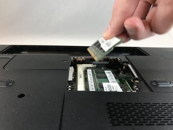

    • Once the panel is removed the RAM card will be visible.
    • The RAM is inserted into its socket with some metal triggers. To remove the RAM card, push the triggers away from the RAM card.
    • If done right, the card will be at an upward angle pointing out of the device.
    • Gently grasp the RAM card ,and pull it out.
To insert a new RAM card, put the card into the slot and press down till the metal triggers click over it, holding it in place. After that, follow steps 1 to 3 in reverse order.
