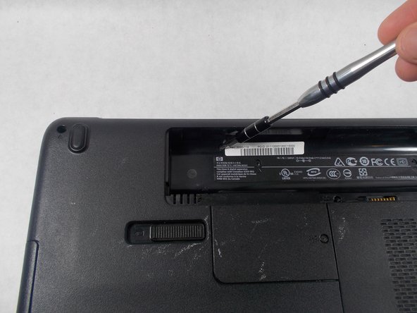

  3. HP Pavilion G60-247CL Screen Replacement: crwdns2935265:03crwdnd2935265:01crwdnd2935265:02crwdne2935265:0 HP Pavilion G60-247CL Screen Replacement: crwdns2935265:03crwdnd2935265:02crwdnd2935265:02crwdne2935265:0
    • Remove the seven Phillips #0 screws from the battery compartment.

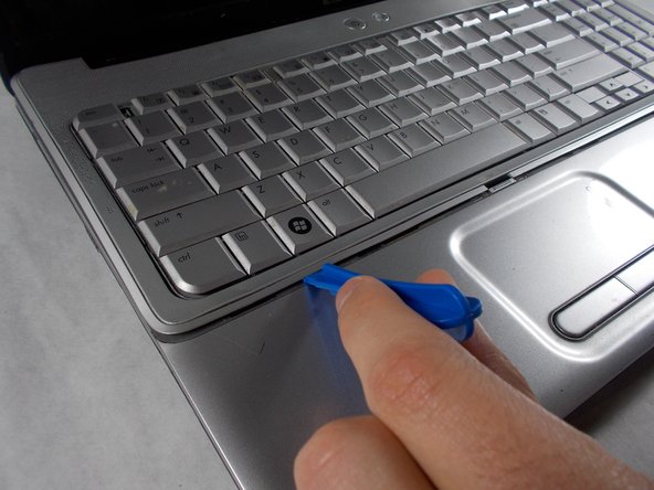

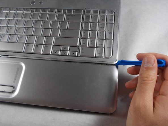

    • Turn the computer around to the front side.
    • Using an opening tool, prop open the keyboard casing.

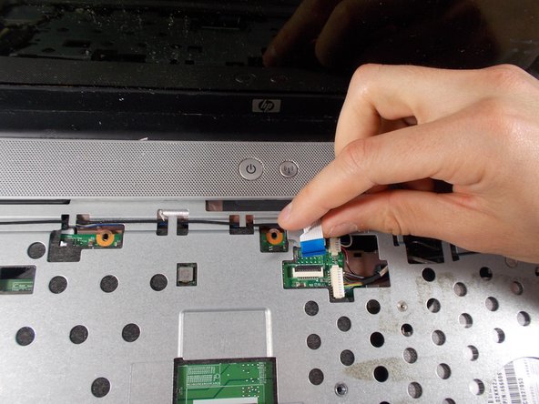

  5. HP Pavilion G60-247CL Screen Replacement: crwdns2935265:05crwdnd2935265:01crwdnd2935265:03crwdne2935265:0 HP Pavilion G60-247CL Screen Replacement: crwdns2935265:05crwdnd2935265:02crwdnd2935265:03crwdne2935265:0 HP Pavilion G60-247CL Screen Replacement: crwdns2935265:05crwdnd2935265:03crwdnd2935265:03crwdne2935265:0

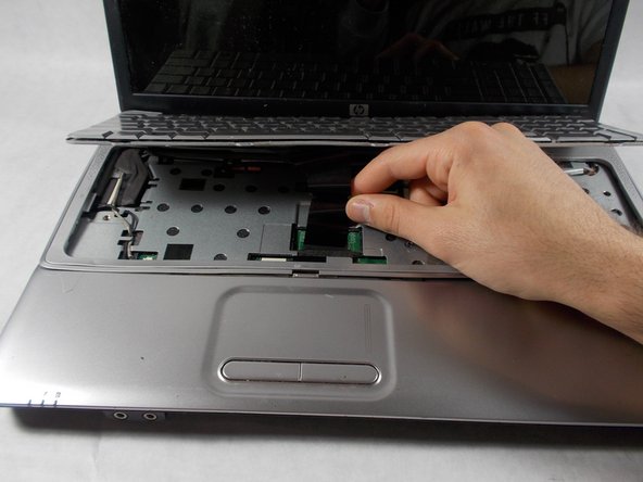

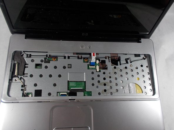

    • Carefully lift up the keyboard.
    • Gently pull up the connecting wire clip (located in the middle) to completely detach the keyboard.
  6. HP Pavilion G60-247CL Screen Replacement: crwdns2935265:06crwdnd2935265:01crwdnd2935265:03crwdne2935265:0 HP Pavilion G60-247CL Screen Replacement: crwdns2935265:06crwdnd2935265:02crwdnd2935265:03crwdne2935265:0 HP Pavilion G60-247CL Screen Replacement: crwdns2935265:06crwdnd2935265:03crwdnd2935265:03crwdne2935265:0

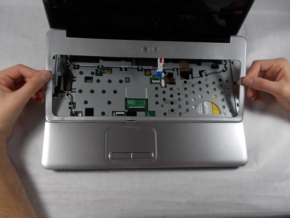

    • At the top right of the laptop there will be another wire clip holding the keyboard casing.
    • Carefully pull out the wire clip to fully detach the covering.

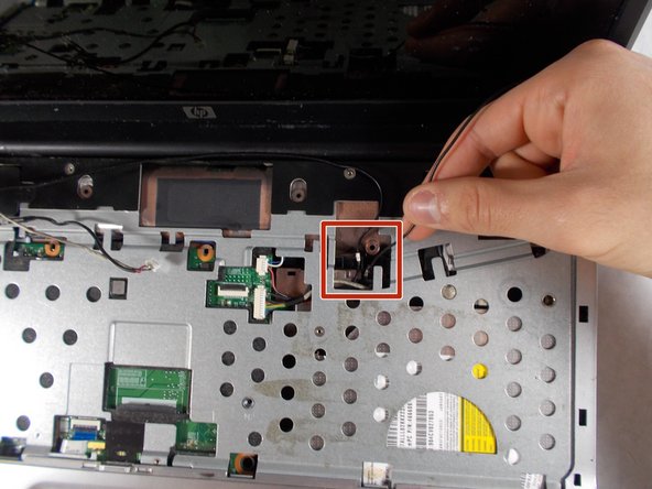

  7. HP Pavilion G60-247CL Screen Replacement: crwdns2935265:07crwdnd2935265:01crwdnd2935265:02crwdne2935265:0 HP Pavilion G60-247CL Screen Replacement: crwdns2935265:07crwdnd2935265:02crwdnd2935265:02crwdne2935265:0

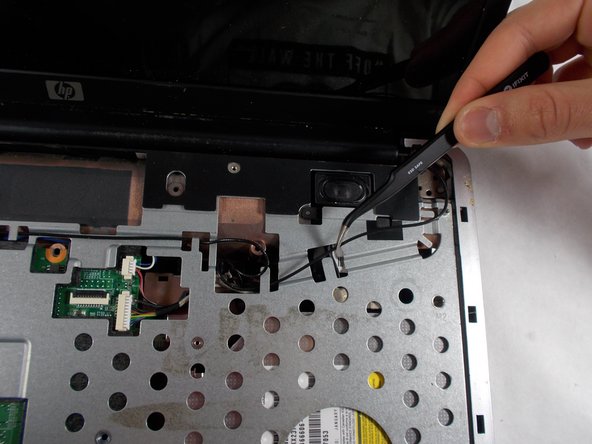

    • At the top right of the laptop remove the black wire from under the metal tabs using the tweezers.
  8. HP Pavilion G60-247CL Screen Replacement: crwdns2935265:08crwdnd2935265:01crwdnd2935265:02crwdne2935265:0 HP Pavilion G60-247CL Screen Replacement: crwdns2935265:08crwdnd2935265:02crwdnd2935265:02crwdne2935265:0
    • Remove the black wire from the top right corner by gently pulling outward.

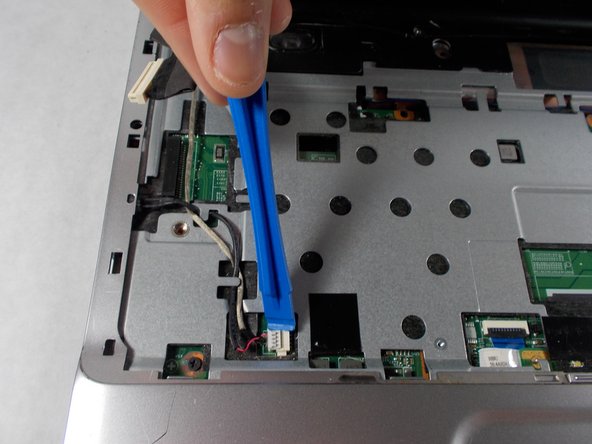

  10. HP Pavilion G60-247CL Screen Replacement: crwdns2935265:010crwdnd2935265:01crwdnd2935265:03crwdne2935265:0 HP Pavilion G60-247CL Screen Replacement: crwdns2935265:010crwdnd2935265:02crwdnd2935265:03crwdne2935265:0 HP Pavilion G60-247CL Screen Replacement: crwdns2935265:010crwdnd2935265:03crwdnd2935265:03crwdne2935265:0
    • Locate at the bottom left of the computer a white clip.
    • Using an opening tool, prop out the white clip.

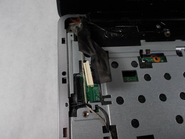

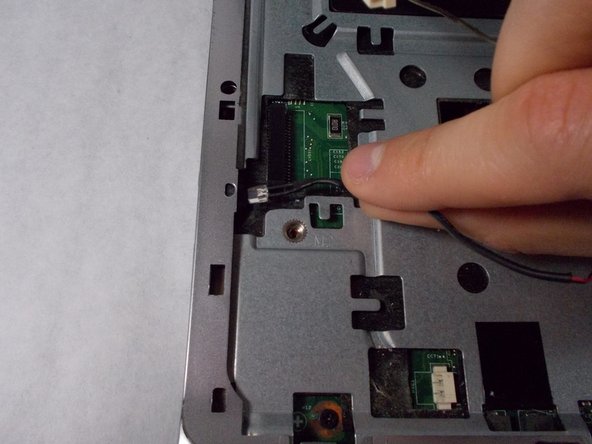

  11. HP Pavilion G60-247CL Screen Replacement: crwdns2935265:011crwdnd2935265:01crwdnd2935265:02crwdne2935265:0 HP Pavilion G60-247CL Screen Replacement: crwdns2935265:011crwdnd2935265:02crwdnd2935265:02crwdne2935265:0

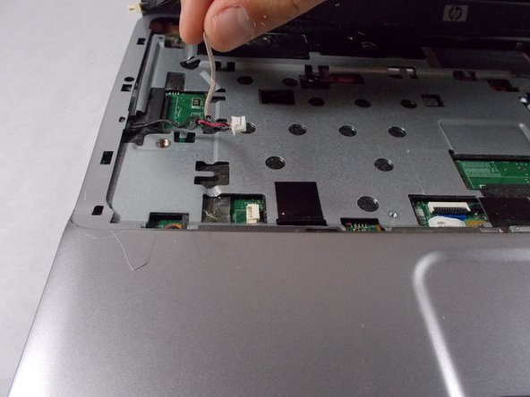

    • On the left side of the computer locate the black wire with the clear clip.
    • Gently pull the wire to the right to detach it.

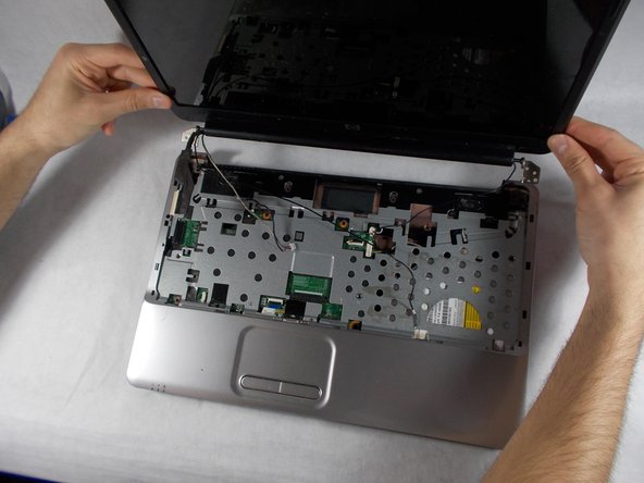

    • At the top corners of the computer, unscrew the three Phillips #0 screws.
    • Lift up the top half of the computer carefully.

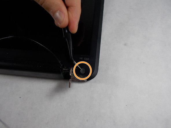

  13. HP Pavilion G60-247CL Screen Replacement: crwdns2935265:013crwdnd2935265:01crwdnd2935265:03crwdne2935265:0 HP Pavilion G60-247CL Screen Replacement: crwdns2935265:013crwdnd2935265:02crwdnd2935265:03crwdne2935265:0 HP Pavilion G60-247CL Screen Replacement: crwdns2935265:013crwdnd2935265:03crwdnd2935265:03crwdne2935265:0

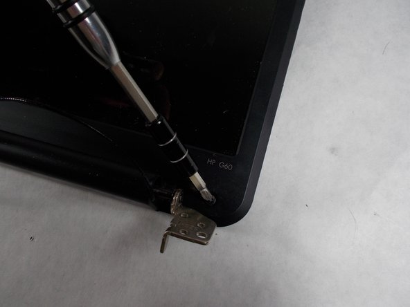

    • Locate the two screws at the bottom corners of the screen.
    • Using the tweezers remove the rubber black covering over the screw.
    • Remove the two Phillips #0 screws.

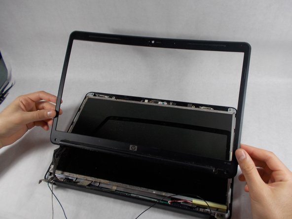

  14. HP Pavilion G60-247CL Screen Replacement: crwdns2935265:014crwdnd2935265:01crwdnd2935265:03crwdne2935265:0 HP Pavilion G60-247CL Screen Replacement: crwdns2935265:014crwdnd2935265:02crwdnd2935265:03crwdne2935265:0 HP Pavilion G60-247CL Screen Replacement: crwdns2935265:014crwdnd2935265:03crwdnd2935265:03crwdne2935265:0

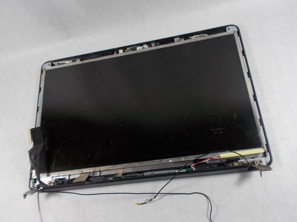

    • Using the opening tool, prop off the screen covering.
    • Remove the covering to expose the screen completely.

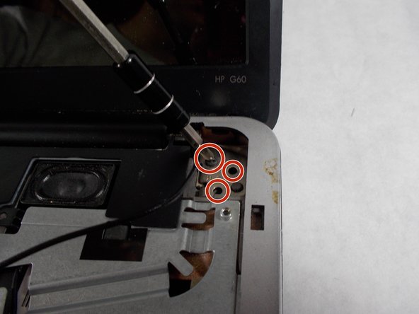

    • Remove the bottom two screen bearings.
    • Using a Phillips 1 screwdriver, remove the two screws on each side.

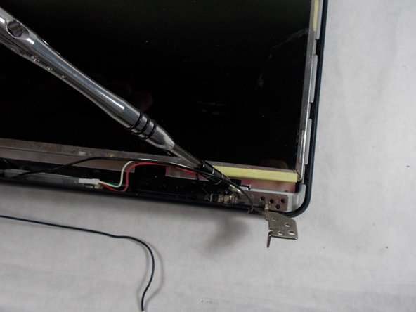

  16. HP Pavilion G60-247CL Screen Replacement: crwdns2935265:016crwdnd2935265:01crwdnd2935265:02crwdne2935265:0 HP Pavilion G60-247CL Screen Replacement: crwdns2935265:016crwdnd2935265:02crwdnd2935265:02crwdne2935265:0

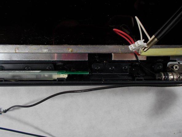

    • Using the tweezers remove the red and white wire from the bottom of the screen.
  17. HP Pavilion G60-247CL Screen Replacement: crwdns2935265:017crwdnd2935265:01crwdnd2935265:02crwdne2935265:0 HP Pavilion G60-247CL Screen Replacement: crwdns2935265:017crwdnd2935265:02crwdnd2935265:02crwdne2935265:0
    • Prop the screen up slightly.
    • Using the tweezers unclip the white wire.

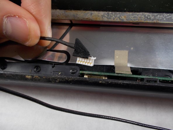

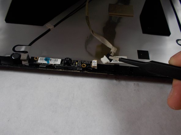

  18. HP Pavilion G60-247CL Screen Replacement: crwdns2935265:018crwdnd2935265:01crwdnd2935265:02crwdne2935265:0 HP Pavilion G60-247CL Screen Replacement: crwdns2935265:018crwdnd2935265:02crwdnd2935265:02crwdne2935265:0
    • While the screen is still propped open, remove the black wire from the bottom middle of the screen by pulling gently.

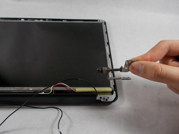

  19. HP Pavilion G60-247CL Screen Replacement: crwdns2935265:019crwdnd2935265:01crwdnd2935265:01crwdne2935265:0
    • Remove the screen from the outer casing carefully.
