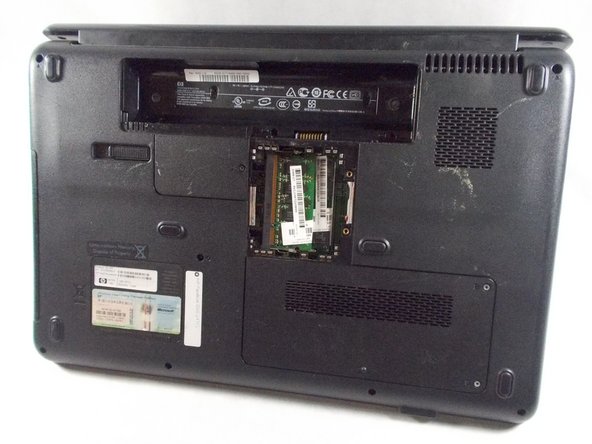

  2. HP Pavilion G60-247CL RAM Replacement, RAM: crwdns2935265:02crwdnd2935265:01crwdnd2935265:01crwdne2935265:0
    • Locate RAM access door on the bottom side of the laptop.

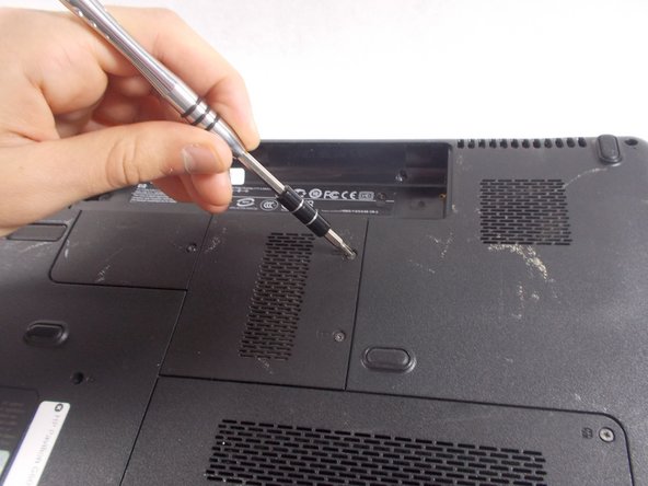

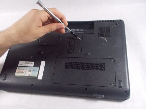

  3. HP Pavilion G60-247CL RAM Replacement: crwdns2935265:03crwdnd2935265:01crwdnd2935265:03crwdne2935265:0 HP Pavilion G60-247CL RAM Replacement: crwdns2935265:03crwdnd2935265:02crwdnd2935265:03crwdne2935265:0 HP Pavilion G60-247CL RAM Replacement: crwdns2935265:03crwdnd2935265:03crwdnd2935265:03crwdne2935265:0
    • Remove the two screws holding down the RAM access door with a Phillips #1 screwdriver.
  4. HP Pavilion G60-247CL RAM Replacement: crwdns2935265:04crwdnd2935265:01crwdnd2935265:02crwdne2935265:0 HP Pavilion G60-247CL RAM Replacement: crwdns2935265:04crwdnd2935265:02crwdnd2935265:02crwdne2935265:0
    • Lift up on the RAM cover and remove it to reveal RAM sticks.

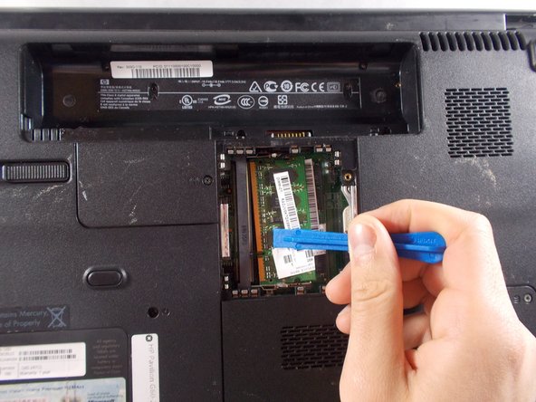

  5. HP Pavilion G60-247CL RAM Replacement: crwdns2935265:05crwdnd2935265:01crwdnd2935265:02crwdne2935265:0 HP Pavilion G60-247CL RAM Replacement: crwdns2935265:05crwdnd2935265:02crwdnd2935265:02crwdne2935265:0
    • Gently pull apart the two metal tabs located on both sides of the stick of RAM.
  6. HP Pavilion G60-247CL RAM Replacement: crwdns2935265:06crwdnd2935265:01crwdnd2935265:01crwdne2935265:0
    • Gently lift the RAM stick up and out of its seat.
  7. HP Pavilion G60-247CL RAM Replacement: crwdns2935265:07crwdnd2935265:01crwdnd2935265:01crwdne2935265:0
    • Repeat the previous two steps for the remaining stick of RAM.
