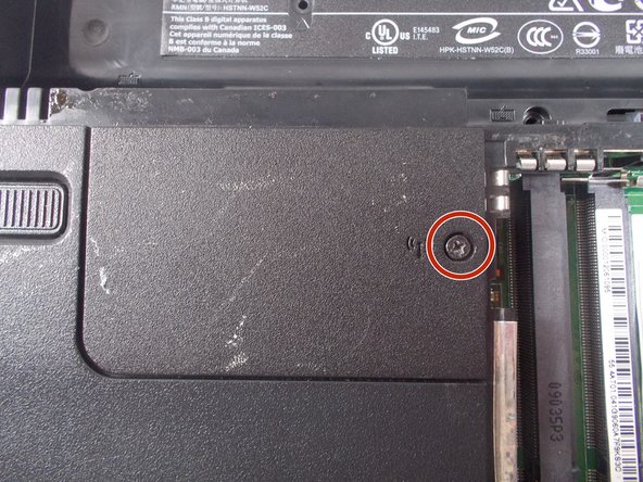

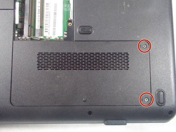

  2. HP Pavilion G60-247CL Fan Replacement, RAM: crwdns2935265:02crwdnd2935265:01crwdnd2935265:01crwdne2935265:0
    • Locate RAM access door on the bottom side of the laptop.
  3. HP Pavilion G60-247CL Fan Replacement: crwdns2935265:03crwdnd2935265:01crwdnd2935265:03crwdne2935265:0 HP Pavilion G60-247CL Fan Replacement: crwdns2935265:03crwdnd2935265:02crwdnd2935265:03crwdne2935265:0 HP Pavilion G60-247CL Fan Replacement: crwdns2935265:03crwdnd2935265:03crwdnd2935265:03crwdne2935265:0
    • Remove the two screws holding down the RAM access door with a Phillips #1 screwdriver.
  4. HP Pavilion G60-247CL Fan Replacement: crwdns2935265:04crwdnd2935265:01crwdnd2935265:02crwdne2935265:0 HP Pavilion G60-247CL Fan Replacement: crwdns2935265:04crwdnd2935265:02crwdnd2935265:02crwdne2935265:0
    • Lift up on the RAM cover and remove it to reveal RAM sticks.
  5. HP Pavilion G60-247CL Fan Replacement: crwdns2935265:05crwdnd2935265:01crwdnd2935265:02crwdne2935265:0 HP Pavilion G60-247CL Fan Replacement: crwdns2935265:05crwdnd2935265:02crwdnd2935265:02crwdne2935265:0
    • Gently pull apart the two metal tabs located on both sides of the stick of RAM.
  6. HP Pavilion G60-247CL Fan Replacement: crwdns2935265:06crwdnd2935265:01crwdnd2935265:01crwdne2935265:0
    • Gently lift the RAM stick up and out of its seat.
  7. HP Pavilion G60-247CL Fan Replacement: crwdns2935265:07crwdnd2935265:01crwdnd2935265:01crwdne2935265:0
    • Repeat the previous two steps for the remaining stick of RAM.

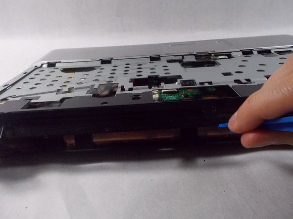

    • Turn the computer around to the front side.
    • Using an opening tool, prop open the keyboard casing.

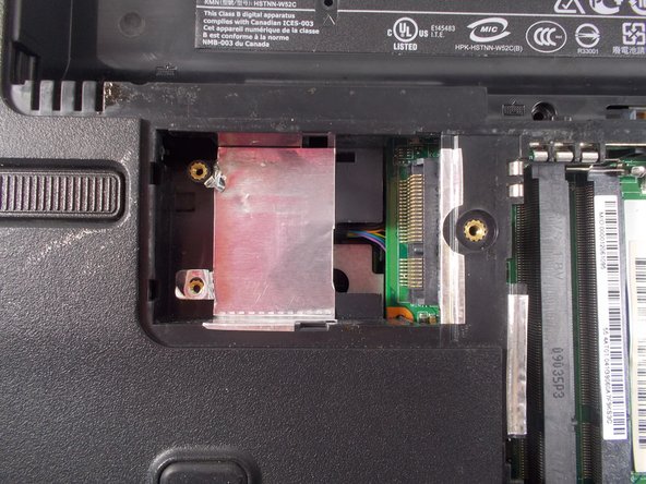

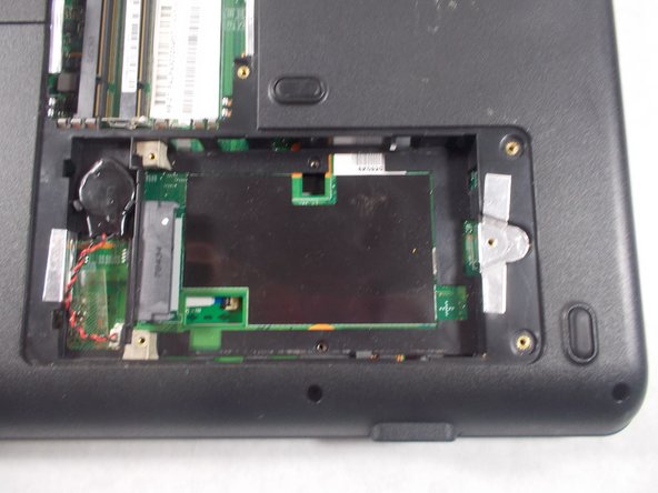

  26. HP Pavilion G60-247CL Fan Replacement, Speakers: crwdns2935265:026crwdnd2935265:01crwdnd2935265:02crwdne2935265:0 HP Pavilion G60-247CL Fan Replacement, Speakers: crwdns2935265:026crwdnd2935265:02crwdnd2935265:02crwdne2935265:0
    • Remove the battery and RAM.
    • Locate the hard drive access panel.
    • Remove the two 1.2mm Phillips #1 screws on the hard drive access panel.
  27. HP Pavilion G60-247CL Fan Replacement: crwdns2935265:027crwdnd2935265:01crwdnd2935265:02crwdne2935265:0 HP Pavilion G60-247CL Fan Replacement: crwdns2935265:027crwdnd2935265:02crwdnd2935265:02crwdne2935265:0
    • After the screws are removed, slide the hard drive panel to the right to remove it.
  28. HP Pavilion G60-247CL Fan Replacement: crwdns2935265:028crwdnd2935265:01crwdnd2935265:02crwdne2935265:0 HP Pavilion G60-247CL Fan Replacement: crwdns2935265:028crwdnd2935265:02crwdnd2935265:02crwdne2935265:0
    • Identify the 3 screws holding the hard drive's cover in place.
    • Use a Phillips #0 screwdriver to remove the 3 screws and reveal the hard drive.
    • This particular laptop does not contain a hard drive-- yours will.

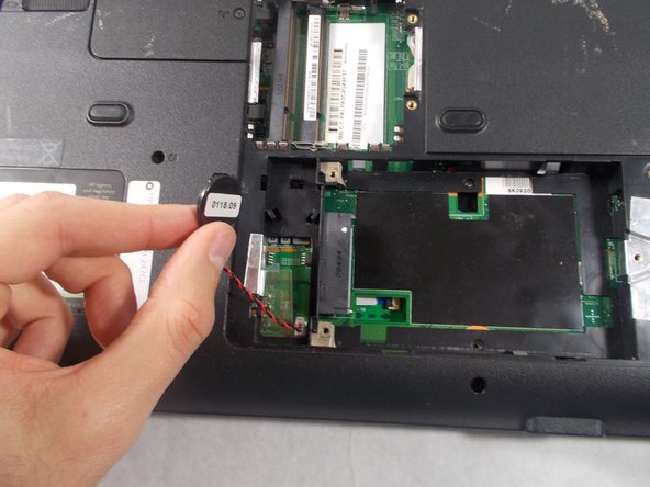

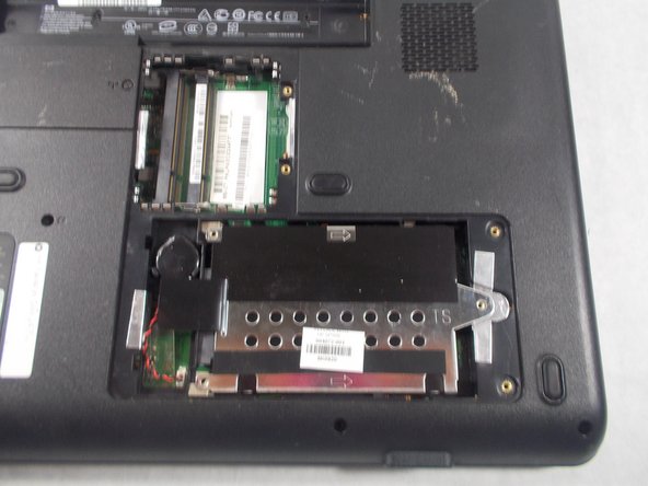

  29. HP Pavilion G60-247CL Fan Replacement: crwdns2935265:029crwdnd2935265:01crwdnd2935265:02crwdne2935265:0 HP Pavilion G60-247CL Fan Replacement: crwdns2935265:029crwdnd2935265:02crwdnd2935265:02crwdne2935265:0
    • Locate the storage battery, next to the hard drive.
    • Gently pop out the storage battery with your fingers.
  30. HP Pavilion G60-247CL Fan Replacement: crwdns2935265:030crwdnd2935265:01crwdnd2935265:02crwdne2935265:0 HP Pavilion G60-247CL Fan Replacement: crwdns2935265:030crwdnd2935265:02crwdnd2935265:02crwdne2935265:0

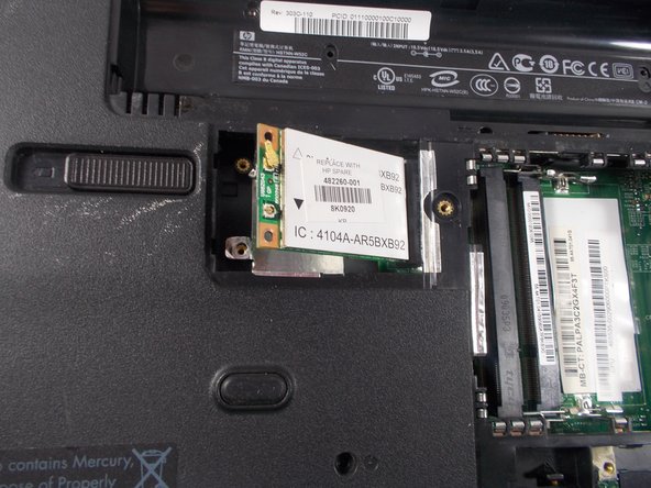

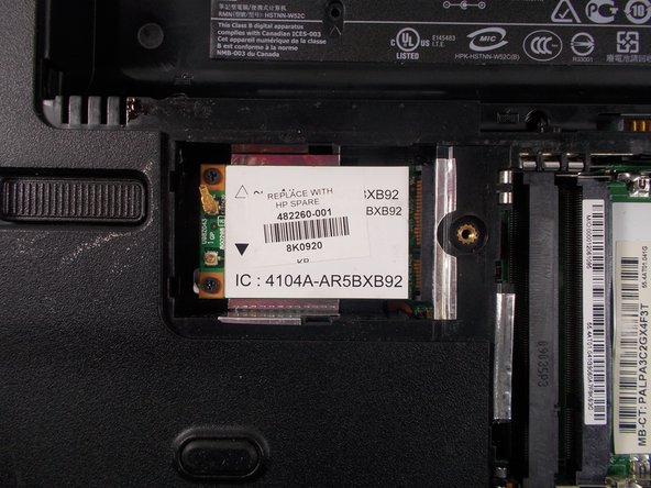

    • Locate the Wi-Fi card cover panel, to the left of the RAM.
    • Use a Phillips #1 screwdriver to remove the screw from the Wi-Fi card cover panel.
  31. HP Pavilion G60-247CL Fan Replacement: crwdns2935265:031crwdnd2935265:01crwdnd2935265:02crwdne2935265:0 HP Pavilion G60-247CL Fan Replacement: crwdns2935265:031crwdnd2935265:02crwdnd2935265:02crwdne2935265:0
    • Lift up on the screw side to remove the panel.
  32. HP Pavilion G60-247CL Fan Replacement: crwdns2935265:032crwdnd2935265:01crwdnd2935265:02crwdne2935265:0 HP Pavilion G60-247CL Fan Replacement: crwdns2935265:032crwdnd2935265:02crwdnd2935265:02crwdne2935265:0
    • Remove two 1.2 mm Phillips #01 screws.
    • When the screws are removed, the Wi-Fi card will pop up.
  33. HP Pavilion G60-247CL Fan Replacement: crwdns2935265:033crwdnd2935265:01crwdnd2935265:02crwdne2935265:0 HP Pavilion G60-247CL Fan Replacement: crwdns2935265:033crwdnd2935265:02crwdnd2935265:02crwdne2935265:0
    • Remove the Wi-Fi card by pulling it to the left of the laptop.
  34. HP Pavilion G60-247CL Fan Replacement: crwdns2935265:034crwdnd2935265:01crwdnd2935265:01crwdne2935265:0

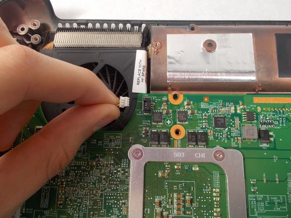

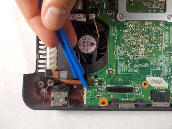

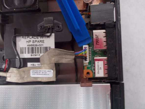

  41. HP Pavilion G60-247CL Fan Replacement, Fan: crwdns2935265:041crwdnd2935265:01crwdnd2935265:02crwdne2935265:0 HP Pavilion G60-247CL Fan Replacement, Fan: crwdns2935265:041crwdnd2935265:02crwdnd2935265:02crwdne2935265:0
    • Locate the fan in the top left corner.
    • Carefully disconnect the wire attached to the motherboard using your fingers.

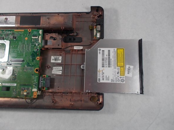

  43. HP Pavilion G60-247CL Fan Replacement: crwdns2935265:043crwdnd2935265:01crwdnd2935265:03crwdne2935265:0 HP Pavilion G60-247CL Fan Replacement: crwdns2935265:043crwdnd2935265:02crwdnd2935265:03crwdne2935265:0 HP Pavilion G60-247CL Fan Replacement: crwdns2935265:043crwdnd2935265:03crwdnd2935265:03crwdne2935265:0
    • Slide out the disk player to the right.
  44. HP Pavilion G60-247CL Fan Replacement: crwdns2935265:044crwdnd2935265:01crwdnd2935265:02crwdne2935265:0 HP Pavilion G60-247CL Fan Replacement: crwdns2935265:044crwdnd2935265:02crwdnd2935265:02crwdne2935265:0

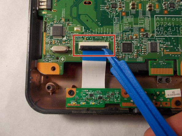

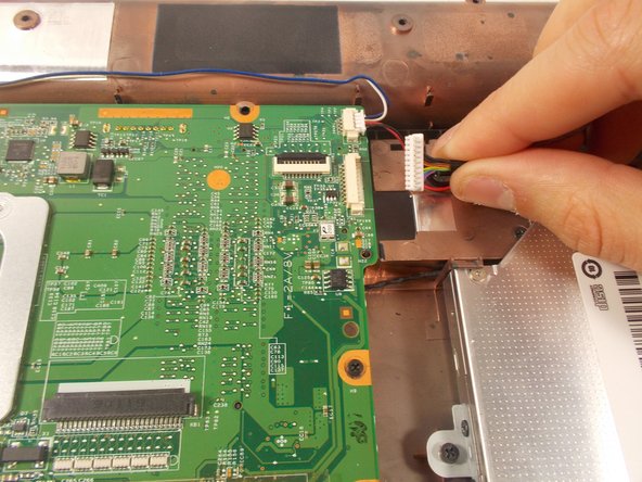

    • Gently disconnect the ribbon cable using an opening tool.

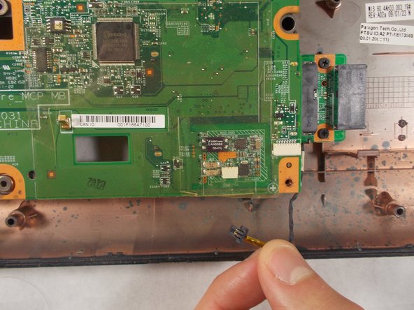

  45. HP Pavilion G60-247CL Fan Replacement: crwdns2935265:045crwdnd2935265:01crwdnd2935265:03crwdne2935265:0 HP Pavilion G60-247CL Fan Replacement: crwdns2935265:045crwdnd2935265:02crwdnd2935265:03crwdne2935265:0 HP Pavilion G60-247CL Fan Replacement: crwdns2935265:045crwdnd2935265:03crwdnd2935265:03crwdne2935265:0

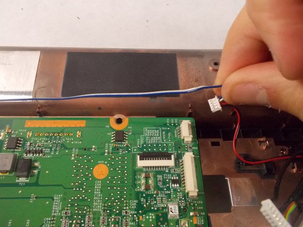

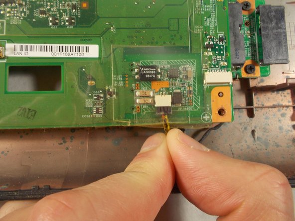

    • Disconnect the wire connected to motherboard by gently pulling downwards.
  46. HP Pavilion G60-247CL Fan Replacement: crwdns2935265:046crwdnd2935265:01crwdnd2935265:03crwdne2935265:0 HP Pavilion G60-247CL Fan Replacement: crwdns2935265:046crwdnd2935265:02crwdnd2935265:03crwdne2935265:0 HP Pavilion G60-247CL Fan Replacement: crwdns2935265:046crwdnd2935265:03crwdnd2935265:03crwdne2935265:0
    • Disconnect the wire connected to the motherboard using an opening tool.

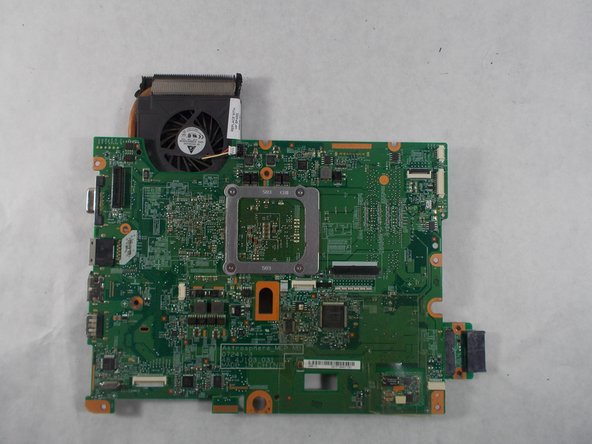

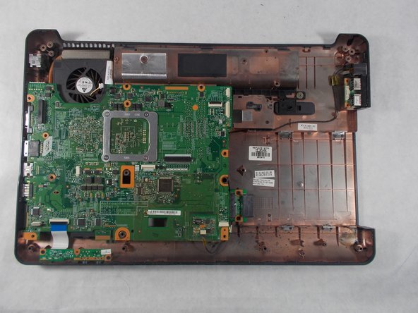

  47. HP Pavilion G60-247CL Fan Replacement: crwdns2935265:047crwdnd2935265:01crwdnd2935265:02crwdne2935265:0 HP Pavilion G60-247CL Fan Replacement: crwdns2935265:047crwdnd2935265:02crwdnd2935265:02crwdne2935265:0

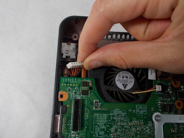

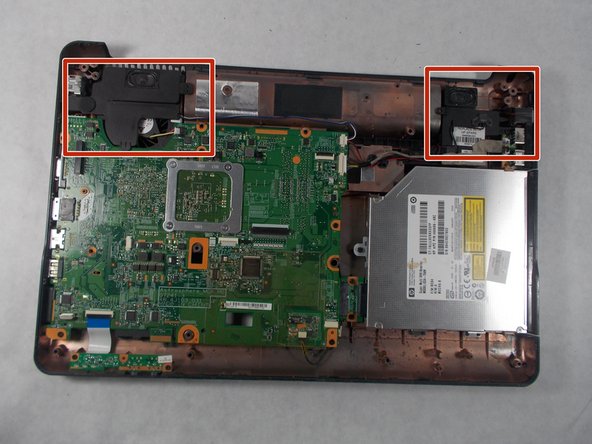

    • Gently remove motherboard with fan from the shell.

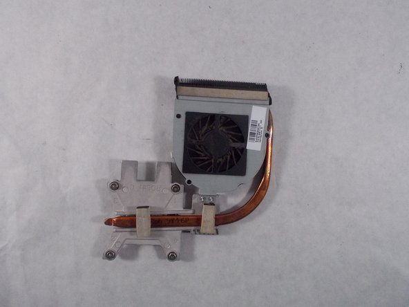

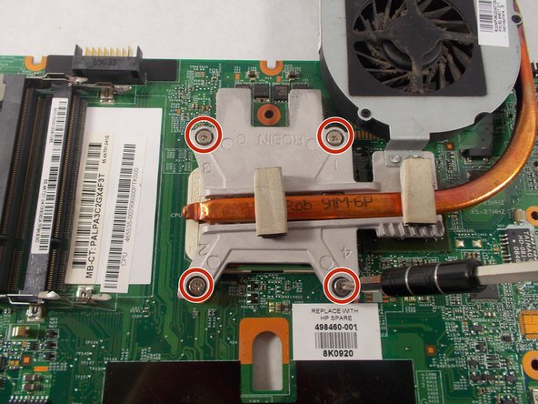

  48. HP Pavilion G60-247CL Fan Replacement: crwdns2935265:048crwdnd2935265:01crwdnd2935265:02crwdne2935265:0 HP Pavilion G60-247CL Fan Replacement: crwdns2935265:048crwdnd2935265:02crwdnd2935265:02crwdne2935265:0
    • Flip over the motherboard to view the back side.
    • Remove four 1.6 mm screws with a Phillips #1 screwdriver.
  49. HP Pavilion G60-247CL Fan Replacement: crwdns2935265:049crwdnd2935265:01crwdnd2935265:02crwdne2935265:0 HP Pavilion G60-247CL Fan Replacement: crwdns2935265:049crwdnd2935265:02crwdnd2935265:02crwdne2935265:0
    • Gently lift out the fan.
