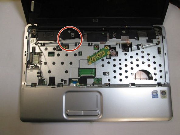

    • Unplug two wires by gently pulling it out.
    • Then remove two wires from the clip that was holding the wire in place.
  5. HP Pavilion G60-235DX Screen Replacement: crwdns2935265:05crwdnd2935265:01crwdnd2935265:01crwdne2935265:0
    • Remove the covered cable ribbon that is located at the left side of the computer.
  6. HP Pavilion G60-235DX Screen Replacement: crwdns2935265:06crwdnd2935265:01crwdnd2935265:01crwdne2935265:0
    • Gently pull the smaller wire from its clip. Please do not pull the wire by holding the wire itself. Use the plastic cover to pull.
  7. HP Pavilion G60-235DX Screen Replacement: crwdns2935265:07crwdnd2935265:01crwdnd2935265:01crwdne2935265:0
    • There are 3 screws holding the screen from laptop each side. Unscrew every screw for each side.
    • Then gently pull out the screen from its place. Be sure not to force it out.
