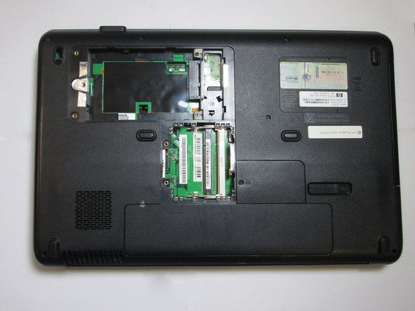

  12. HP Pavilion G60-235DX Fan Replacement, Ram: crwdns2935265:012crwdnd2935265:01crwdnd2935265:01crwdne2935265:0
    • Lay the computer so that the backside is facing you and locate the screw in the picture.
  13. HP Pavilion G60-235DX Fan Replacement: crwdns2935265:013crwdnd2935265:01crwdnd2935265:01crwdne2935265:0
    • Remove the screws.
  14. HP Pavilion G60-235DX Fan Replacement: crwdns2935265:014crwdnd2935265:01crwdnd2935265:01crwdne2935265:0
    • Remove the cover that was held in by the screws that you just removed.
  15. HP Pavilion G60-235DX Fan Replacement: crwdns2935265:015crwdnd2935265:01crwdnd2935265:01crwdne2935265:0
    • Push this slide over in order to remove the battery. This is safe when working with your computers memory.
  16. HP Pavilion G60-235DX Fan Replacement: crwdns2935265:016crwdnd2935265:01crwdnd2935265:01crwdne2935265:0
    • Remove each one of the rams so that the computer looks like this. You can do so be squeezing tabs on each side of the ram.
