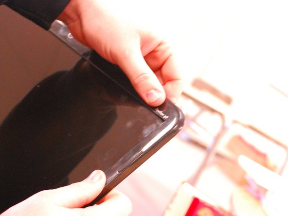

  4. HP Pavilion G6-2249wm screen Replacement, screen cover removal: crwdns2935265:04crwdnd2935265:01crwdnd2935265:02crwdne2935265:0 HP Pavilion G6-2249wm screen Replacement, screen cover removal: crwdns2935265:04crwdnd2935265:02crwdnd2935265:02crwdne2935265:0
    • After removing the screws, pop out the plastic protector (can be done with your fingers).
    • Start at one corner and run your finger under the plastic and it will pop out.

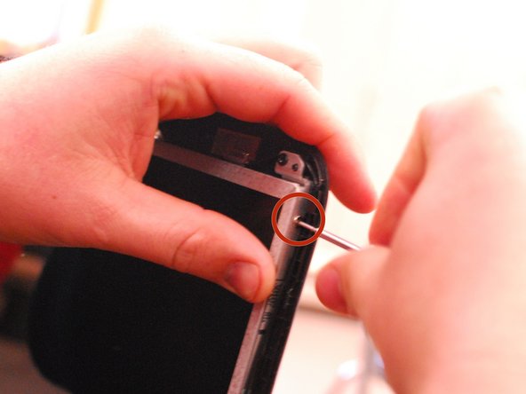

  5. HP Pavilion G6-2249wm screen Replacement, screen screw removal: crwdns2935265:05crwdnd2935265:01crwdnd2935265:01crwdne2935265:0
    • On each side of the screen there are two little screws, one on top and one on bottom.
    • All four of the screws need to be removed (place the screws on a little piece of tape so they won't be lost).

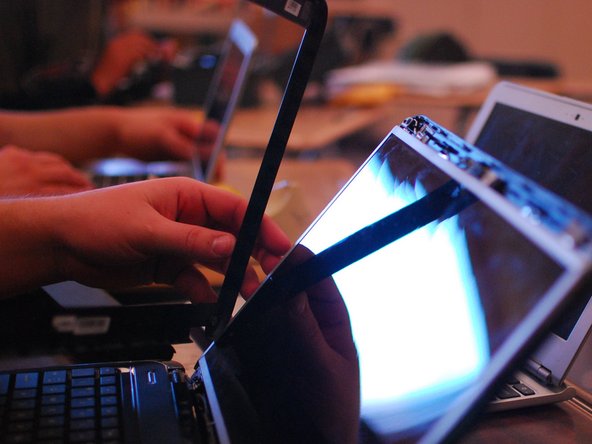

  6. HP Pavilion G6-2249wm screen Replacement, screen removal: crwdns2935265:06crwdnd2935265:01crwdnd2935265:01crwdne2935265:0
    • Once the screws are out, remove the screen and lay it on your keyboard.

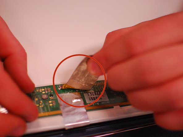

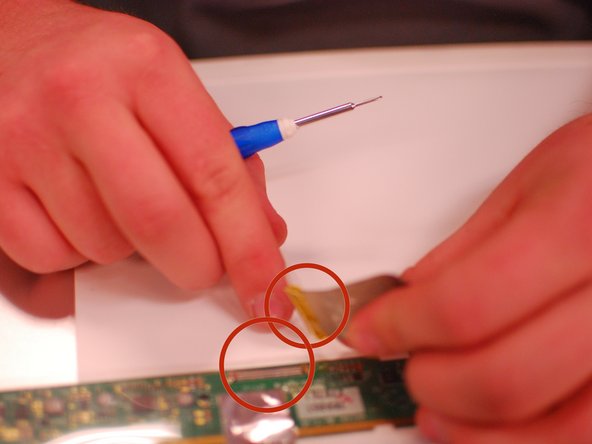

  7. HP Pavilion G6-2249wm screen Replacement, digital attachment removal: crwdns2935265:07crwdnd2935265:01crwdnd2935265:03crwdne2935265:0 HP Pavilion G6-2249wm screen Replacement, digital attachment removal: crwdns2935265:07crwdnd2935265:02crwdnd2935265:03crwdne2935265:0 HP Pavilion G6-2249wm screen Replacement, digital attachment removal: crwdns2935265:07crwdnd2935265:03crwdnd2935265:03crwdne2935265:0
    • Once the screen is laying down you will see a connector on the back of it.
    • Pull the sticker off which pulls the connector with it.
  8. HP Pavilion G6-2249wm screen Replacement, Reconnecting the screen: crwdns2935265:08crwdnd2935265:01crwdnd2935265:01crwdne2935265:0
    • After the new screen has arrived, reconnect the little connecter strip.
