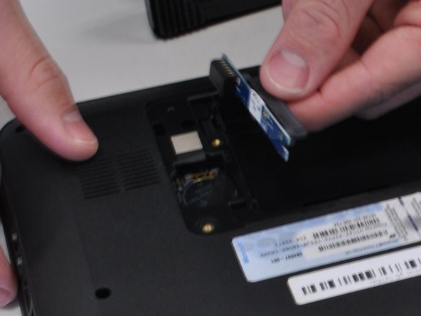

  4. HP Pavilion G6-1d16dx Screen hinges Replacement, Motherboard: crwdns2935265:04crwdnd2935265:01crwdnd2935265:01crwdne2935265:0
    • Unscrew the two silver screws holding the protective cover in place until they make a clicking noise.
    • The screws do not remove from the cover.

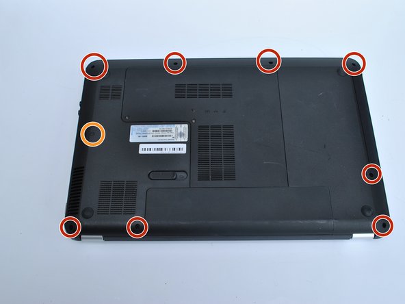

  5. HP Pavilion G6-1d16dx Screen hinges Replacement: crwdns2935265:05crwdnd2935265:01crwdnd2935265:02crwdne2935265:0 HP Pavilion G6-1d16dx Screen hinges Replacement: crwdns2935265:05crwdnd2935265:02crwdnd2935265:02crwdne2935265:0
    • Unsnap the Cover by lifting the edge along the battery compartment.
    • Remove all of the body screws.
    • Remove the rubber cap and the screw underneath it.

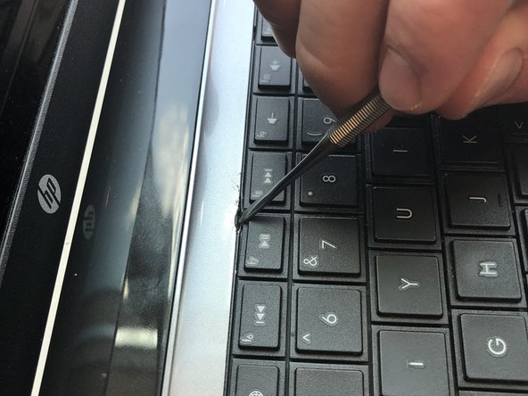

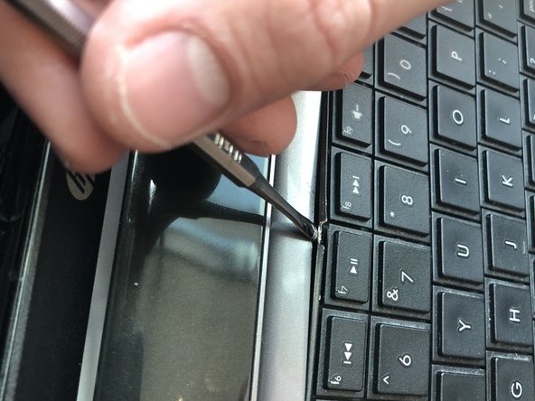

    • The keyboard is held in by nine tabs
    • Using a metal tool, depress the center tab and pry up the keyboard by pivoting the tool towards the screen.

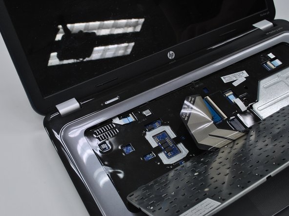

  7. HP Pavilion G6-1d16dx Screen hinges Replacement: crwdns2935265:07crwdnd2935265:01crwdnd2935265:02crwdne2935265:0 HP Pavilion G6-1d16dx Screen hinges Replacement: crwdns2935265:07crwdnd2935265:02crwdnd2935265:02crwdne2935265:0
    • Slide the tool that is now under the keyboard sideways along the edge and use another tool to depress the other tabs along the edge of the keyboard.
    • As you depress the tabs, the edges of the keyboard will pop up.
    • Lift off the keyboard
  8. HP Pavilion G6-1d16dx Screen hinges Replacement: crwdns2935265:08crwdnd2935265:01crwdnd2935265:01crwdne2935265:0
    • Flip up the black tab holding the keyboard in place via the ribbon cable and pull out the cable

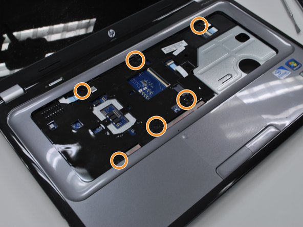

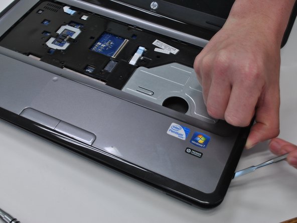

    • Remove the two remaining ribbon cables.
    • Remove the screws holding in the protective cover underneath the keyboard.
    • Pop the cover off using any flat metal tool, starting with where you took out the optical drive
    • It will be very sticky near the edge closest to the screen. This is where the sticker in the battery compartment is stuck to. just use a little more force.

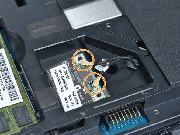

    • Lift the tape tab up from the screen plug, and unplug the screen from the motherboard.
    • Unplug the wires from the wireless card and pull them through the body.
