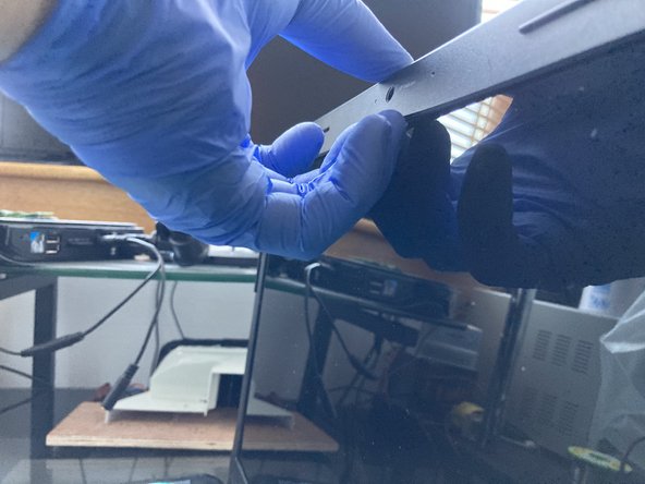

    3. HP Pavilion G6  Screen Replacement, Remove the plastic frame: crwdns2935265:03crwdnd2935265:01crwdnd2935265:03crwdne2935265:0 HP Pavilion G6  Screen Replacement, Remove the plastic frame: crwdns2935265:03crwdnd2935265:02crwdnd2935265:03crwdne2935265:0 HP Pavilion G6  Screen Replacement, Remove the plastic frame: crwdns2935265:03crwdnd2935265:03crwdnd2935265:03crwdne2935265:0
      • Unscrew the exposed 2 x Philips screws and set them aside.
      • Starting from the top, pry up the plastic frame with your fingernails or a pry bar.
      • If you are using a pry bar, it can scratch the screen. Apply gentle pressure until the plastic frame pop out all around the frame. Don't force it!
      • Finally, remove the frame.

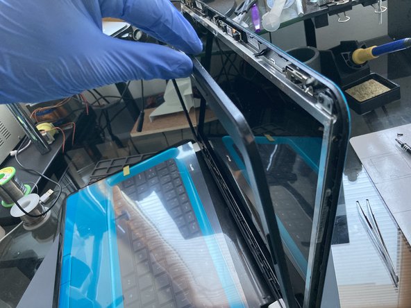

    4. HP Pavilion G6  Screen Replacement, Release the screen from the frame: crwdns2935265:04crwdnd2935265:01crwdnd2935265:03crwdne2935265:0 HP Pavilion G6  Screen Replacement, Release the screen from the frame: crwdns2935265:04crwdnd2935265:02crwdnd2935265:03crwdne2935265:0 HP Pavilion G6  Screen Replacement, Release the screen from the frame: crwdns2935265:04crwdnd2935265:03crwdnd2935265:03crwdne2935265:0
      • Remove the black Philips screw from the top on each side.
      • Remove the bottom screw from the hinge to make an easier access to the screws on the side of the screen.
      • Now that the frame is loose, you can remove the 4 x Philips screws holding the screen in the frame.

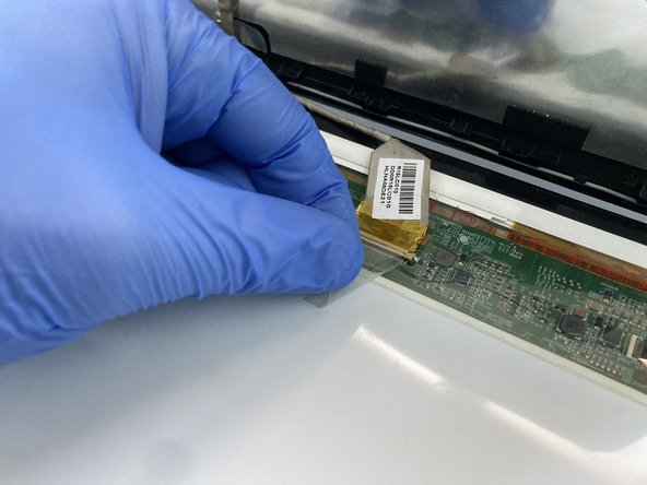

    5. HP Pavilion G6  Screen Replacement, Disconnect the screen connector: crwdns2935265:05crwdnd2935265:01crwdnd2935265:03crwdne2935265:0 HP Pavilion G6  Screen Replacement, Disconnect the screen connector: crwdns2935265:05crwdnd2935265:02crwdnd2935265:03crwdne2935265:0 HP Pavilion G6  Screen Replacement, Disconnect the screen connector: crwdns2935265:05crwdnd2935265:03crwdnd2935265:03crwdne2935265:0
      • Turn the laptop back up and carefully tilt the screen out from the frame and rest it on the keyboard.
      • Don't try to fully remove it yet as it is still attached to the motherboard by the screen cable!
      • Gently lift up the adhesive and disconnect the screen connector. That is the screen released and ready for a change for a new one.
