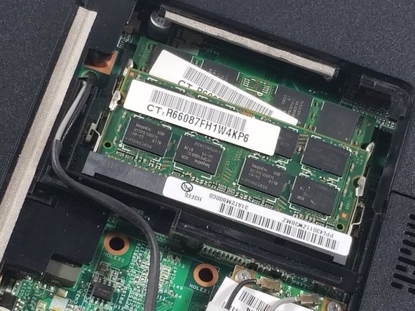

    • Turn the device over so that the bottom is facing upward.
    • Locate the three panels near the bottom half of the device.
    • The middle-most panel is the one we will be focusing on.
    • Using a Philips #0 screwdriver, unscrew the two 4mm screws that hold this panel in place.
  2. HP Pavilion DV9700 RAM Replacement: crwdns2935265:02crwdnd2935265:01crwdnd2935265:02crwdne2935265:0 HP Pavilion DV9700 RAM Replacement: crwdns2935265:02crwdnd2935265:02crwdnd2935265:02crwdne2935265:0
    • Pull the bottom of the panel upward.
    • Then pull the panel toward yourself to remove.
  3. HP Pavilion DV9700 RAM Replacement: crwdns2935265:03crwdnd2935265:01crwdnd2935265:03crwdne2935265:0 HP Pavilion DV9700 RAM Replacement: crwdns2935265:03crwdnd2935265:02crwdnd2935265:03crwdne2935265:0 HP Pavilion DV9700 RAM Replacement: crwdns2935265:03crwdnd2935265:03crwdnd2935265:03crwdne2935265:0
    • Look toward the top half of the exposed compartment.
    • Each ram stick will have two silver clips on the left and right side.
    • Push these clips outward at the same time to release the ram stick.
  4. HP Pavilion DV9700 RAM Replacement: crwdns2935265:04crwdnd2935265:01crwdnd2935265:03crwdne2935265:0 HP Pavilion DV9700 RAM Replacement: crwdns2935265:04crwdnd2935265:02crwdnd2935265:03crwdne2935265:0 HP Pavilion DV9700 RAM Replacement: crwdns2935265:04crwdnd2935265:03crwdnd2935265:03crwdne2935265:0
    • The ram stick will be held at a 45 degree angle. Pull the stick upward to release it from the slot.
    • Each ram stick will have a notch near the bottom, make sure to keep note of which side this notch is on.
    • Make sure to place the ram away from any static surfaces (carpet, fabric, etc.)
