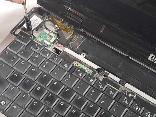

  8. HP Pavilion DV9700 Keyboard  Replacement, Keyboard: crwdns2935265:08crwdnd2935265:01crwdnd2935265:02crwdne2935265:0 HP Pavilion DV9700 Keyboard  Replacement, Keyboard: crwdns2935265:08crwdnd2935265:02crwdnd2935265:02crwdne2935265:0
    • There are three 4mm screws located above the keyboard.
    • Remove the screws using a Philips #0 screwdriver.
    • These screws are very small, make sure to have an organize place to put them.
  9. HP Pavilion DV9700 Keyboard  Replacement: crwdns2935265:09crwdnd2935265:01crwdnd2935265:02crwdne2935265:0 HP Pavilion DV9700 Keyboard  Replacement: crwdns2935265:09crwdnd2935265:02crwdnd2935265:02crwdne2935265:0
    • Grab the top corners of the keyboard and pull upward about an inch.
    • Then pull the keyboard toward the monitor to release it from the casing.
  10. HP Pavilion DV9700 Keyboard  Replacement: crwdns2935265:010crwdnd2935265:01crwdnd2935265:03crwdne2935265:0 HP Pavilion DV9700 Keyboard  Replacement: crwdns2935265:010crwdnd2935265:02crwdnd2935265:03crwdne2935265:0 HP Pavilion DV9700 Keyboard  Replacement: crwdns2935265:010crwdnd2935265:03crwdnd2935265:03crwdne2935265:0
    • The keyboard will be attached with a ribbon cable from underneath.
    • Carefully pry the black clip that is holding the cable to release.
    • Both the ribbon cable and clip are fragile, make sure not to lift the keyboard so high that the cable can tear.
  11. HP Pavilion DV9700 Keyboard  Replacement: crwdns2935265:011crwdnd2935265:01crwdnd2935265:01crwdne2935265:0
    • You may now lift the keyboard from the laptop and replace it with a new, functioning one.
