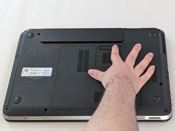

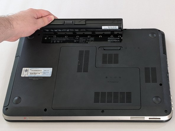

    • Flip the laptop so the bottom is facing up.
    • Push the sliding latch to the left to release the battery and remove it from the laptop.
  2. HP Pavilion DV6-6C35DX Hard Drive Replacement: crwdns2935265:02crwdnd2935265:01crwdnd2935265:03crwdne2935265:0 HP Pavilion DV6-6C35DX Hard Drive Replacement: crwdns2935265:02crwdnd2935265:02crwdnd2935265:03crwdne2935265:0 HP Pavilion DV6-6C35DX Hard Drive Replacement: crwdns2935265:02crwdnd2935265:03crwdnd2935265:03crwdne2935265:0
    • Push the same sliding latch to the right to release the L-shaped panel.
    • Remove the panel from the laptop.
    • You may need to use a spudger to pry out the L-shaped panel and release any clips before removing it.
    • When reassembling the device, make sure to start by inserting the bottom of the panel first (see image 3).

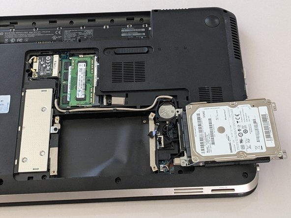

  3. HP Pavilion DV6-6C35DX Hard Drive Replacement: crwdns2935265:03crwdnd2935265:01crwdnd2935265:02crwdne2935265:0 HP Pavilion DV6-6C35DX Hard Drive Replacement: crwdns2935265:03crwdnd2935265:02crwdnd2935265:02crwdne2935265:0

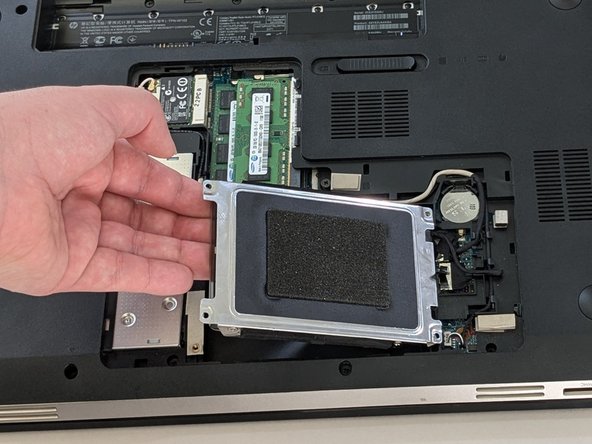

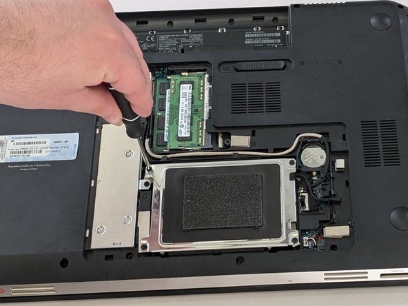

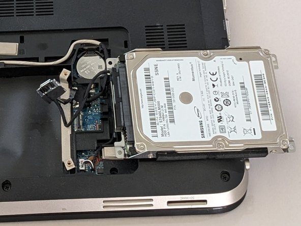

    • Use a Phillips #0 screwdriver to remove the four 4 mm screws that secure the hard drive.
  4. HP Pavilion DV6-6C35DX Hard Drive Replacement: crwdns2935265:04crwdnd2935265:01crwdnd2935265:03crwdne2935265:0 HP Pavilion DV6-6C35DX Hard Drive Replacement: crwdns2935265:04crwdnd2935265:02crwdnd2935265:03crwdne2935265:0 HP Pavilion DV6-6C35DX Hard Drive Replacement: crwdns2935265:04crwdnd2935265:03crwdnd2935265:03crwdne2935265:0
    • Lift the hard drive out of the slot from the side under the RAM slot.
    • Be careful not to pull on the cable connecting the hard drive to the laptop.
    • Use a spudger to help lift the drive out of the chassis if you are unable to with your fingers.

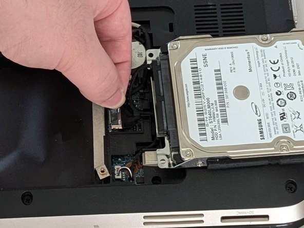

  5. HP Pavilion DV6-6C35DX Hard Drive Replacement: crwdns2935265:05crwdnd2935265:01crwdnd2935265:03crwdne2935265:0 HP Pavilion DV6-6C35DX Hard Drive Replacement: crwdns2935265:05crwdnd2935265:02crwdnd2935265:03crwdne2935265:0 HP Pavilion DV6-6C35DX Hard Drive Replacement: crwdns2935265:05crwdnd2935265:03crwdnd2935265:03crwdne2935265:0

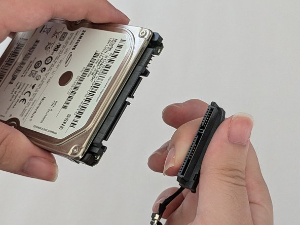

    • Pull the plastic ribbon attached to the connector to disconnect hard drive from the laptop.

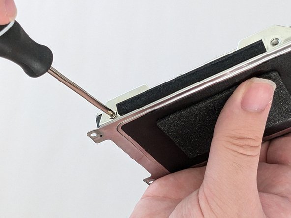

    • Use a Phillips #0 screwdriver to remove the four 4 mm screws on the side of the hard drive cage.
    • When removing the screws, hold the drive cage carefully to prevent the hard drive from falling out.
    • Remove the hard drive from the cage.

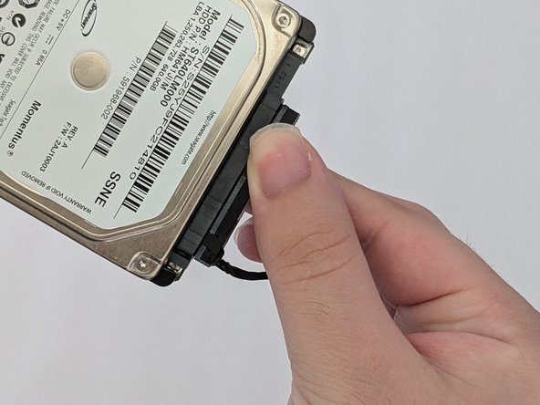

    • Disconnect the SATA cable from the hard drive.
