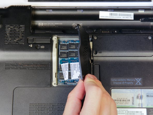

  3. HP Pavilion DV3 RAM Replacement, RAM: crwdns2935265:03crwdnd2935265:01crwdnd2935265:03crwdne2935265:0 HP Pavilion DV3 RAM Replacement, RAM: crwdns2935265:03crwdnd2935265:02crwdnd2935265:03crwdne2935265:0 HP Pavilion DV3 RAM Replacement, RAM: crwdns2935265:03crwdnd2935265:03crwdnd2935265:03crwdne2935265:0
    • Remove the two 3.5 mm diameter head and 7 mm long screws using the Philips PH1 screwdriver.
    • Both screws will remain attached to the cover.
    • Set the cover with attached screws to the side.
    • The RAM will now be exposed

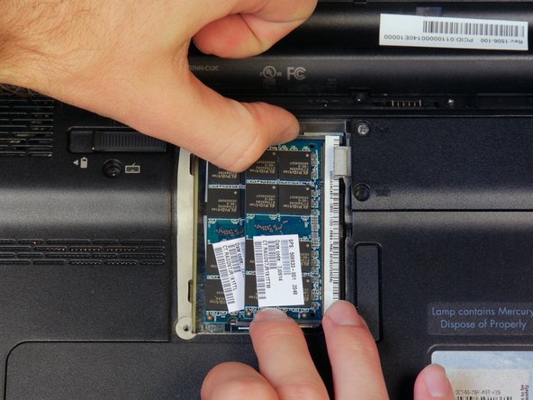

  4. HP Pavilion DV3 RAM Replacement: crwdns2935265:04crwdnd2935265:01crwdnd2935265:03crwdne2935265:0 HP Pavilion DV3 RAM Replacement: crwdns2935265:04crwdnd2935265:02crwdnd2935265:03crwdne2935265:0 HP Pavilion DV3 RAM Replacement: crwdns2935265:04crwdnd2935265:03crwdnd2935265:03crwdne2935265:0
    • Find the two clips located on each side of the RAM.
    • Using both hands, simultaneously grab each clip and open them away from the RAM stick.
    • The RAM will pop up.

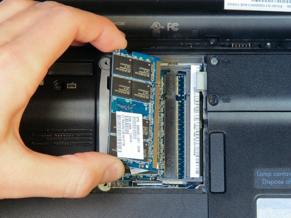

  5. HP Pavilion DV3 RAM Replacement: crwdns2935265:05crwdnd2935265:01crwdnd2935265:02crwdne2935265:0 HP Pavilion DV3 RAM Replacement: crwdns2935265:05crwdnd2935265:02crwdnd2935265:02crwdne2935265:0
    • Using one hand, pull the RAM up and to the left to remove it.
  6. HP Pavilion DV3 RAM Replacement: crwdns2935265:06crwdnd2935265:01crwdnd2935265:01crwdne2935265:0
    • If there is a second RAM module present (as shown), repeat steps 2 and 3 to remove it.
