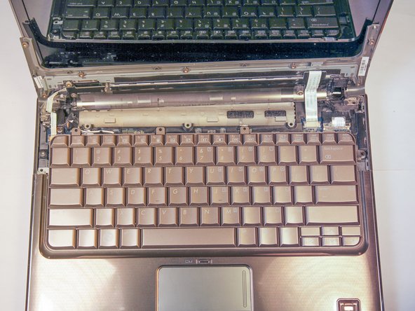

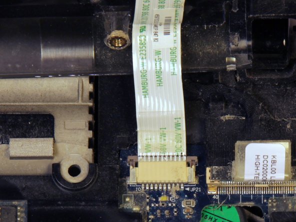

  20. HP Pavilion DV3 Heatsink/Fan Replacement: crwdns2935265:020crwdnd2935265:01crwdnd2935265:03crwdne2935265:0 HP Pavilion DV3 Heatsink/Fan Replacement: crwdns2935265:020crwdnd2935265:02crwdnd2935265:03crwdne2935265:0 HP Pavilion DV3 Heatsink/Fan Replacement: crwdns2935265:020crwdnd2935265:03crwdnd2935265:03crwdne2935265:0

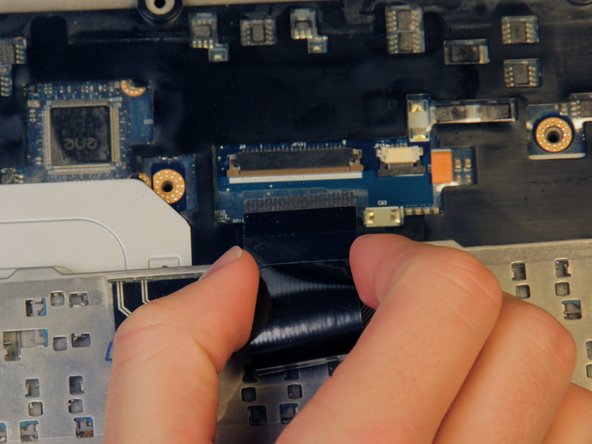

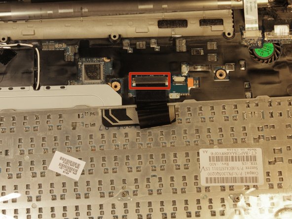

    • Grab the top corners of the keyboard and pull the top towards you.
    • This will separate the keyboard from the laptop.
    • Locate the black connector holding the keyboard ribbon cable.
    • Use the screwdriver or your finger to slide the brown locks on each side of the black connector towards you.
  21. HP Pavilion DV3 Heatsink/Fan Replacement: crwdns2935265:021crwdnd2935265:01crwdnd2935265:03crwdne2935265:0 HP Pavilion DV3 Heatsink/Fan Replacement: crwdns2935265:021crwdnd2935265:02crwdnd2935265:03crwdne2935265:0 HP Pavilion DV3 Heatsink/Fan Replacement: crwdns2935265:021crwdnd2935265:03crwdnd2935265:03crwdne2935265:0
    • Grab the ribbon cable and slide it towards you, out of the black connector.
    • Lift the keyboard up and set it to the side.

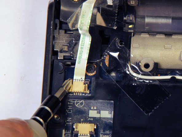

    • Locate the clip for the right ribbon cable attached to the top trim piece that was previously lifted up and push the locks away from you to open them.
    • Once both locks are opened, slide the ribbon cable away from you and out of the clip.
    • Caution! The cable should slide out very easily; do not force it. If it doesn't move, check to make sure the clips are pushed all the way away from you.

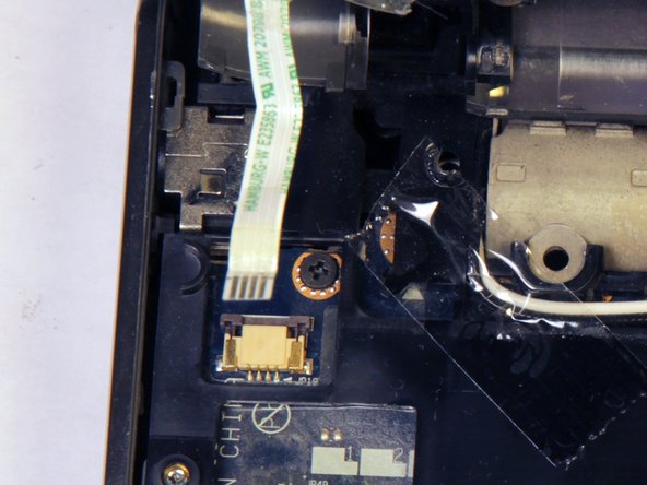

    • Locate the clip for the left ribbon cable attached to the top trim piece that was previously lifted up. Repeat the process for the right ribbon cable in the previous step.

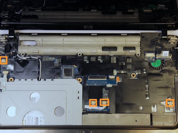

  24. HP Pavilion DV3 Heatsink/Fan Replacement: crwdns2935265:024crwdnd2935265:01crwdnd2935265:02crwdne2935265:0 HP Pavilion DV3 Heatsink/Fan Replacement: crwdns2935265:024crwdnd2935265:02crwdnd2935265:02crwdne2935265:0
    • Locate and remove the 3 black 5mm long screws and set them aside. They will have a 3.5 mm diameter head.
    • Locate the four connectors holding the four ribbon cables.
    • Slide the lock clips down for each connector (as in step 9) and slide each ribbon cable out.

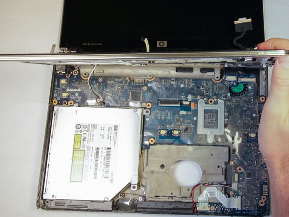

  25. HP Pavilion DV3 Heatsink/Fan Replacement: crwdns2935265:025crwdnd2935265:01crwdnd2935265:02crwdne2935265:0 HP Pavilion DV3 Heatsink/Fan Replacement: crwdns2935265:025crwdnd2935265:02crwdnd2935265:02crwdne2935265:0
    • Locate the connector holding the black screen cable and pull the clear tab up to detach the cable.
    • Pull the black cable out of the two clips holding it to the frame.
    • Once the cable is detached, lift the screen straight up out of the laptop to remove it. Set the screen down right above the laptop body, facing up.
    • Caution! There will still be a wire attached to the screen and laptop body; be careful not to break this wire.
  26. HP Pavilion DV3 Heatsink/Fan Replacement: crwdns2935265:026crwdnd2935265:01crwdnd2935265:03crwdne2935265:0 HP Pavilion DV3 Heatsink/Fan Replacement: crwdns2935265:026crwdnd2935265:02crwdnd2935265:03crwdne2935265:0 HP Pavilion DV3 Heatsink/Fan Replacement: crwdns2935265:026crwdnd2935265:03crwdnd2935265:03crwdne2935265:0
    • Grab the bottom part of the palm rest and pull it up from the base of the laptop. Continue to pull up around the piece until all the clips release.
    • It will take a significant amount of force to separate this piece.
    • Rotate the piece up and away from you.
    • Caution! Be sure the black and white antenna wires do not get stuck. You may need to help pull them through the hole.
    • Lift the piece off the laptop and set it aside

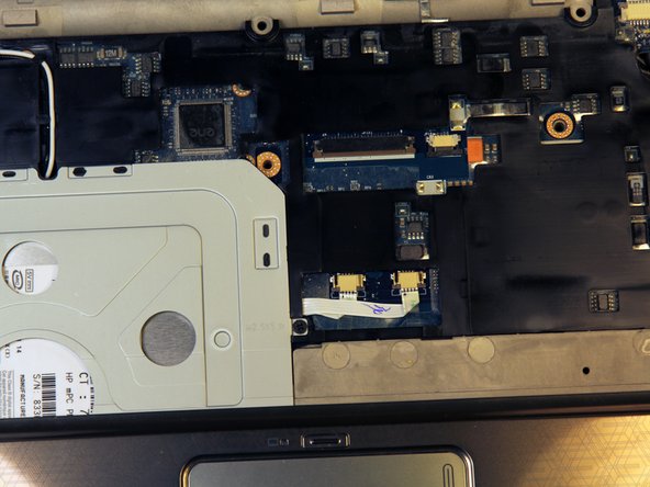

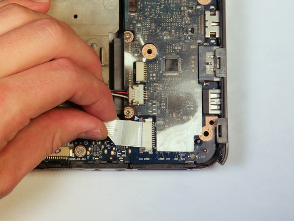

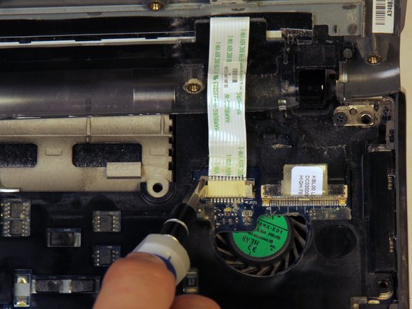

  27. HP Pavilion DV3 Heatsink/Fan Replacement: crwdns2935265:027crwdnd2935265:01crwdnd2935265:03crwdne2935265:0 HP Pavilion DV3 Heatsink/Fan Replacement: crwdns2935265:027crwdnd2935265:02crwdnd2935265:03crwdne2935265:0 HP Pavilion DV3 Heatsink/Fan Replacement: crwdns2935265:027crwdnd2935265:03crwdnd2935265:03crwdne2935265:0

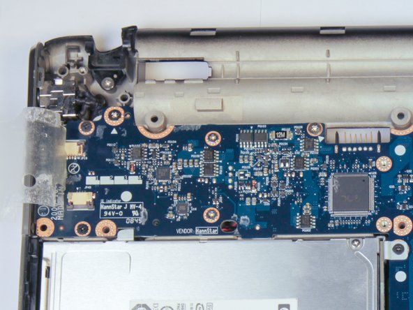

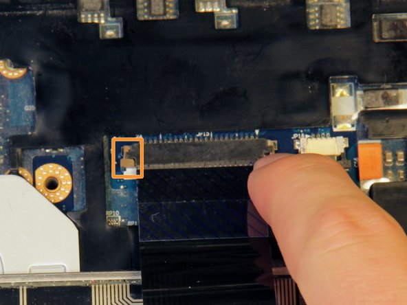

    • Locate the connector for the ribbon cable at the bottom right of the laptop and push each lock to the left using a screwdriver or your finger.
    • Once both locks are opened, slide the ribbon cable to the left and out of the clip.

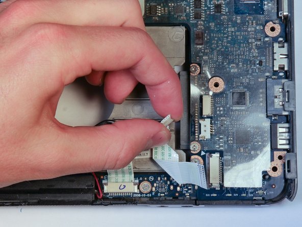

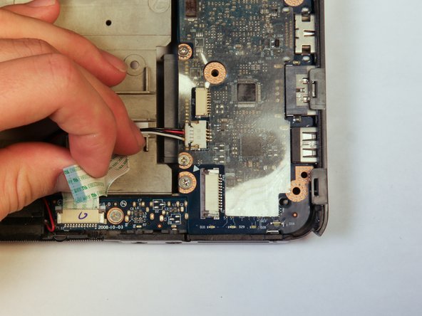

  28. HP Pavilion DV3 Heatsink/Fan Replacement: crwdns2935265:028crwdnd2935265:01crwdnd2935265:03crwdne2935265:0 HP Pavilion DV3 Heatsink/Fan Replacement: crwdns2935265:028crwdnd2935265:02crwdnd2935265:03crwdne2935265:0 HP Pavilion DV3 Heatsink/Fan Replacement: crwdns2935265:028crwdnd2935265:03crwdnd2935265:03crwdne2935265:0

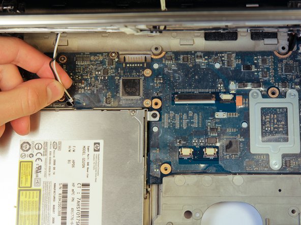

    • Locate the small white connector holding red, white, and black cables and pull it to the left to remove it from the clip.
    • Pull the clip to the left to remove it from the connector.
    • There may be a plastic film covering the motherboard. Start at the front right corner (as pictured) and peel the film off, leaving about one cm of the top, left edge attached.

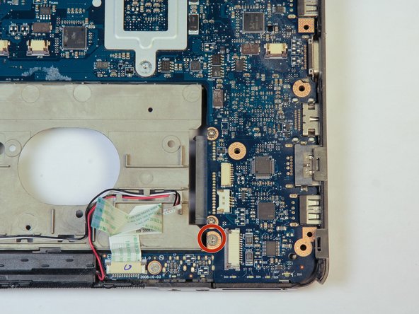

  29. HP Pavilion DV3 Heatsink/Fan Replacement: crwdns2935265:029crwdnd2935265:01crwdnd2935265:03crwdne2935265:0 HP Pavilion DV3 Heatsink/Fan Replacement: crwdns2935265:029crwdnd2935265:02crwdnd2935265:03crwdne2935265:0 HP Pavilion DV3 Heatsink/Fan Replacement: crwdns2935265:029crwdnd2935265:03crwdnd2935265:03crwdne2935265:0

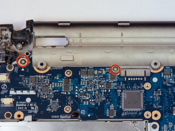

    • Locate and unscrew the three, silver, 3.5mm diameter head, 3mm long screws on the motherboard.
  30. HP Pavilion DV3 Heatsink/Fan Replacement: crwdns2935265:030crwdnd2935265:01crwdnd2935265:01crwdne2935265:0
    • Locate and remove the two black longscrews holding the CD drive. They will be 5 mm long and have a 3.5 mm diameter head.

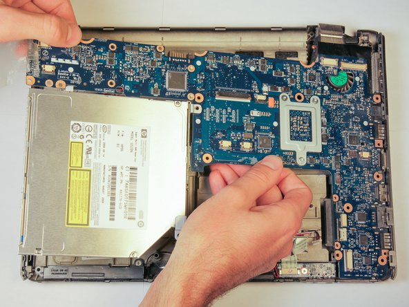

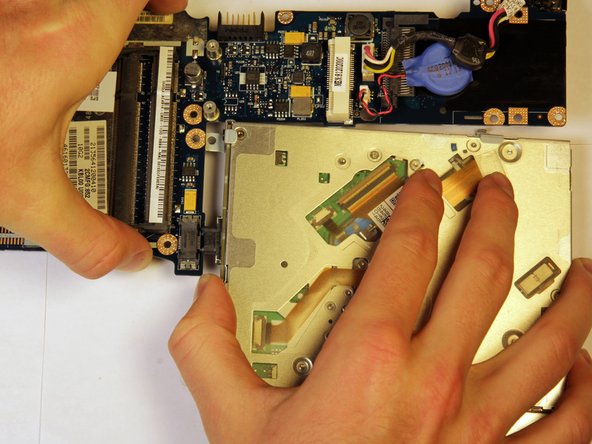

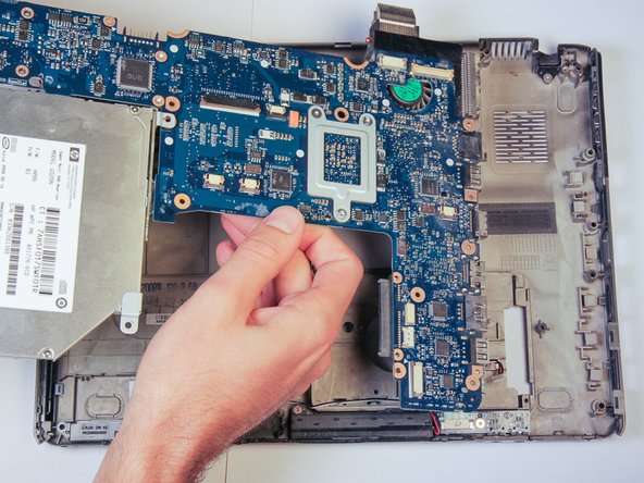

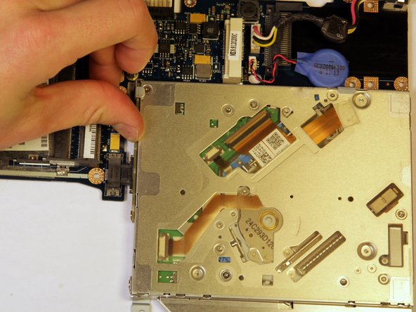

  31. HP Pavilion DV3 Heatsink/Fan Replacement: crwdns2935265:031crwdnd2935265:01crwdnd2935265:03crwdne2935265:0 HP Pavilion DV3 Heatsink/Fan Replacement: crwdns2935265:031crwdnd2935265:02crwdnd2935265:03crwdne2935265:0 HP Pavilion DV3 Heatsink/Fan Replacement: crwdns2935265:031crwdnd2935265:03crwdnd2935265:03crwdne2935265:0
    • The motherboard and CD drive need to come out at the same time because they are connected.
    • Lift from the top left side of the motherboard and the bottom right lip of the CD drive.
    • Lift the whole assembly up and slide it to the left to remove it from the laptop.
    • Move the bottom case out of the way and then turn the motherboard assembly over and set it down in front of you.
  32. HP Pavilion DV3 Heatsink/Fan Replacement: crwdns2935265:032crwdnd2935265:01crwdnd2935265:03crwdne2935265:0 HP Pavilion DV3 Heatsink/Fan Replacement: crwdns2935265:032crwdnd2935265:02crwdnd2935265:03crwdne2935265:0 HP Pavilion DV3 Heatsink/Fan Replacement: crwdns2935265:032crwdnd2935265:03crwdnd2935265:03crwdne2935265:0
    • Slide the CD drive to the right until it hits a stop.
    • Hold the drive down and lift the motherboard up and away from the drive.

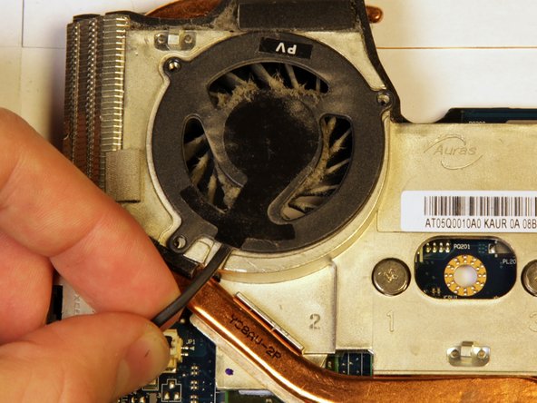

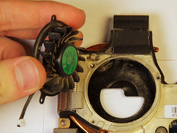

  33. HP Pavilion DV3 Heatsink/Fan Replacement: crwdns2935265:033crwdnd2935265:01crwdnd2935265:03crwdne2935265:0 HP Pavilion DV3 Heatsink/Fan Replacement: crwdns2935265:033crwdnd2935265:02crwdnd2935265:03crwdne2935265:0 HP Pavilion DV3 Heatsink/Fan Replacement: crwdns2935265:033crwdnd2935265:03crwdnd2935265:03crwdne2935265:0
    • Locate and remove the three 3.5 mm diameter and 2.5mm long screws holding the fan in place.
    • Locate the plug for the fan and pull up on it with your fingers to disconnect it.
    • Lift the fan out.
    • You are now ready to clean or replace the fan.

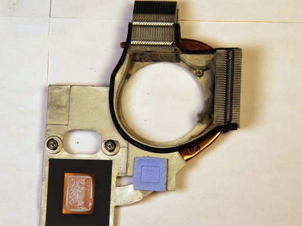

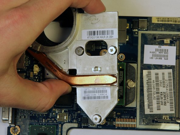

  34. HP Pavilion DV3 Heatsink/Fan Replacement: crwdns2935265:034crwdnd2935265:01crwdnd2935265:03crwdne2935265:0 HP Pavilion DV3 Heatsink/Fan Replacement: crwdns2935265:034crwdnd2935265:02crwdnd2935265:03crwdne2935265:0 HP Pavilion DV3 Heatsink/Fan Replacement: crwdns2935265:034crwdnd2935265:03crwdnd2935265:03crwdne2935265:0
    • Locate and unscrew the three large screws on the heatsink assembly. They will have a 3.5 mm diameter head and be 8 mm long.
    • Carefully remove the heatsink and set it upside down to avoid damaging the component.
    • Warning! Do not touch the thermal paste on the heatsink or processor. This is potentially hazardous.
