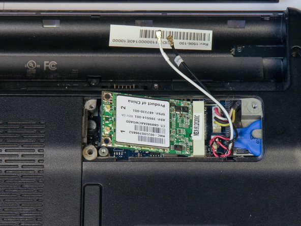

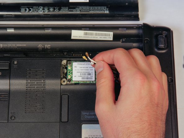

  5. HP Pavilion DV3 HP Pavilion Wireless Card Replacement: crwdns2935265:05crwdnd2935265:01crwdnd2935265:03crwdne2935265:0 HP Pavilion DV3 HP Pavilion Wireless Card Replacement: crwdns2935265:05crwdnd2935265:02crwdnd2935265:03crwdne2935265:0 HP Pavilion DV3 HP Pavilion Wireless Card Replacement: crwdns2935265:05crwdnd2935265:03crwdnd2935265:03crwdne2935265:0
    • Using your hand, pull the black and white antenna wires upwards.
    • This will disconnect the antenna wires from the card.
  6. HP Pavilion DV3 HP Pavilion Wireless Card Replacement: crwdns2935265:06crwdnd2935265:01crwdnd2935265:02crwdne2935265:0 HP Pavilion DV3 HP Pavilion Wireless Card Replacement: crwdns2935265:06crwdnd2935265:02crwdnd2935265:02crwdne2935265:0
    • Locate the two black screws connecting the wireless card to the laptop. They will have a 3.5 mm diameter head and be 4mm long. Remove the screws.
    • Once the screws are removed, the wireless card will pop up.

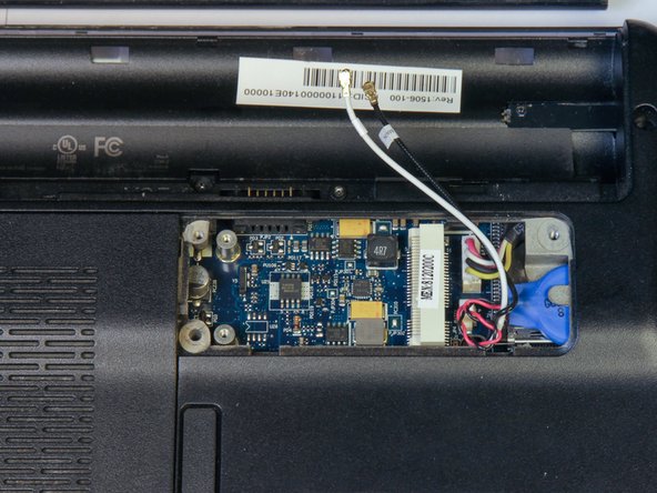

  7. HP Pavilion DV3 HP Pavilion Wireless Card Replacement: crwdns2935265:07crwdnd2935265:01crwdnd2935265:02crwdne2935265:0 HP Pavilion DV3 HP Pavilion Wireless Card Replacement: crwdns2935265:07crwdnd2935265:02crwdnd2935265:02crwdne2935265:0
    • Grab the sides of the wireless card and pull it up and to the left to disconnect from the laptop.
