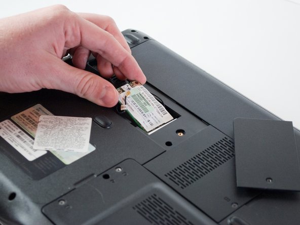

    • Start with the bottom of the laptop facing up.
    • Locate the small panel under the battery, which houses the wifi adapter, and unscrew the one 5mm Phillips #0 screw holding the panel in place.
    • Remove the panel and set it aside.
    • Be careful not to snap the 2 tabs on the sides of the panel when pulling it out.
  2. HP Pavilion DV2160BR Wifi Adapter Replacement: crwdns2935265:02crwdnd2935265:01crwdnd2935265:02crwdne2935265:0 HP Pavilion DV2160BR Wifi Adapter Replacement: crwdns2935265:02crwdnd2935265:02crwdnd2935265:02crwdne2935265:0
    • Unscrew the two 3mm Phillips #0 screw which is located at the corners of the wifi adapter.
  3. HP Pavilion DV2160BR Wifi Adapter Replacement: crwdns2935265:03crwdnd2935265:01crwdnd2935265:02crwdne2935265:0 HP Pavilion DV2160BR Wifi Adapter Replacement: crwdns2935265:03crwdnd2935265:02crwdnd2935265:02crwdne2935265:0
    • Pull the 2 black wires with the gold pieces out of the wifi adapter.
    • The wifi adapter is now free to be removed.
    • When reconnecting the wires for re-installing the wifi adapter, make sure the gold ends are rotated correctly to be properly pushed back in.
