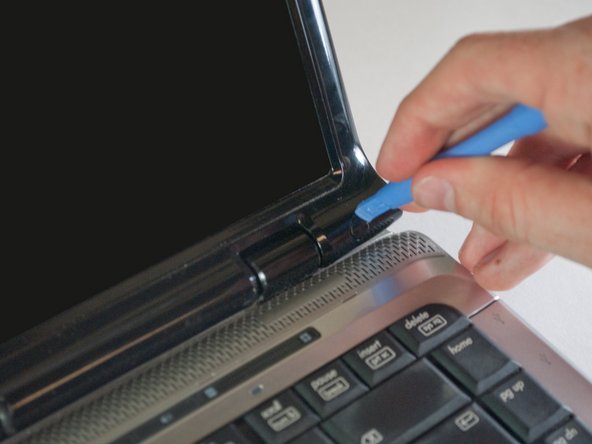

  4. HP Pavilion DV2160BR Webcam Replacement: crwdns2935265:04crwdnd2935265:01crwdnd2935265:02crwdne2935265:0 HP Pavilion DV2160BR Webcam Replacement: crwdns2935265:04crwdnd2935265:02crwdnd2935265:02crwdne2935265:0
    • Remove the 6 rubber screw covers from the screen panel using the plastic opener tools by applying firm pressure to the edges.
    • The 4 screw covers on top are attached by an adhesive backing.
    • The 2 screw covers on the bottom are rubber plugs.

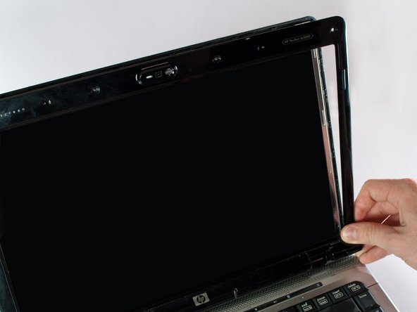

  6. HP Pavilion DV2160BR Webcam Replacement: crwdns2935265:06crwdnd2935265:01crwdnd2935265:02crwdne2935265:0 HP Pavilion DV2160BR Webcam Replacement: crwdns2935265:06crwdnd2935265:02crwdnd2935265:02crwdne2935265:0
    • Slide a plastic opener tool along the outside edges of the front screen panel to start to separate it from the back screen panel.
    • You may need to apply some firm pressure to get it started.
    • Once it has started to separate, gently pull off the screen panel by working along the edge, and set it aside.
