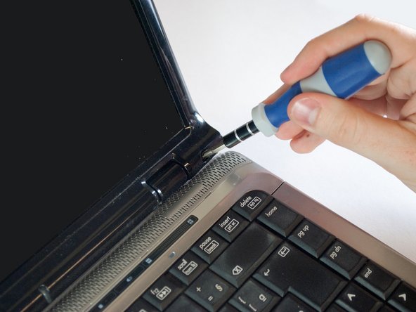

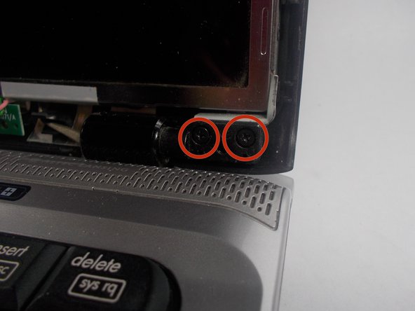

    • Remove the 6 rubber screw covers and screws, found around the edge of the laptop screen, surrounded in red and blue.
    • Use the plastic opener tools to remove the screw covers. Just apply firm pressure to the edges to pop the screw covers out, they are attached with a light adhesive.
    • There are four 2.5mm X 4mm-L Phillips #0 screws along the top.
    • There are two 2.5mm X 8mm-L Phillips #1 screws along the bottom.

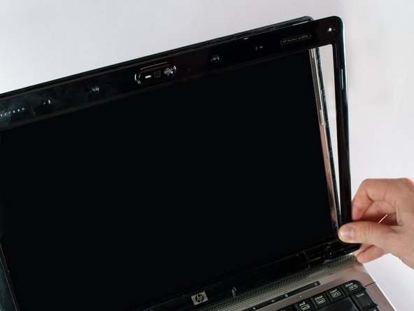

  5. HP Pavilion DV2160BR Screen Replacement: crwdns2935265:05crwdnd2935265:01crwdnd2935265:02crwdne2935265:0 HP Pavilion DV2160BR Screen Replacement: crwdns2935265:05crwdnd2935265:02crwdnd2935265:02crwdne2935265:0

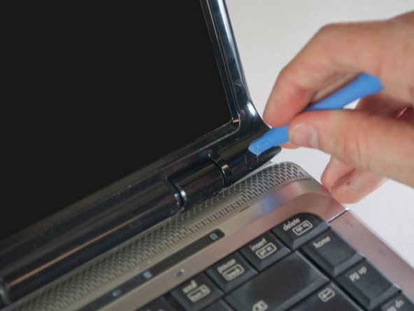

    • Now we must remove the plastic panel.
    • Slide a plastic opener tool along the outside edges of the front screen panel, separating it from the screen. You may need to apply some firm pressure.
    • Once the panel is separated from the screen, gently pull it off and set it aside.

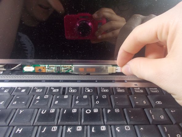

    • Locate the inverter at the bottom of the screen.
    • Disconnect the back light plug cable on the right side of the inverter by holding the inverter in place and pulling firmly on the connector.

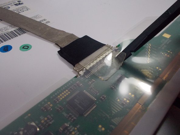

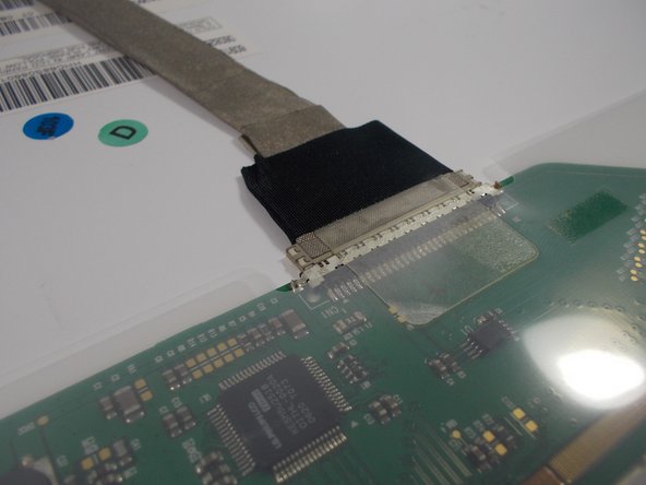

    • Now that the screen is placed face down onto the keyboard we are going to remove the wire connecting the screen to the device.
    • The wire is held on by an adhesive tape that must be lifted with the spudger tool.
    • Once the tape is lifted, slide your finger under and gently pull up the rest of the tape to free the wire.
    • Gently pull the wire towards the back of the device and the screen will now be free.

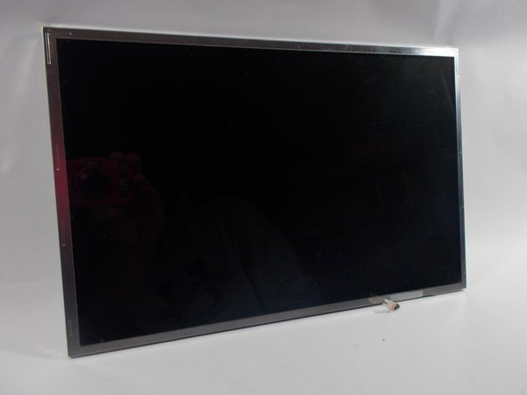

    • Finally we must remove the metal mounting hardware attached to the screen.
    • Remove the six 2mm X 3mm-L Phillips #0 screws.
    • There are three on each side of the display
    • Set aside the metal hardware and your display is now separated from the device!
