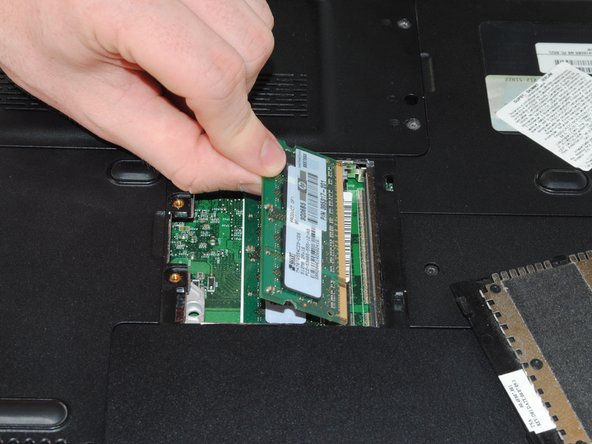

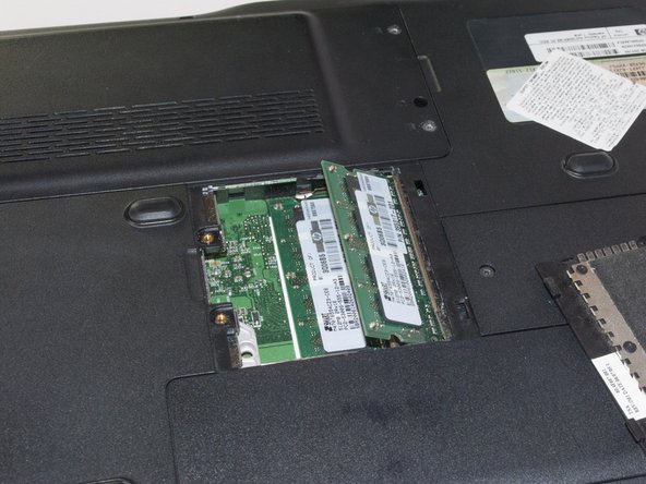

    • Start with the bottom of the laptop facing up.
    • Locate the panel that is covering the RAM compartment.
    • Unscrew the two 5mm Phillips #0 screws that are securing the RAM compartment.
  2. HP Pavilion DV2160BR RAM Replacement: crwdns2935265:02crwdnd2935265:01crwdnd2935265:02crwdne2935265:0 HP Pavilion DV2160BR RAM Replacement: crwdns2935265:02crwdnd2935265:02crwdnd2935265:02crwdne2935265:0
    • Lift up the panel that is by the end that held the screws. Set it aside.
  3. HP Pavilion DV2160BR RAM Replacement: crwdns2935265:03crwdnd2935265:01crwdnd2935265:03crwdne2935265:0 HP Pavilion DV2160BR RAM Replacement: crwdns2935265:03crwdnd2935265:02crwdnd2935265:03crwdne2935265:0 HP Pavilion DV2160BR RAM Replacement: crwdns2935265:03crwdnd2935265:03crwdnd2935265:03crwdne2935265:0
    • Using 2 prying tools, push the 2 buttons on the sides of one RAM module simultaneously, so that one side of the module pops up and out of the clips holding it down.
    • Grab the RAM module and carefully pull it straight out of its slot.
    • Repeat this step for the second RAM module, which is located just underneath the first RAM module.
