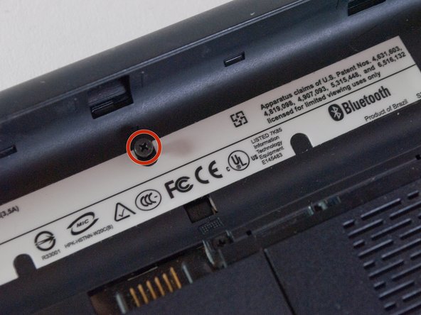

      • Start with the bottom of the laptop facing up.
    2. HP Pavilion DV2160BR Keyboard Replacement: crwdns2935265:02crwdnd2935265:01crwdnd2935265:02crwdne2935265:0 HP Pavilion DV2160BR Keyboard Replacement: crwdns2935265:02crwdnd2935265:02crwdnd2935265:02crwdne2935265:0

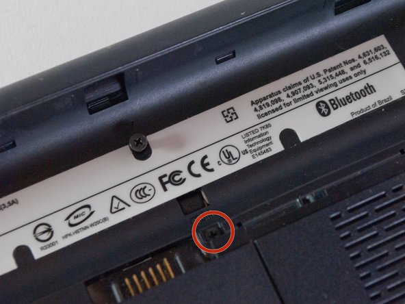

      • Locate the battery compartment at the rear of the device.
      • There is a slider button located under the left side of the battery compartment. It is indicated by a battery symbol. Move the slider to the left and lift the battery out.

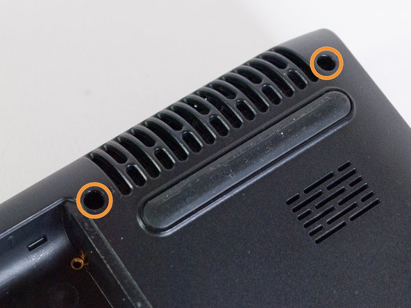

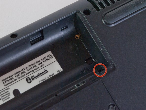

      • Unscrew the 5 screws along the top edge of the laptop’s back panel and inside the battery compartment.
      • The two screws inside the battery compartment are 5 mm Phillips #1.
      • The three screws outside the battery compartment are 9 mm Phillips #1.
