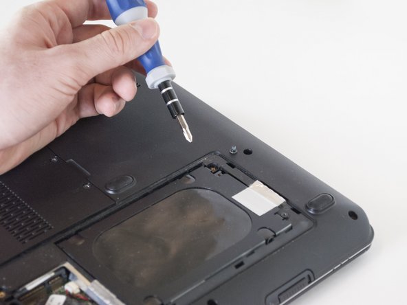

  3. HP Pavilion DV2160BR Hard Drive Replacement: crwdns2935265:03crwdnd2935265:01crwdnd2935265:02crwdne2935265:0 HP Pavilion DV2160BR Hard Drive Replacement: crwdns2935265:03crwdnd2935265:02crwdnd2935265:02crwdne2935265:0
    • Locate the second plastic panel covering the hard drive.
    • Unscrew the two 4mm Phillips #0 screws holding it in.
  4. HP Pavilion DV2160BR Hard Drive Replacement: crwdns2935265:04crwdnd2935265:01crwdnd2935265:01crwdne2935265:0
    • Lift up this internal panel using the plastic white tab and set it aside.

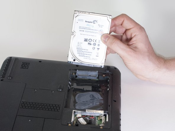

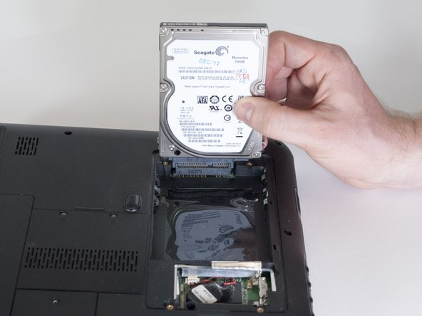

  5. HP Pavilion DV2160BR Hard Drive Replacement: crwdns2935265:05crwdnd2935265:01crwdnd2935265:03crwdne2935265:0 HP Pavilion DV2160BR Hard Drive Replacement: crwdns2935265:05crwdnd2935265:02crwdnd2935265:03crwdne2935265:0 HP Pavilion DV2160BR Hard Drive Replacement: crwdns2935265:05crwdnd2935265:03crwdnd2935265:03crwdne2935265:0
    • Grab the end of the hard drive and pull it up to a vertical position.
    • Gently slide the Hard Drive off of the SATA connector.
    • Warning: Don’t wiggle the SATA connector or the top piece will come off. If it does, reconnect it vertically.
