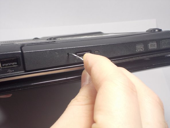

    • Locate the CD drive tray release hole on the front of the drive.
    • Straighten a paper clip and push it gently into the CD drive tray release hole.
    • The drive tray will pop open.
