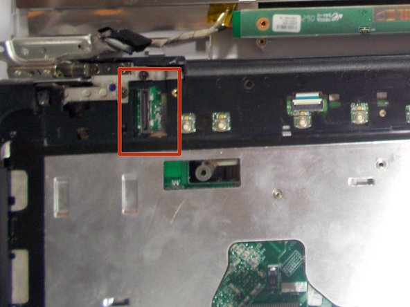

  12. HP Pavilion DV1000 Screen Replacement: crwdns2935265:012crwdnd2935265:01crwdnd2935265:01crwdne2935265:0
    • Remove the single screw marked in the image.
    • Be careful not to break the clips or pull any wires.

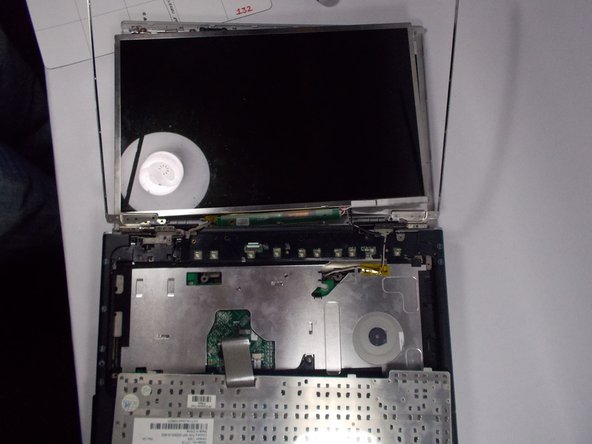

  13. HP Pavilion DV1000 Screen Replacement: crwdns2935265:013crwdnd2935265:01crwdnd2935265:03crwdne2935265:0 HP Pavilion DV1000 Screen Replacement: crwdns2935265:013crwdnd2935265:02crwdnd2935265:03crwdne2935265:0 HP Pavilion DV1000 Screen Replacement: crwdns2935265:013crwdnd2935265:03crwdnd2935265:03crwdne2935265:0
    • Remove the 4 screws marked in the picture.
    • Support the back cover and set it down on the desk. Do not pull off the back cover.

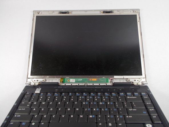

  14. HP Pavilion DV1000 Screen Replacement: crwdns2935265:014crwdnd2935265:01crwdnd2935265:02crwdne2935265:0 HP Pavilion DV1000 Screen Replacement: crwdns2935265:014crwdnd2935265:02crwdnd2935265:02crwdne2935265:0
    • Remove the screws on each side of the screen. There are four screws on each side.
    • Remove the screen.
