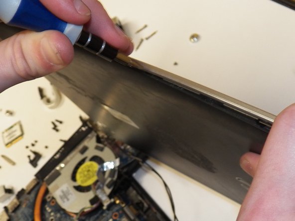

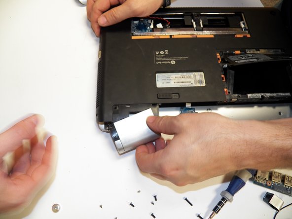

  12. HP Pavilion DM3-3010US Screen Replacement, Screen: crwdns2935265:012crwdnd2935265:01crwdnd2935265:03crwdne2935265:0 HP Pavilion DM3-3010US Screen Replacement, Screen: crwdns2935265:012crwdnd2935265:02crwdnd2935265:03crwdne2935265:0 HP Pavilion DM3-3010US Screen Replacement, Screen: crwdns2935265:012crwdnd2935265:03crwdnd2935265:03crwdne2935265:0
    • Release the hinges by removing the three Phillips PM2.5x7.0 screws and hinge covers that secure it to the base.
    • Before doing this, be sure all cables (WLAN, WWAN cables) are properly disconnected from the base enclosure. If not properly disconnected, lifting the display enclosure can damage the cords and other components.

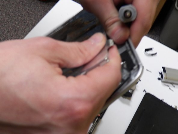

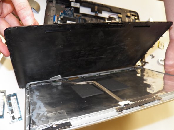

  13. HP Pavilion DM3-3010US Screen Replacement: crwdns2935265:013crwdnd2935265:01crwdnd2935265:03crwdne2935265:0 HP Pavilion DM3-3010US Screen Replacement: crwdns2935265:013crwdnd2935265:02crwdnd2935265:03crwdne2935265:0 HP Pavilion DM3-3010US Screen Replacement: crwdns2935265:013crwdnd2935265:03crwdnd2935265:03crwdne2935265:0
    • Remove the two rubber screw covers and the two Phillips PM2.0×4.0 screws at the bottom of the enclosure. This will give you access to the internal components.
    • To detach the display bezel, flex the inside edges on the top, bottom, left, and right sides until it is fully detached. Then, lift it away from the rest of the screen enclosure.

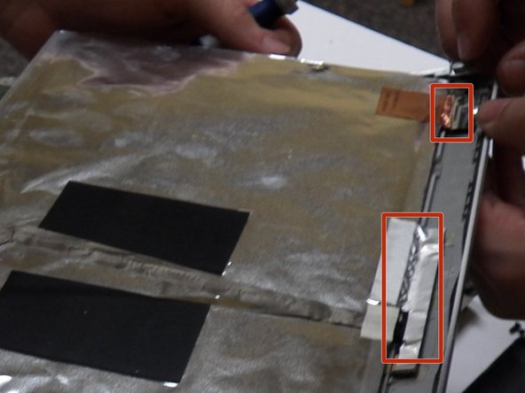

  14. HP Pavilion DM3-3010US Screen Replacement: crwdns2935265:014crwdnd2935265:01crwdnd2935265:03crwdne2935265:0 HP Pavilion DM3-3010US Screen Replacement: crwdns2935265:014crwdnd2935265:02crwdnd2935265:03crwdne2935265:0 HP Pavilion DM3-3010US Screen Replacement: crwdns2935265:014crwdnd2935265:03crwdnd2935265:03crwdne2935265:0
    • Next, remove the four Phillips 2.0×3.0 screws at each corner that secure the display panel to the enclosure. Then, you can remove the hinges on each side.
    • Remove the display panel cable by releasing the adhesive strip. Then, you can safely disconnect the display panel cable from its port.
