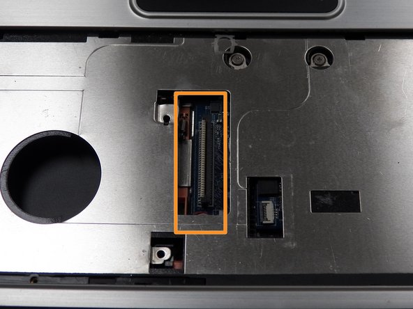

  4. HP Pavilion DM3-3010US Keyboard Replacement: crwdns2935265:04crwdnd2935265:01crwdnd2935265:02crwdne2935265:0 HP Pavilion DM3-3010US Keyboard Replacement: crwdns2935265:04crwdnd2935265:02crwdnd2935265:02crwdne2935265:0
    • Once the keyboard is completely detached, locate the ribbon housing inside the laptop.
    • Gently pull the ribbon cable from the connector housing.
