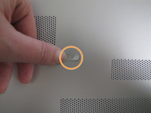

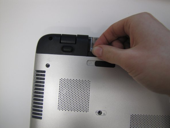

    • Close your laptop and turn it over so that the bottom is facing up.
  2. HP Pavilion 17-g119dx RAM Replacement: crwdns2935265:02crwdnd2935265:01crwdnd2935265:02crwdne2935265:0 HP Pavilion 17-g119dx RAM Replacement: crwdns2935265:02crwdnd2935265:02crwdnd2935265:02crwdne2935265:0
    • In the upper left hand corner, slide the bar with the lock icon to the right. This will unlock the battery.

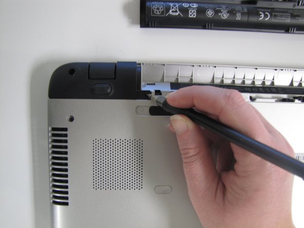

    • Slide the bar with the battery icon, on the right of your laptop, to the left to release the battery.
  4. HP Pavilion 17-g119dx RAM Replacement: crwdns2935265:04crwdnd2935265:01crwdnd2935265:02crwdne2935265:0 HP Pavilion 17-g119dx RAM Replacement: crwdns2935265:04crwdnd2935265:02crwdnd2935265:02crwdne2935265:0
    • Grab the battery and remove it from the laptop.

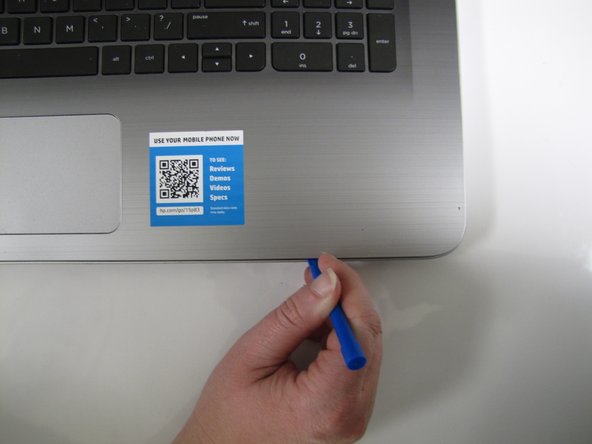

    • Remove the twenty 6.5mm screws using the Phillips #00 screwdriver.
    • Two of these 6.5mm screws are covered by a silver sticker. Remove the sticker by gently scraping your finger nail under the sticker and then remove the screws.

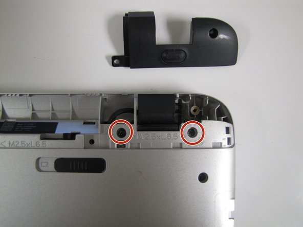

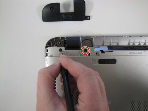

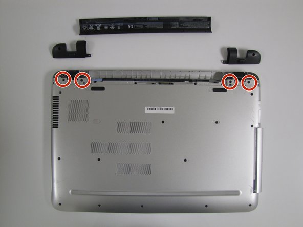

    • Remove the black corner covers on either side of the battery to reveal four additional 6.5mm Phillips #00 screws.
  7. HP Pavilion 17-g119dx RAM Replacement: crwdns2935265:07crwdnd2935265:01crwdnd2935265:03crwdne2935265:0 HP Pavilion 17-g119dx RAM Replacement: crwdns2935265:07crwdnd2935265:02crwdnd2935265:03crwdne2935265:0 HP Pavilion 17-g119dx RAM Replacement: crwdns2935265:07crwdnd2935265:03crwdnd2935265:03crwdne2935265:0
    • Remove the four 6.5mm Phillips #00 screws that were underneath the black corner covers.

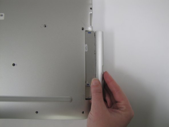

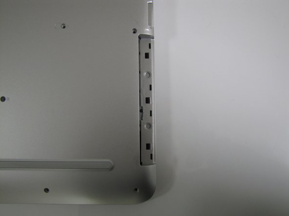

    • On the right-hand corner of the laptop, remove the CD-ROM by pressing the small button on the side. Pull it out of the laptop, and set it to the side.

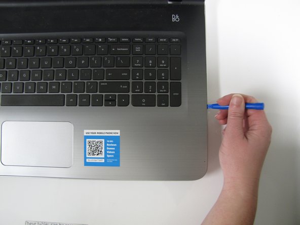

    • Use the Plastic Opening Tool to separate the face plate from the backing.

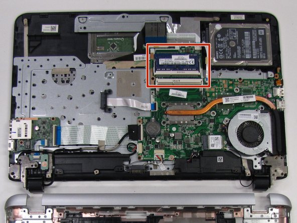

    • After running the Plastic Opening Tool along the sides, you can gently lift the keyboard up and on top of the screen to access the RAM.
    • The RAM will be located above the Motherboard and next to the Processor.

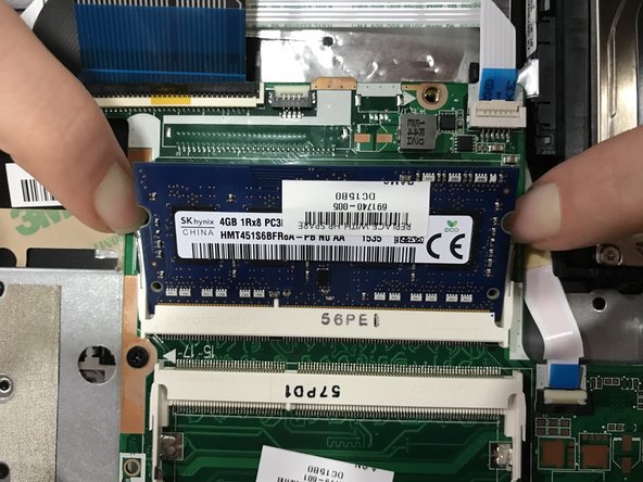

    • Release the RAM by pulling the two white levers away from the sides of the RAM.
  12. HP Pavilion 17-g119dx RAM Replacement: crwdns2935265:012crwdnd2935265:01crwdnd2935265:01crwdne2935265:0
    • Pull the RAM up and out of the laptop to remove it.
    • When reassembling, be sure to insert the RAM at the same angle it came out. Then push it down into place.
