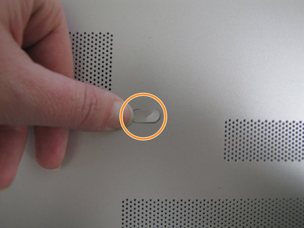

    • In the upper left hand corner, slide the bar with the lock icon to the right. This will unlock the battery.
  3. HP Pavilion 17-g119dx Fan Replacement: crwdns2935265:03crwdnd2935265:01crwdnd2935265:02crwdne2935265:0 HP Pavilion 17-g119dx Fan Replacement: crwdns2935265:03crwdnd2935265:02crwdnd2935265:02crwdne2935265:0

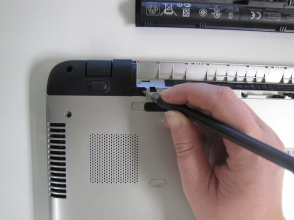

    • Slide the bar with the battery icon, on the right of your laptop, to the left to release the battery.
  4. HP Pavilion 17-g119dx Fan Replacement: crwdns2935265:04crwdnd2935265:01crwdnd2935265:02crwdne2935265:0 HP Pavilion 17-g119dx Fan Replacement: crwdns2935265:04crwdnd2935265:02crwdnd2935265:02crwdne2935265:0
    • Grab the battery and remove it from the laptop.

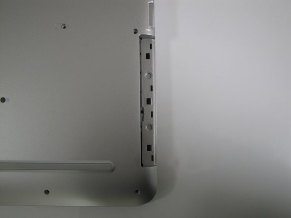

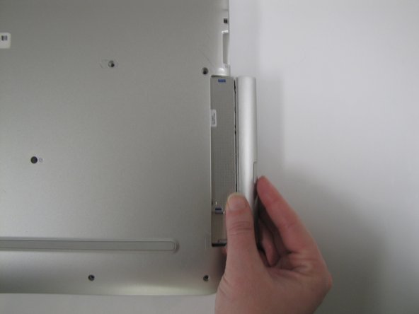

    • On the right-hand corner of the laptop, remove the CD-ROM by pressing the small button on the side. Pull it out of the laptop, and set it to the side.

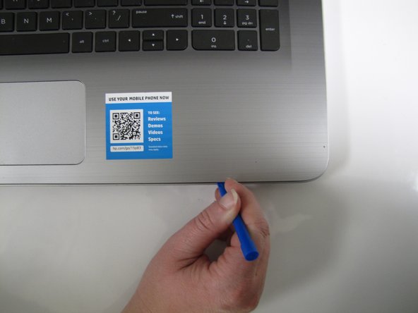

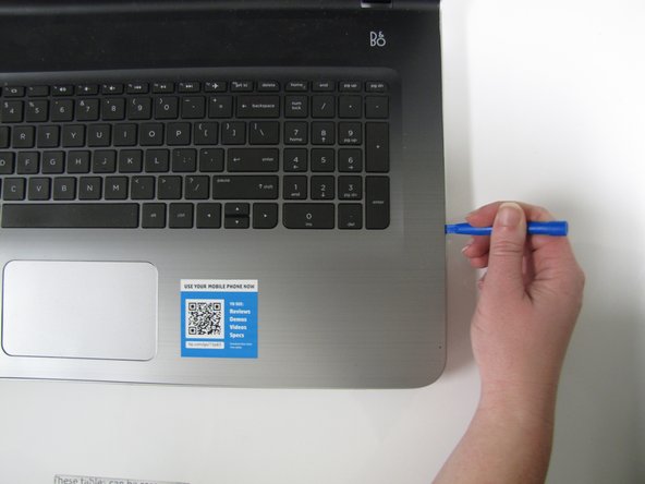

    • Use the Plastic Opening Tool to separate the face plate from the backing.
  10. HP Pavilion 17-g119dx Fan Replacement: crwdns2935265:010crwdnd2935265:01crwdnd2935265:02crwdne2935265:0 HP Pavilion 17-g119dx Fan Replacement: crwdns2935265:010crwdnd2935265:02crwdnd2935265:02crwdne2935265:0

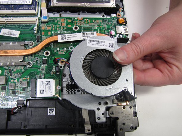

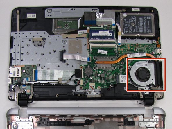

    • After running the opening tool along the sides, you can pop the keyboard open to access the fan.
    • The fan is located in the lower right corner and is next to the motherboard.

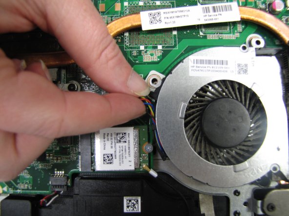

    • The fan is connected to the motherboard by a cable. To disconnect the fan, gently push in the sides of the connecter to lift the base of the cable out of the port.
