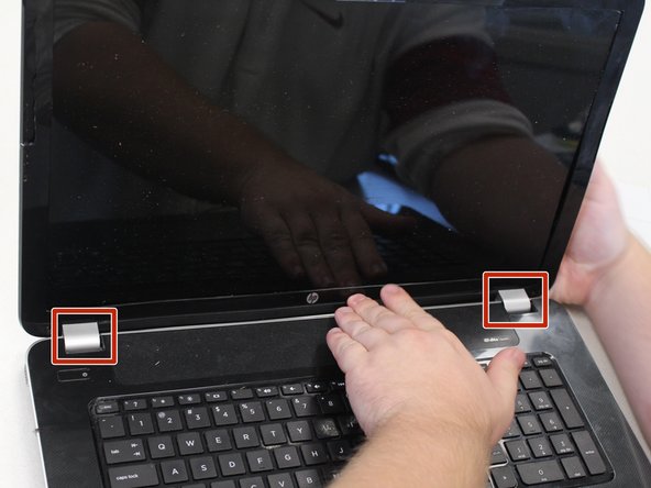

    3. HP Pavilion 17-e146us Screen Replacement: crwdns2935265:03crwdnd2935265:01crwdnd2935265:02crwdne2935265:0 HP Pavilion 17-e146us Screen Replacement: crwdns2935265:03crwdnd2935265:02crwdnd2935265:02crwdne2935265:0
      • Place a spudger or opening tool between the laptop screen and the plastic laptop frame.
      • Apply light pressure to the spudger to separate the plastic laptop frame covering the edges of the laptop screen.
      • These silver pieces cover the laptop hinges and will need to be removed as well.

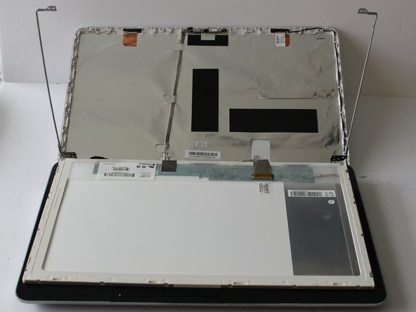

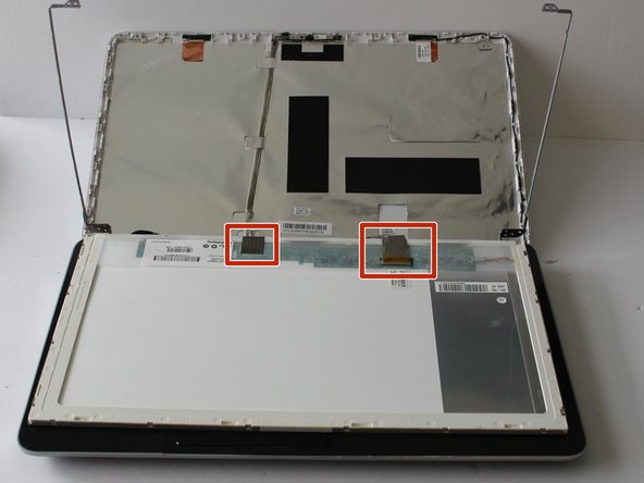

    6. HP Pavilion 17-e146us Screen Replacement: crwdns2935265:06crwdnd2935265:01crwdnd2935265:02crwdne2935265:0 HP Pavilion 17-e146us Screen Replacement: crwdns2935265:06crwdnd2935265:02crwdnd2935265:02crwdne2935265:0
      • Remove laptop screen.
      • While removing the laptop screen, be careful not to destroy the tape connection or break the motherboard.
