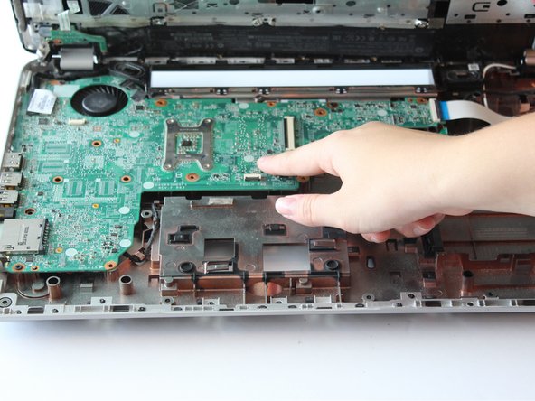

  11. HP Pavilion 17-e146us Motherboard Replacement, Motherboard: crwdns2935265:011crwdnd2935265:01crwdnd2935265:01crwdne2935265:0
    • Remove three 6.5 mm Phillips screws located underneath the keyboard using a Phillips #0 screwdriver.
  12. HP Pavilion 17-e146us Motherboard Replacement: crwdns2935265:012crwdnd2935265:01crwdnd2935265:01crwdne2935265:0
    • Place wedge tool in-between the front panel and the cover underneath the keyboard
    • Use wedge tool to pop the two covers apart.
    • This may require some force.
  13. HP Pavilion 17-e146us Motherboard Replacement: crwdns2935265:013crwdnd2935265:01crwdnd2935265:02crwdne2935265:0 HP Pavilion 17-e146us Motherboard Replacement: crwdns2935265:013crwdnd2935265:02crwdnd2935265:02crwdne2935265:0
    • Remove the motherboard using your hands
    • The motherboard is large green portion located inside the device
