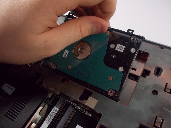

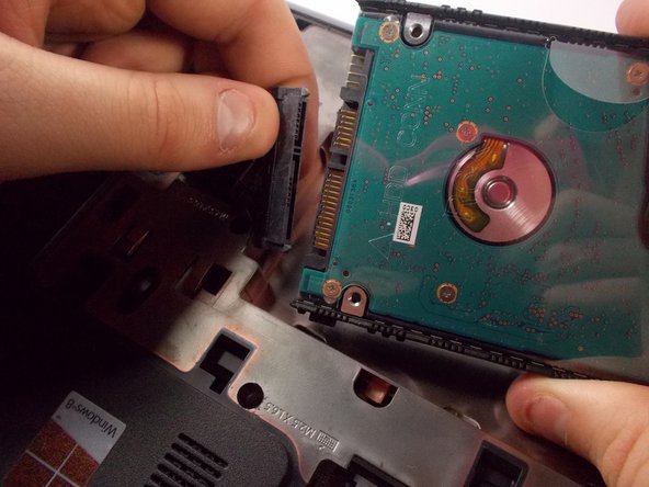

    1. HP Pavilion 17 TS Keyboard Replacement, Hard Drive: crwdns2935265:06crwdnd2935265:01crwdnd2935265:03crwdne2935265:0 HP Pavilion 17 TS Keyboard Replacement, Hard Drive: crwdns2935265:06crwdnd2935265:02crwdnd2935265:03crwdne2935265:0 HP Pavilion 17 TS Keyboard Replacement, Hard Drive: crwdns2935265:06crwdnd2935265:03crwdnd2935265:03crwdne2935265:0
      • Remove the two silver phillips screws from the hard drive.
      • Using the plastic tab, remove the hard drive from its socket.
      • Unplug the hard drive from the wire connecting it to the motherboard.
