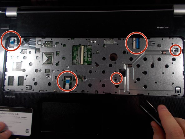

  7. HP Pavilion 17 TS Cooling Fan Replacement, Keyboard: crwdns2935265:07crwdnd2935265:01crwdnd2935265:03crwdne2935265:0 HP Pavilion 17 TS Cooling Fan Replacement, Keyboard: crwdns2935265:07crwdnd2935265:02crwdnd2935265:03crwdne2935265:0 HP Pavilion 17 TS Cooling Fan Replacement, Keyboard: crwdns2935265:07crwdnd2935265:03crwdnd2935265:03crwdne2935265:0
    • Unscrew each marked 9mm screw on the rear plate. This will allow you to pull the keyboard off.
    • With a pair of tweezers or other thin object, push in and slightly to the left (away from the disk drive compartment). On the face of the computer (the keyboard side), you will see part of the keyboard get pushed up. Using the spudger, wedge the keyboard and slide the spudger along all four corners.
    • If you meet alot of resistance, go back and make sure you have undone every screw marked with a keyboard symbol.
    • Once the keyboard has been popped out, using the tweezers, undo the latch locking the keyboard's ribbon cable in place. Then remove the keyboard.
  8. HP Pavilion 17 TS Cooling Fan Replacement, Front Cover: crwdns2935265:08crwdnd2935265:01crwdnd2935265:03crwdne2935265:0 HP Pavilion 17 TS Cooling Fan Replacement, Front Cover: crwdns2935265:08crwdnd2935265:02crwdnd2935265:03crwdne2935265:0 HP Pavilion 17 TS Cooling Fan Replacement, Front Cover: crwdns2935265:08crwdnd2935265:03crwdnd2935265:03crwdne2935265:0

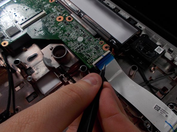

    • Using your tweezers, undo all ribbon cable you see where the keyboard was removed.
    • Remove all 9mm screws from the rear panel of your computer. They are marked red in the first picture.
    • Remove all 5mm screws from the rear panel of your computer. They are marked orange in the first picture.

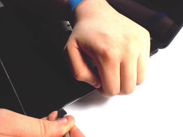

    • Using your fingers, push the bottom of the battery compartment out slightly, making a small gab in the face plate on the opposite side.
    • Using the spudger, undo all clips around the outer edge of the computer, popping the front face plate out of the enclosure. If you meet resistance, you most likely forgot to remove a screw, check for any that are still there, and remove them.
    • Once the front plate has been popped out, look close to make sure all connections are disconnected from it before pulling it away from the computer.

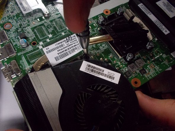

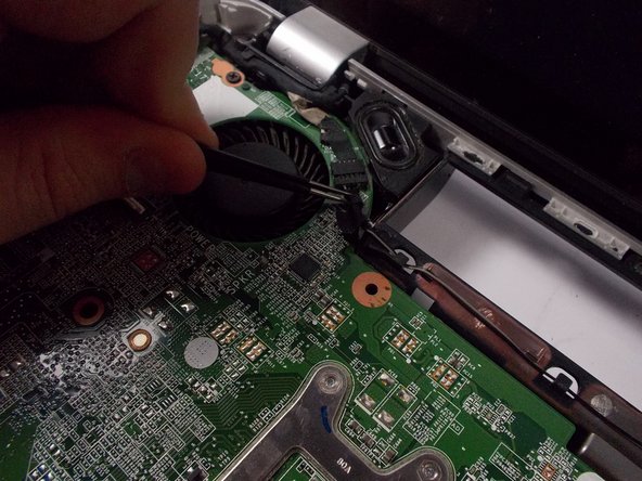

  9. HP Pavilion 17 TS Cooling Fan Replacement, Cooling Fan: crwdns2935265:09crwdnd2935265:01crwdnd2935265:03crwdne2935265:0 HP Pavilion 17 TS Cooling Fan Replacement, Cooling Fan: crwdns2935265:09crwdnd2935265:02crwdnd2935265:03crwdne2935265:0 HP Pavilion 17 TS Cooling Fan Replacement, Cooling Fan: crwdns2935265:09crwdnd2935265:03crwdnd2935265:03crwdne2935265:0
    • Unscrew each 9mm screw on the motherboard.
    • Unplug each ribbon cable connection to the motherboard. Also unplug every connector to the motherboard.
  10. HP Pavilion 17 TS Cooling Fan Replacement: crwdns2935265:010crwdnd2935265:01crwdnd2935265:02crwdne2935265:0 HP Pavilion 17 TS Cooling Fan Replacement: crwdns2935265:010crwdnd2935265:02crwdnd2935265:02crwdne2935265:0
    • Gently lift the mother board up and in the direction opposite the USB, VGA, and Fan.
    • Rotate the motherboard, and unscrew the fan on the bottom.
    • Remove the old fan, carefully scrape off the thermal paste from the CPU.
    • Apply a new layer of thermal paste to the CPU, and attach the new cooling fan.
