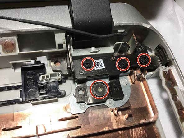

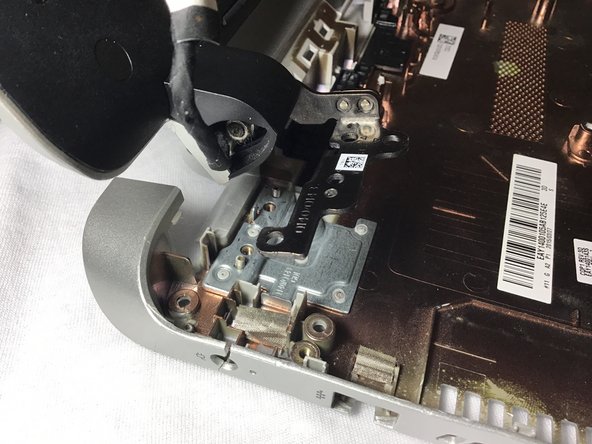

  19. HP Pavilion 15-p214dx Display Replacement, Display: crwdns2935265:019crwdnd2935265:01crwdnd2935265:03crwdne2935265:0 HP Pavilion 15-p214dx Display Replacement, Display: crwdns2935265:019crwdnd2935265:02crwdnd2935265:03crwdne2935265:0 HP Pavilion 15-p214dx Display Replacement, Display: crwdns2935265:019crwdnd2935265:03crwdnd2935265:03crwdne2935265:0
    • Dismount the display corners by removing the labeled 5.5 mm screws on the corners using a Philips #0 screwdriver to remove the screws.
  20. HP Pavilion 15-p214dx Display Replacement: crwdns2935265:020crwdnd2935265:01crwdnd2935265:02crwdne2935265:0 HP Pavilion 15-p214dx Display Replacement: crwdns2935265:020crwdnd2935265:02crwdnd2935265:02crwdne2935265:0
    • Notice after removing the screws the screen become able to move easily.

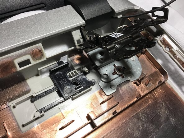

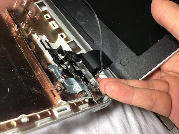

  21. HP Pavilion 15-p214dx Display Replacement: crwdns2935265:021crwdnd2935265:01crwdnd2935265:03crwdne2935265:0 HP Pavilion 15-p214dx Display Replacement: crwdns2935265:021crwdnd2935265:02crwdnd2935265:03crwdne2935265:0 HP Pavilion 15-p214dx Display Replacement: crwdns2935265:021crwdnd2935265:03crwdnd2935265:03crwdne2935265:0
    • Line up with the side of the laptop.
    • Push the hinges from left to right to unhook it from it's place.
    • Remove the screen from the device.
