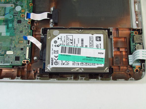

  8. HP Pavilion 15-p046nr Hard-Drive Replacement, Hard-Drive: crwdns2935265:08crwdnd2935265:01crwdnd2935265:03crwdne2935265:0 HP Pavilion 15-p046nr Hard-Drive Replacement, Hard-Drive: crwdns2935265:08crwdnd2935265:02crwdnd2935265:03crwdne2935265:0 HP Pavilion 15-p046nr Hard-Drive Replacement, Hard-Drive: crwdns2935265:08crwdnd2935265:03crwdnd2935265:03crwdne2935265:0

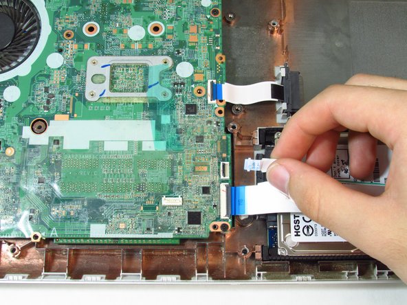

    • On the bottom right corner of the mother board, use the tip of the blue plastic opening tool to gently flip-up the grey locking flap of the bottom two ribbon cables.
    • Make sure to only lift the flap and not the connector socket because the socket easily breaks off.
    • Grab each ribbon cable cable and gently pull away from the socket.
    • To reinstall, insert the ribbon cable into the connector and close the flap on the black line.
    • Uncover the hard drive by moving the bottom ribbon cable to the far right.

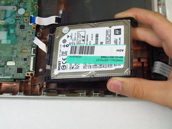

  9. HP Pavilion 15-p046nr Hard-Drive Replacement: crwdns2935265:09crwdnd2935265:01crwdnd2935265:02crwdne2935265:0 HP Pavilion 15-p046nr Hard-Drive Replacement: crwdns2935265:09crwdnd2935265:02crwdnd2935265:02crwdne2935265:0
    • Lift the hard drive directly up and away the device, unplugging it from the cable interface as it's removed.
    • You will most likely need to remove the rubber hard drive enclosure and place it around your new hard drive as you reinstall the new part.
