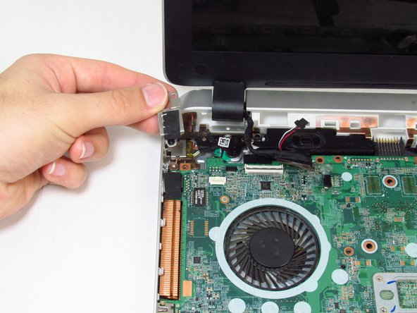

  11. HP Pavilion 15-p046nr Display Screen Replacement: crwdns2935265:011crwdnd2935265:01crwdnd2935265:01crwdne2935265:0
    • Remove all of the screws from the black hinge mounts on either side of the device using a Phillips #00 screwdriver.
  12. HP Pavilion 15-p046nr Display Screen Replacement: crwdns2935265:012crwdnd2935265:01crwdnd2935265:02crwdne2935265:0 HP Pavilion 15-p046nr Display Screen Replacement: crwdns2935265:012crwdnd2935265:02crwdnd2935265:02crwdne2935265:0
    • Carefully separate the top of the laptop and its hinges from the bottom half by pulling forward and up.
    • Ensure the wires protruding from the hinges do not get cut. You may need to maneuver the wires out of the way when separating the hinges.
    • Some force is required to pop the hinges out from the casing.
    • Remove the display from the device.

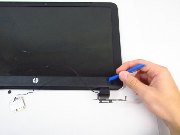

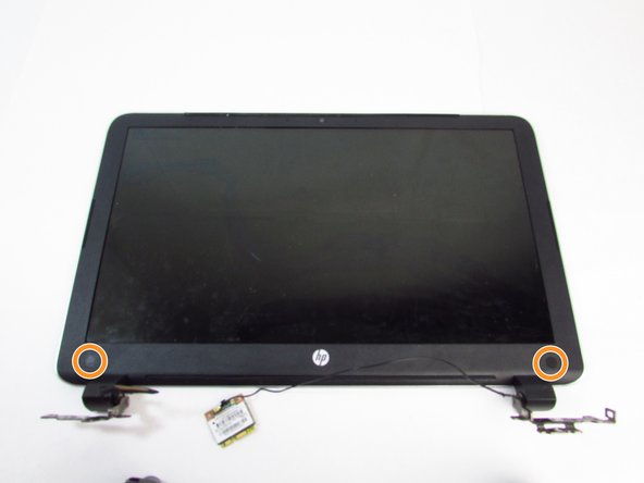

  13. HP Pavilion 15-p046nr Display Screen Replacement: crwdns2935265:013crwdnd2935265:01crwdnd2935265:03crwdne2935265:0 HP Pavilion 15-p046nr Display Screen Replacement: crwdns2935265:013crwdnd2935265:02crwdnd2935265:03crwdne2935265:0 HP Pavilion 15-p046nr Display Screen Replacement: crwdns2935265:013crwdnd2935265:03crwdnd2935265:03crwdne2935265:0
    • Use the blue plastic opening tool to remove the two small screw covers on the bottom corners of the display.
    • Remove the two 4 mm screws under each cover using the Phillips #00 screwdriver.

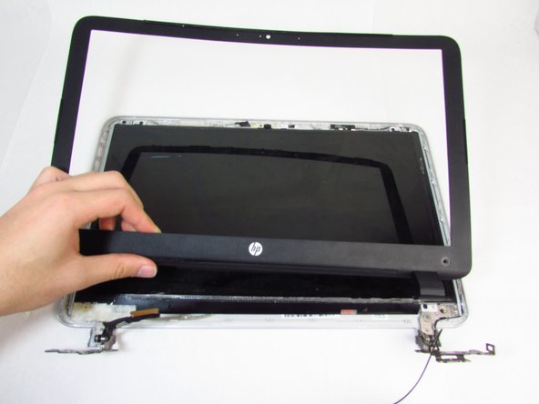

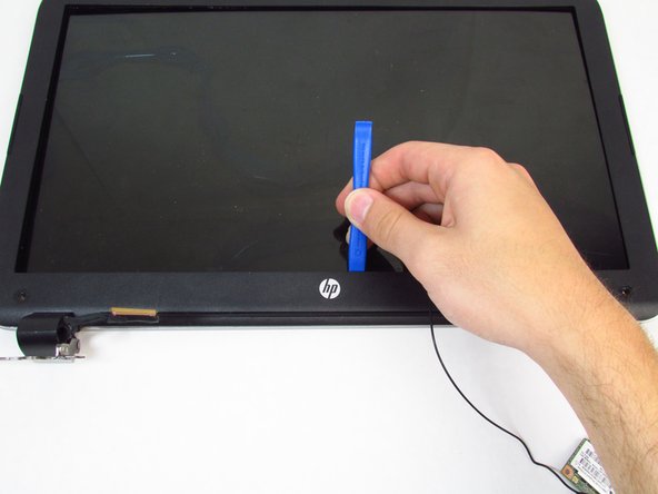

  14. HP Pavilion 15-p046nr Display Screen Replacement: crwdns2935265:014crwdnd2935265:01crwdnd2935265:03crwdne2935265:0 HP Pavilion 15-p046nr Display Screen Replacement: crwdns2935265:014crwdnd2935265:02crwdnd2935265:03crwdne2935265:0 HP Pavilion 15-p046nr Display Screen Replacement: crwdns2935265:014crwdnd2935265:03crwdnd2935265:03crwdne2935265:0
    • Use the tip of the blue plastic opening tool to separate the outer edge of the screen from the laptop.
    • It may be easier to use the opening tool on both the inside and outside perimeter of the cover. Be sure to go around all edges before lifting the outer edge off.
    • Remove the display screen cover from the device.

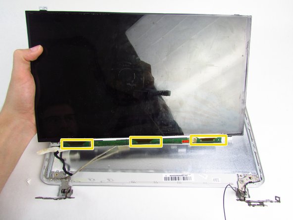

  15. HP Pavilion 15-p046nr Display Screen Replacement: crwdns2935265:015crwdnd2935265:01crwdnd2935265:03crwdne2935265:0 HP Pavilion 15-p046nr Display Screen Replacement: crwdns2935265:015crwdnd2935265:02crwdnd2935265:03crwdne2935265:0 HP Pavilion 15-p046nr Display Screen Replacement: crwdns2935265:015crwdnd2935265:03crwdnd2935265:03crwdne2935265:0
    • Remove the two 2 mm screws from around the display using the Phillips #00 screwdriver.
    • Remove two 1.5 mm screws from around the display using the Phillips #00 screwdriver.
    • Carefully peel off the tape at the bottom of the screen to separate the green chip from the screen.
    • Remove the screen from the display.

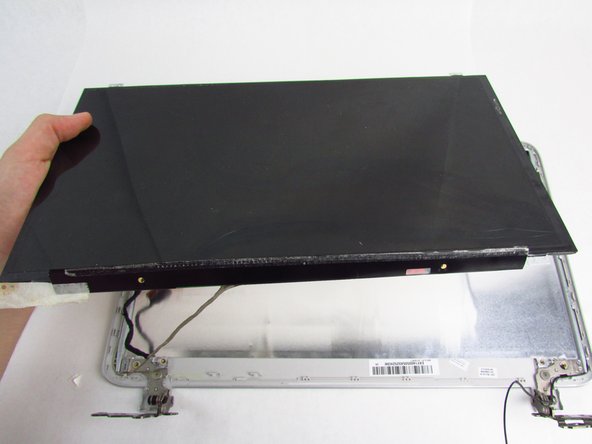

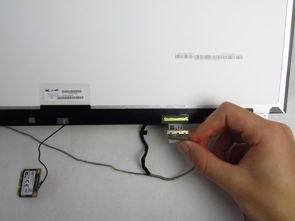

  16. HP Pavilion 15-p046nr Display Screen Replacement: crwdns2935265:016crwdnd2935265:01crwdnd2935265:03crwdne2935265:0 HP Pavilion 15-p046nr Display Screen Replacement: crwdns2935265:016crwdnd2935265:02crwdnd2935265:03crwdne2935265:0 HP Pavilion 15-p046nr Display Screen Replacement: crwdns2935265:016crwdnd2935265:03crwdnd2935265:03crwdne2935265:0
    • Flip the screen over so that the screen is face down.
    • Remove white video chip from screen by peeling off the tape and gently pulling on the white cable.
    • Be careful not to yank or jerk the cables because they can be easily broken.
    • Remove the screen.
