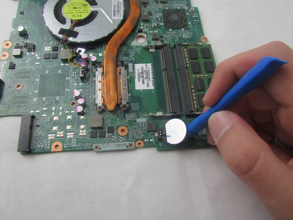

  14. HP Pavilion 15-p046nr CMOS Battery Replacement, CMOS Battery: crwdns2935265:014crwdnd2935265:01crwdnd2935265:01crwdne2935265:0
    • Flip the motherboard over to reveal the backside.
  15. HP Pavilion 15-p046nr CMOS Battery Replacement: crwdns2935265:015crwdnd2935265:01crwdnd2935265:03crwdne2935265:0 HP Pavilion 15-p046nr CMOS Battery Replacement: crwdns2935265:015crwdnd2935265:02crwdnd2935265:03crwdne2935265:0 HP Pavilion 15-p046nr CMOS Battery Replacement: crwdns2935265:015crwdnd2935265:03crwdnd2935265:03crwdne2935265:0
    • Push the blue plastic opening tool into the CMOS battery casing along the groove towards the center of the motherboard. The battery should shift to the left.
    • Do not use a metal tool since it can cause damage to the delicate motherboard and its components or puncture the battery.
    • Lift upwards on the CMOS battery using the opening tool and the battery will pop out of its holding.
    • Remove the CMOS battery from the motherboard.
