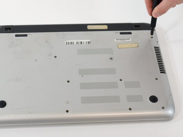

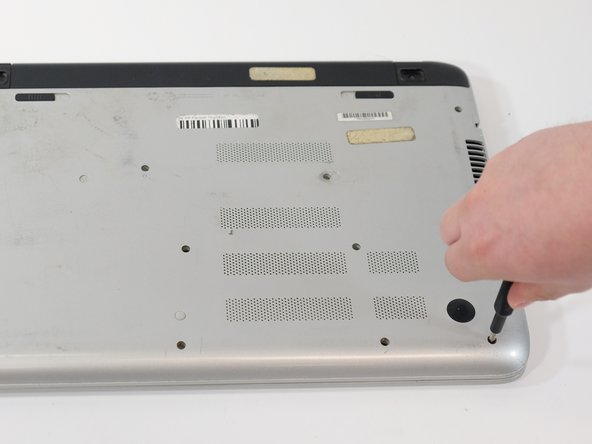

  4. HP Pavilion 15-p043cl Wi-Fi Card Replacement, Wi-Fi Card: crwdns2935265:04crwdnd2935265:01crwdnd2935265:03crwdne2935265:0 HP Pavilion 15-p043cl Wi-Fi Card Replacement, Wi-Fi Card: crwdns2935265:04crwdnd2935265:02crwdnd2935265:03crwdne2935265:0 HP Pavilion 15-p043cl Wi-Fi Card Replacement, Wi-Fi Card: crwdns2935265:04crwdnd2935265:03crwdnd2935265:03crwdne2935265:0
    • Flip laptop to make the backplate face up.
    • Use a #1 Phillips-head screwdriver to unscrew all eleven 8 mm bottom case screws.

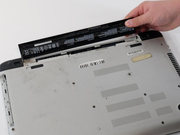

  5. HP Pavilion 15-p043cl Wi-Fi Card Replacement: crwdns2935265:05crwdnd2935265:01crwdnd2935265:02crwdne2935265:0 HP Pavilion 15-p043cl Wi-Fi Card Replacement: crwdns2935265:05crwdnd2935265:02crwdnd2935265:02crwdne2935265:0
    • Pull out the battery by positioning the switch with the lock symbol on unlock and pushing the switch with the battery towards the center of the laptop

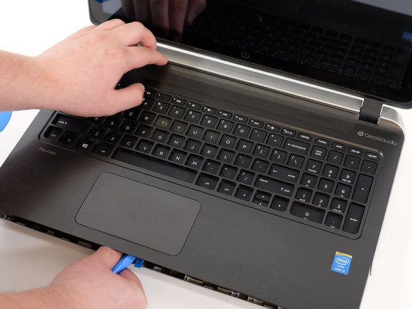

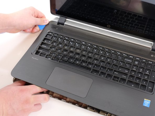

    • Flip over the laptop so the HP symbol is facing up.
    • Open the lid of the laptop.
    • Using the spudger, pry between the case and keyboard/mousepad area.

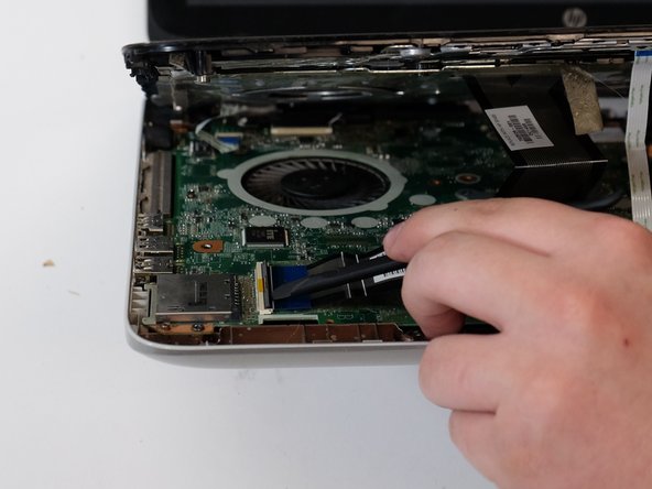

  7. HP Pavilion 15-p043cl Wi-Fi Card Replacement: crwdns2935265:07crwdnd2935265:01crwdnd2935265:03crwdne2935265:0 HP Pavilion 15-p043cl Wi-Fi Card Replacement: crwdns2935265:07crwdnd2935265:02crwdnd2935265:03crwdne2935265:0 HP Pavilion 15-p043cl Wi-Fi Card Replacement: crwdns2935265:07crwdnd2935265:03crwdnd2935265:03crwdne2935265:0
    • Carefully remove the keyboard area.
    • Make sure to unplug the 3 ribbon cables connecting the keyboard, mousepad and power button to the motherboard.

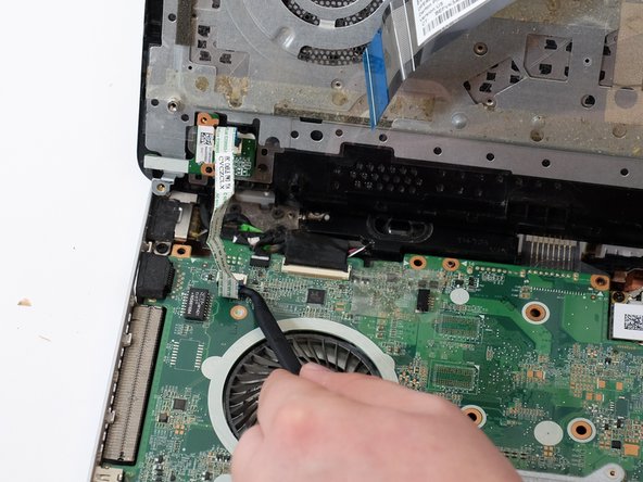

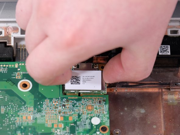

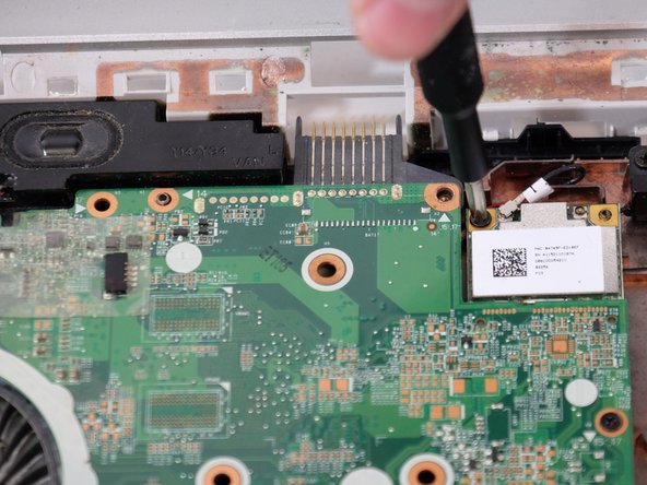

  8. HP Pavilion 15-p043cl Wi-Fi Card Replacement: crwdns2935265:08crwdnd2935265:01crwdnd2935265:03crwdne2935265:0 HP Pavilion 15-p043cl Wi-Fi Card Replacement: crwdns2935265:08crwdnd2935265:02crwdnd2935265:03crwdne2935265:0 HP Pavilion 15-p043cl Wi-Fi Card Replacement: crwdns2935265:08crwdnd2935265:03crwdnd2935265:03crwdne2935265:0
    • Unplug the black and white wires from the Wi-Fi card.
    • Unscrew the 4 mm screw holding the Wi-Fi card in place.
    • Gently pull up and away from the motherboard to pop out the card.
