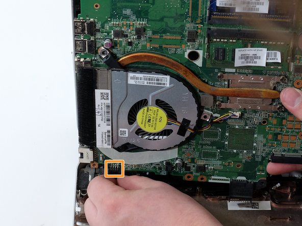

  8. HP Pavilion 15-p043cl Repair RAM Replacement: crwdns2935265:08crwdnd2935265:01crwdnd2935265:02crwdne2935265:0 HP Pavilion 15-p043cl Repair RAM Replacement: crwdns2935265:08crwdnd2935265:02crwdnd2935265:02crwdne2935265:0
    • Remove the remaining ribbon cables.
    • Remove the connection to the HDMI port.

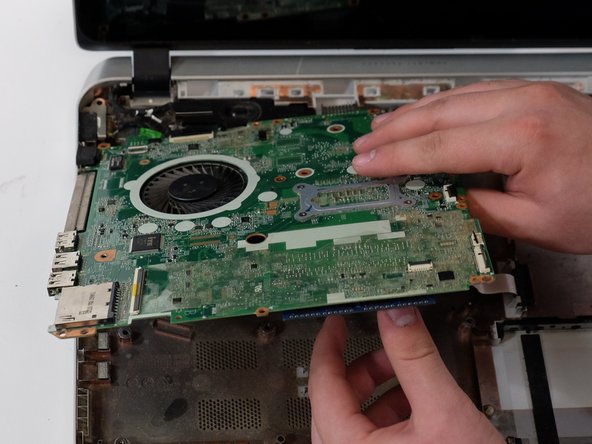

  9. HP Pavilion 15-p043cl Repair RAM Replacement: crwdns2935265:09crwdnd2935265:01crwdnd2935265:03crwdne2935265:0 HP Pavilion 15-p043cl Repair RAM Replacement: crwdns2935265:09crwdnd2935265:02crwdnd2935265:03crwdne2935265:0 HP Pavilion 15-p043cl Repair RAM Replacement: crwdns2935265:09crwdnd2935265:03crwdnd2935265:03crwdne2935265:0
    • Remove the remaining motherboard screws.
    • Gently lift the motherboard up, towards the screen of the laptop. Remove the remaining display connector.

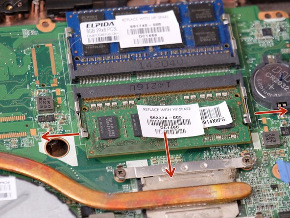

  10. HP Pavilion 15-p043cl Repair RAM Replacement: crwdns2935265:010crwdnd2935265:01crwdnd2935265:02crwdne2935265:0 HP Pavilion 15-p043cl Repair RAM Replacement: crwdns2935265:010crwdnd2935265:02crwdnd2935265:02crwdne2935265:0
    • Locate the RAM.
    • Pull the metal tabs to the side while pulling the RAM module out and slightly up.
