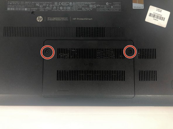

  3. HP Pavilion 15-n232nr RAM Replacement, RAM: crwdns2935265:03crwdnd2935265:01crwdnd2935265:02crwdne2935265:0 HP Pavilion 15-n232nr RAM Replacement, RAM: crwdns2935265:03crwdnd2935265:02crwdnd2935265:02crwdne2935265:0
    • Loosen the two 6 mm Phillips #1 screws on the back panel.
    • These screws do not detach from back panel.

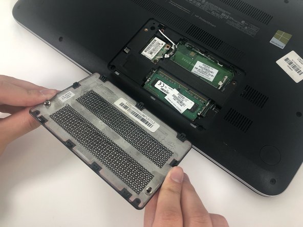

  4. HP Pavilion 15-n232nr RAM Replacement: crwdns2935265:04crwdnd2935265:01crwdnd2935265:02crwdne2935265:0 HP Pavilion 15-n232nr RAM Replacement: crwdns2935265:04crwdnd2935265:02crwdnd2935265:02crwdne2935265:0
    • Use the iFixit opening tool to remove the back panel.

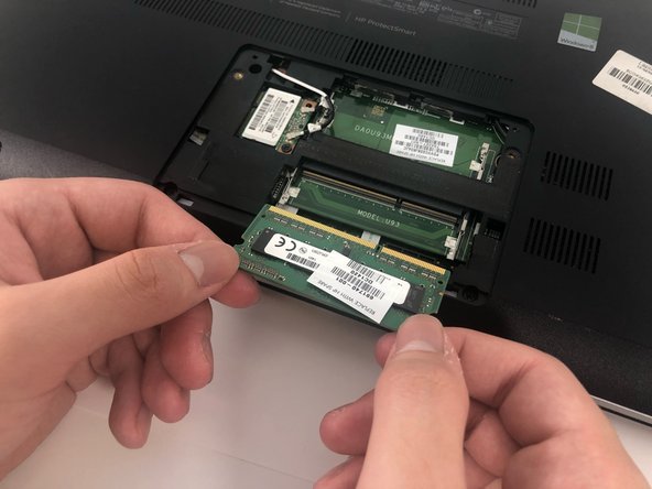

  5. HP Pavilion 15-n232nr RAM Replacement: crwdns2935265:05crwdnd2935265:01crwdnd2935265:02crwdne2935265:0 HP Pavilion 15-n232nr RAM Replacement: crwdns2935265:05crwdnd2935265:02crwdnd2935265:02crwdne2935265:0
    • Release the clips securing the RAM by slightly bending them until the RAM is free.
