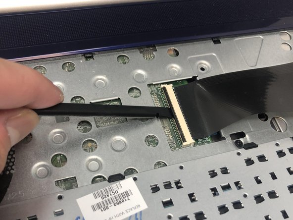

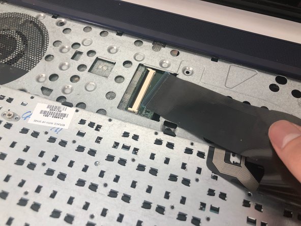

  6. HP Pavilion 15-n232nr Hard Drive Replacement: crwdns2935265:06crwdnd2935265:01crwdnd2935265:03crwdne2935265:0 HP Pavilion 15-n232nr Hard Drive Replacement: crwdns2935265:06crwdnd2935265:02crwdnd2935265:03crwdne2935265:0 HP Pavilion 15-n232nr Hard Drive Replacement: crwdns2935265:06crwdnd2935265:03crwdnd2935265:03crwdne2935265:0
    • Flip the keyboard out and locate the connector.
    • Use the spudger to unhinge the the fastener and remove the connector.
    • Keyboard should be completely detached after this step.

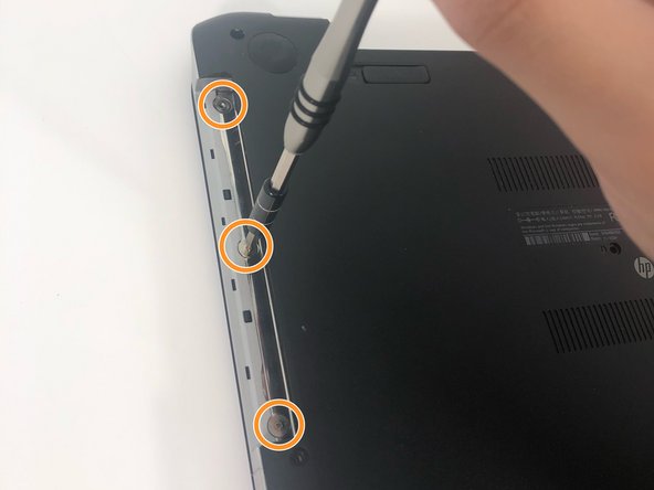

  9. HP Pavilion 15-n232nr Hard Drive Replacement, Hard Drive: crwdns2935265:09crwdnd2935265:01crwdnd2935265:02crwdne2935265:0 HP Pavilion 15-n232nr Hard Drive Replacement, Hard Drive: crwdns2935265:09crwdnd2935265:02crwdnd2935265:02crwdne2935265:0
    • The battery and optical drive should be removed at this point in the process.
    • Remove the ten 6 mm Phillips #1 screws.
    • Remove the three 1 mm Phillips #000 screws.

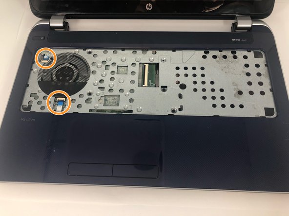

  10. HP Pavilion 15-n232nr Hard Drive Replacement: crwdns2935265:010crwdnd2935265:01crwdnd2935265:02crwdne2935265:0 HP Pavilion 15-n232nr Hard Drive Replacement: crwdns2935265:010crwdnd2935265:02crwdnd2935265:02crwdne2935265:0
    • Remove the five 2.5mm Phillips #1 screws.
    • Use the spudger to unhinge the cable connectors. Use tweezers to complete removal.

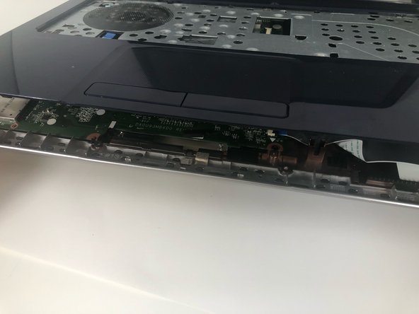

  11. HP Pavilion 15-n232nr Hard Drive Replacement: crwdns2935265:011crwdnd2935265:01crwdnd2935265:03crwdne2935265:0 HP Pavilion 15-n232nr Hard Drive Replacement: crwdns2935265:011crwdnd2935265:02crwdnd2935265:03crwdne2935265:0 HP Pavilion 15-n232nr Hard Drive Replacement: crwdns2935265:011crwdnd2935265:03crwdnd2935265:03crwdne2935265:0
    • Carefully use the iFixit opening tool to release the front panel.

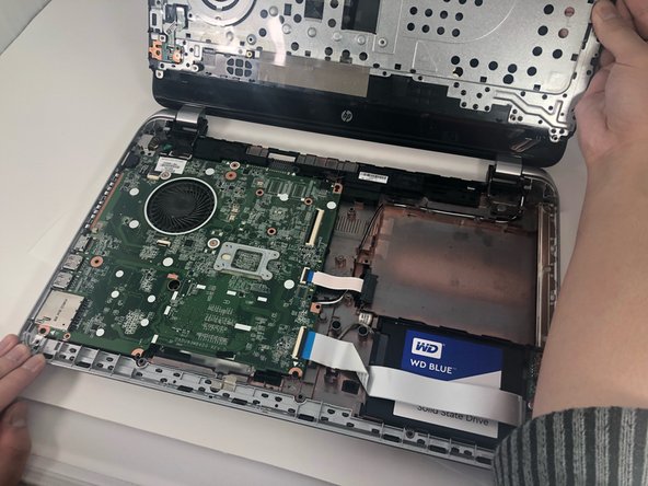

  14. HP Pavilion 15-n232nr Hard Drive Replacement: crwdns2935265:014crwdnd2935265:01crwdnd2935265:03crwdne2935265:0 HP Pavilion 15-n232nr Hard Drive Replacement: crwdns2935265:014crwdnd2935265:02crwdnd2935265:03crwdne2935265:0 HP Pavilion 15-n232nr Hard Drive Replacement: crwdns2935265:014crwdnd2935265:03crwdnd2935265:03crwdne2935265:0
    • Use the iFixit opening tool to remove the hard drive connector.
    • Remove the hard drive by lifting the right side and pulling it out.
