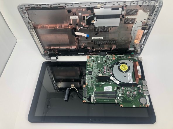

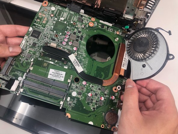

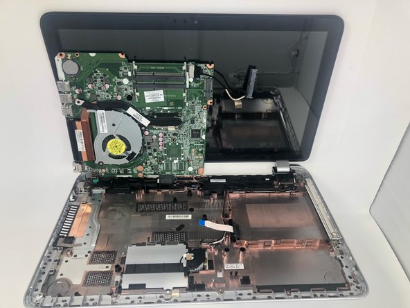

  18. HP Pavilion 15-n232nr Cooling Fan Replacement, Cooling Fan: crwdns2935265:018crwdnd2935265:01crwdnd2935265:03crwdne2935265:0 HP Pavilion 15-n232nr Cooling Fan Replacement, Cooling Fan: crwdns2935265:018crwdnd2935265:02crwdnd2935265:03crwdne2935265:0 HP Pavilion 15-n232nr Cooling Fan Replacement, Cooling Fan: crwdns2935265:018crwdnd2935265:03crwdnd2935265:03crwdne2935265:0
    • Remove the four 6 mm Phillips #1 screws.
    • Turn over the laptop to have easier access to the cooling fan.

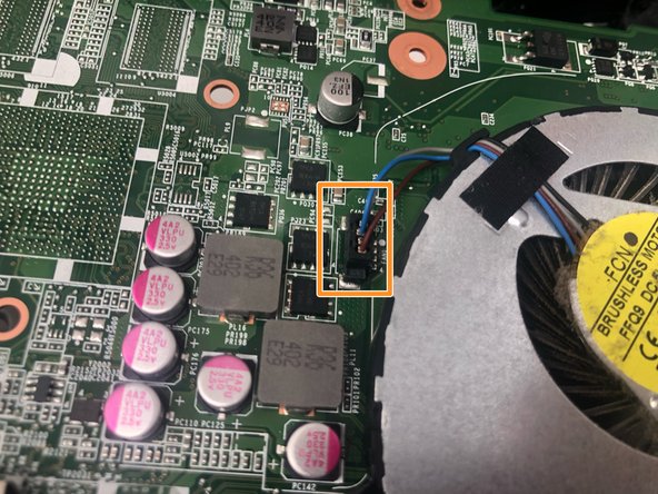

  19. HP Pavilion 15-n232nr Cooling Fan Replacement: crwdns2935265:019crwdnd2935265:01crwdnd2935265:03crwdne2935265:0 HP Pavilion 15-n232nr Cooling Fan Replacement: crwdns2935265:019crwdnd2935265:02crwdnd2935265:03crwdne2935265:0 HP Pavilion 15-n232nr Cooling Fan Replacement: crwdns2935265:019crwdnd2935265:03crwdnd2935265:03crwdne2935265:0
    • Unscrew the two 4 mm Phillips #1 screws.
    • Disconnect the cord for the cooling fan.
    • Carefully lift the cooling fan from the motherboard.
