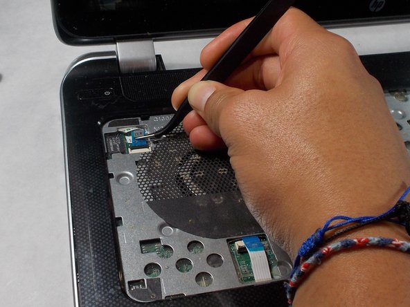

  7. HP Pavilion 15-n210dx Speaker Replacement: crwdns2935265:07crwdnd2935265:01crwdnd2935265:02crwdne2935265:0 HP Pavilion 15-n210dx Speaker Replacement: crwdns2935265:07crwdnd2935265:02crwdnd2935265:02crwdne2935265:0
    • Lift up flaps to disconnect the blue connectors.
    • You can use your fingers or a tweezer to lift up the flap.

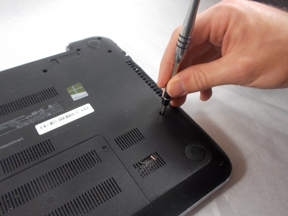

    • Using the Phillips #0 screwdriver, remove twelve (12) screws from the back panel.

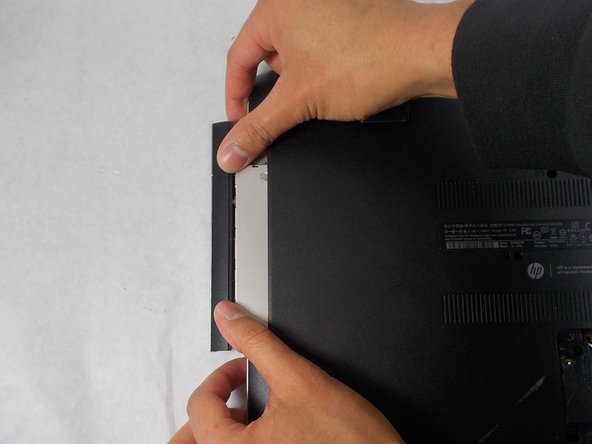

    • Remove the optic drive by pushing the flap with your thumbs. Once enough of the optic drive is exposed for fingers to grasp it, remove it entirely by using your hand.
    • A spudger can assist in initiating the separation. Insert the spudger between where the flap meets the body of the computer and push the spudger against the flap.

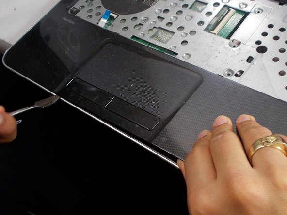

    • Insert a medal spudger between where the black plastic meets the silver plastic to loosing and eventually separate the two plastic parts.
    • Slide the spudger along where the two plastics meet to increase the separation. Use your other hand to stabilize the computer.
    • Avoid using the metal spudger unless for serious prying power. If used incorrectly, the metal spudger may damage the internal components of your device.

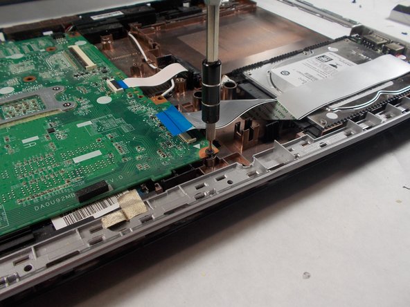

    • Using the Phillips #0 screwdriver, remove the four black screws.

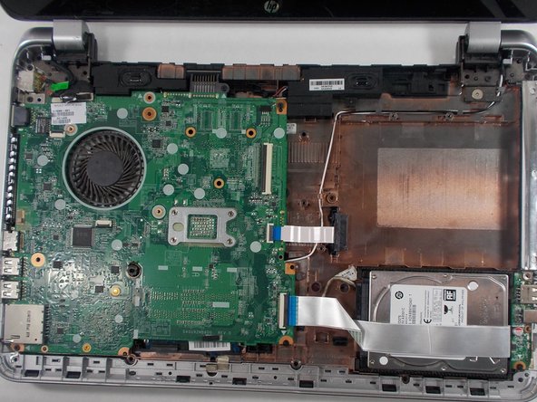

  14. HP Pavilion 15-n210dx Speaker Replacement: crwdns2935265:014crwdnd2935265:01crwdnd2935265:01crwdne2935265:0
    • Flip the black flap up to sperate the strap.

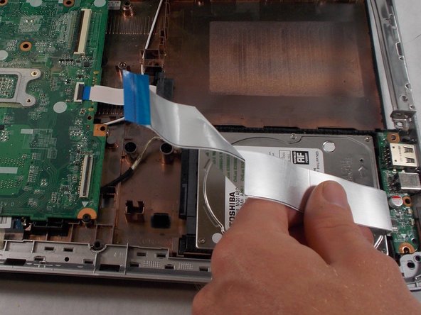

  15. HP Pavilion 15-n210dx Speaker Replacement: crwdns2935265:015crwdnd2935265:01crwdnd2935265:02crwdne2935265:0 HP Pavilion 15-n210dx Speaker Replacement: crwdns2935265:015crwdnd2935265:02crwdnd2935265:02crwdne2935265:0
    • Lift up the blue flaps with a finger and detach the sliver straps.
  16. HP Pavilion 15-n210dx Speaker Replacement: crwdns2935265:016crwdnd2935265:01crwdnd2935265:01crwdne2935265:0
    • Lift the motherboard up.
    • You might have to jiggle it around to loosen it before lifting it up and removing it from the base of the laptop.
  17. HP Pavilion 15-n210dx Speaker Replacement: crwdns2935265:017crwdnd2935265:01crwdnd2935265:01crwdne2935265:0
    • Pull the black plug-in to detach it from the bottom of the motherboard.
    • The motherboard should be completely detached from the computer.
